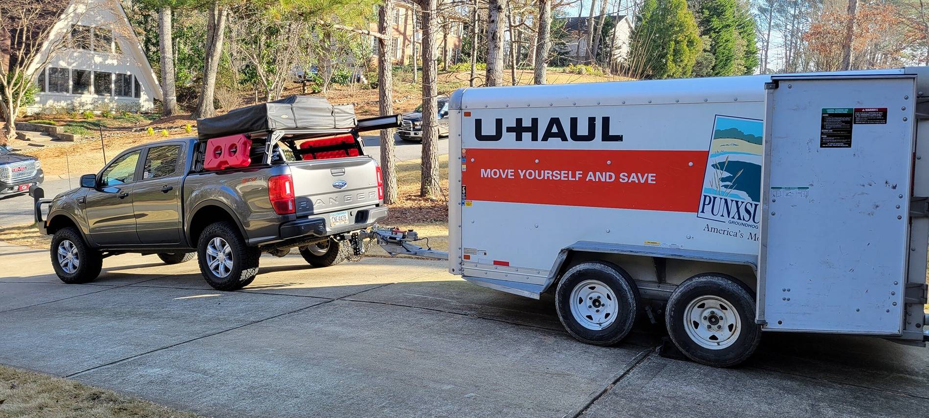

5" drop may not be enough. If you don't have the hitch yet, take a tape measure to the rental place and determine the height of the tongue when the trailer is level, then determine the drop you need. Should try to get the tongue level or slightly low when it's hooked up.
I have a 7" drop hitch and it's about right for my 5.5x9 trailer hauling a UTV.
