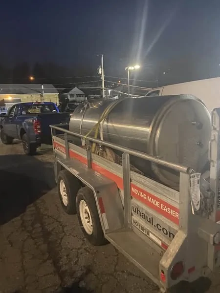

Weight will be fine. U-Haul trailers have surge brakes so you don't have to worry about hooking up electric brakes. I once rented their big open trailer to haul a fermenting tank from my bud's microbrewery across town, total weight was about 3600 lb, no issues. Turn on the Tow Mode button. Yes it's true, my best friend owns a brewery. ?

Good friend to have!
Probably beneficial that I can’t make that claim. :giggle:
Happy for you though! Dayum. Now that’s a friend! :handsinair:
