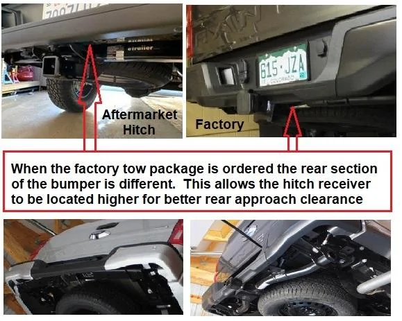

If the hitch you buy is rated at or in excess of 7,500 lbs no worries. Most aftermarket hitches hang down under the bumper and you don't need to change anything regarding the factory bumper.
However, the factory set-up moves the receiver up, that's why the bumper center section is different.. as was discussed previously.

Something I just noticed today and thought I would share. The rear bumper center section is different when your truck has the factory tow package.
It's modified to move the hitch receiver up higher, thus giving the truck a better rear approach angle.

Just the center piece of the bumper. Pretty slick the way Ford designed the bumper to make the center piece replaceable.
Check out the attachment below, and the screen grab for a visual.
