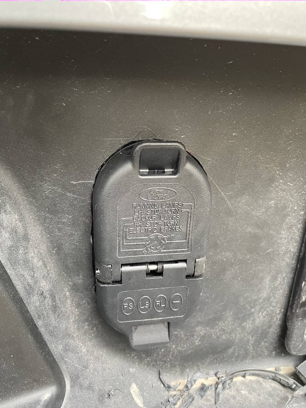

And, installed the stuff today.
Figured I'd put a note: I originally cut out the outline on the plastic bumper part. But the 7pin+4pin adapter wouldn't seat...the metal tabs don't click in and hold. Turns out I had to cut a hole in the bumper plastic that corresponds to an outline of the entire electric connector (oval shape). The connector needs to sit inside the plastic bumper part completely.
I didn't do a perfect job because all I had was a utility knife and I slipped a few times. Cutting the hole took a while! Replacing the harness was actually easier, just needed a set of skinny needle nose pliers to pull the old cable snap connectors out of the bumper and frame. The harness and the 7pin/4pin connector both helpfully came with some dielectric grease applied to the connectors already, which is a nice touch.
The new connector works great, although I only have 4 pin trailer lights to test with. I'll assume the 7 pin connector is all set to go. I'm surprised that the aftermarket etrailer harness doesn't just tie into the bumper connector, which would eliminate the need to run a separate hot line all the way up to the battery. Oh, well.

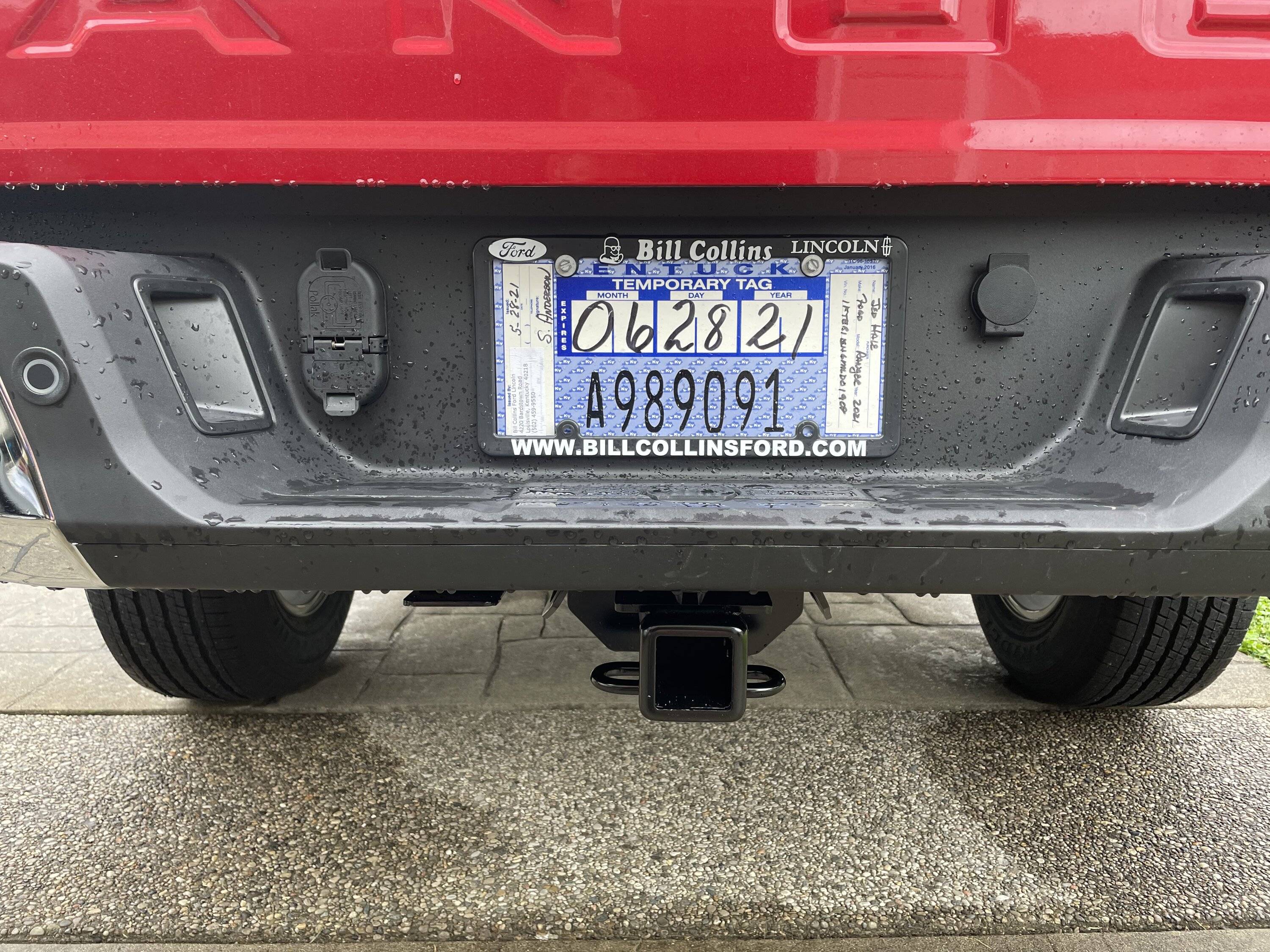

I just bent the clips on the connector out a bit and it seated no problem against the plastic. Old photo but taken the day I installed the socket.
That is what I did also to mount the connector.
