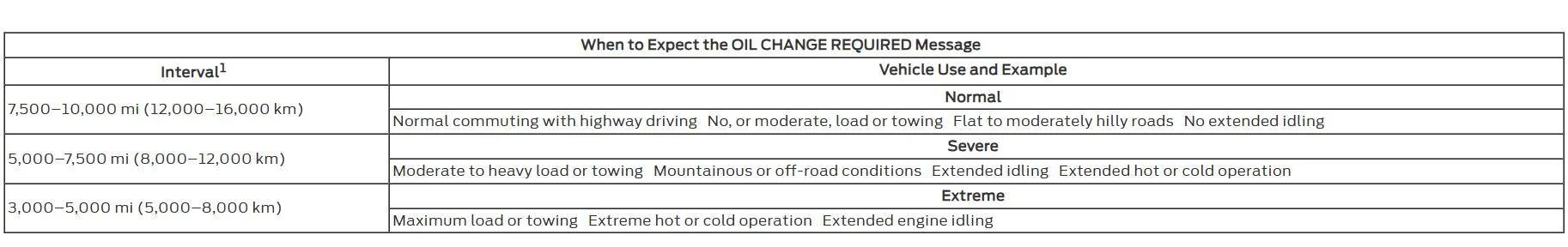

Directly from the owner's manual.
Oil Change Intervals (factoring in towing, elevation, etc.)

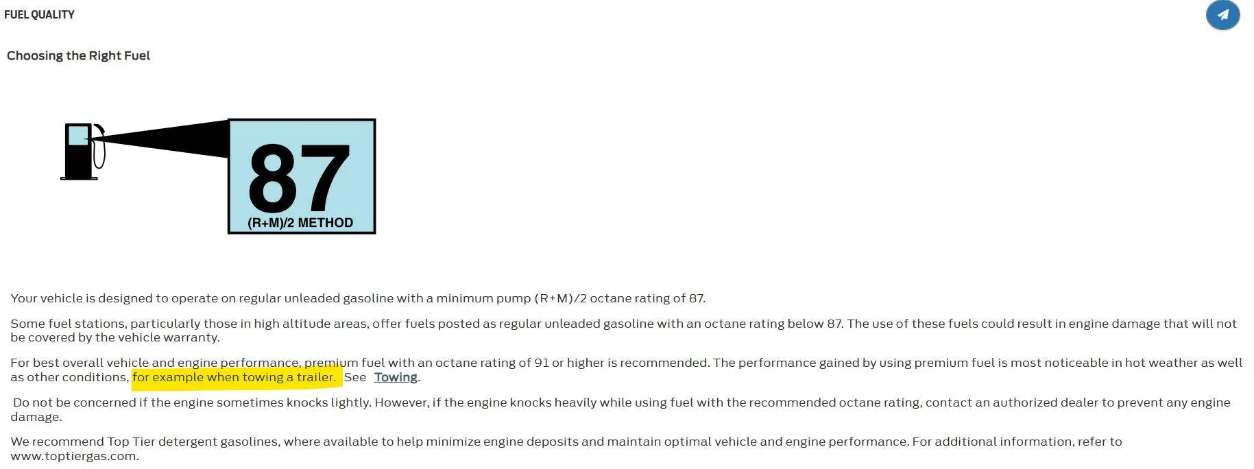

The Service manual also recommends 91 octane (or higher) while towing.

Okay, at least I know what to expect. Looks like we will be making a lot of fuel stops,300 miles if I'm lucky. Thank you for the info from the manual. I just went online an found the manual. :)
