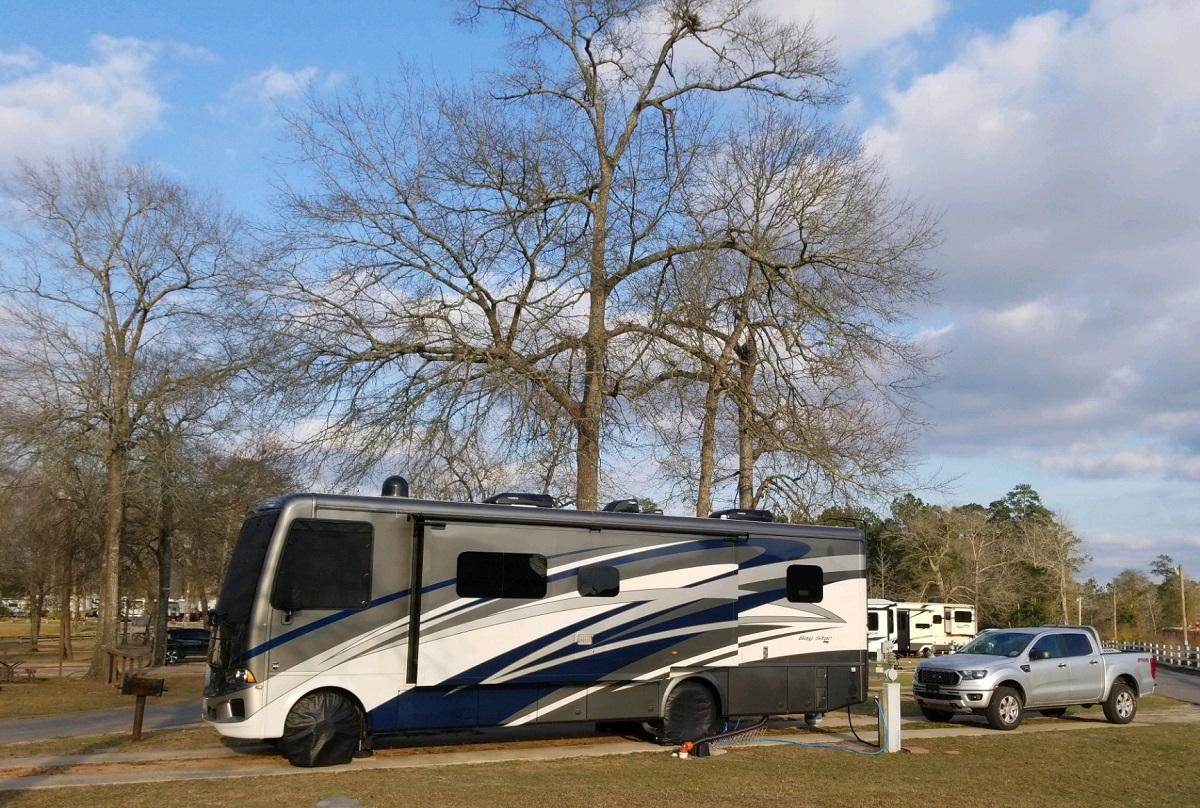

2020 Bay Star on a 2019 F53 chassis.
So it also has the 6 speed. I had been told that change helped quite a bit.
I think your is probably longer and heavier than ours.
Ours is 32’ built on the 20500lb chassis.

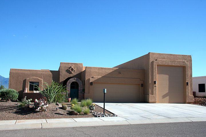

As for the RV....Margie and I built our house with an attached RV garage that is 60 ft long by 15 ft wide and is part of the garage for the Ranger and Nautilus. Makes our RV residential fridge part of our three fridge system.... also third Ice Maker too...
Pic attached.
You've got a stunning home, Phil. Every motorhome owner's dream. For us, we found a great indoor motorhome storage site. It's just 30 minutes away from our new home and they should care for it nicely. As for the home we're buying, it's a townhouse in a suburban setting with lots of amenities that we'll like. It has no outdoor maintenance or repair responsibilities, so it's true "lock and leave". That will let us spend Springs and Falls in the Dallas area and then escape easily to the coast in Winter or mountains in Summer.
