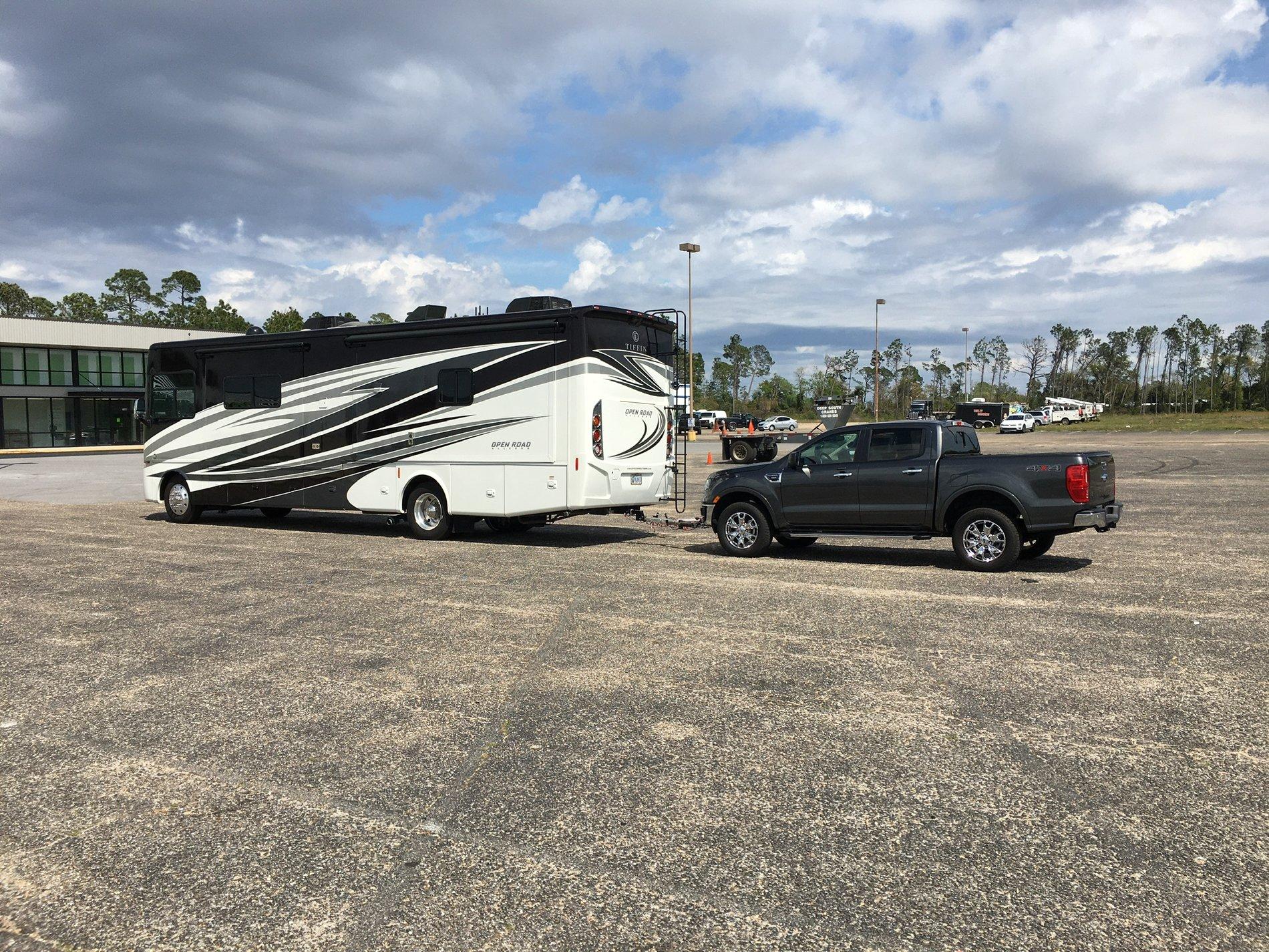

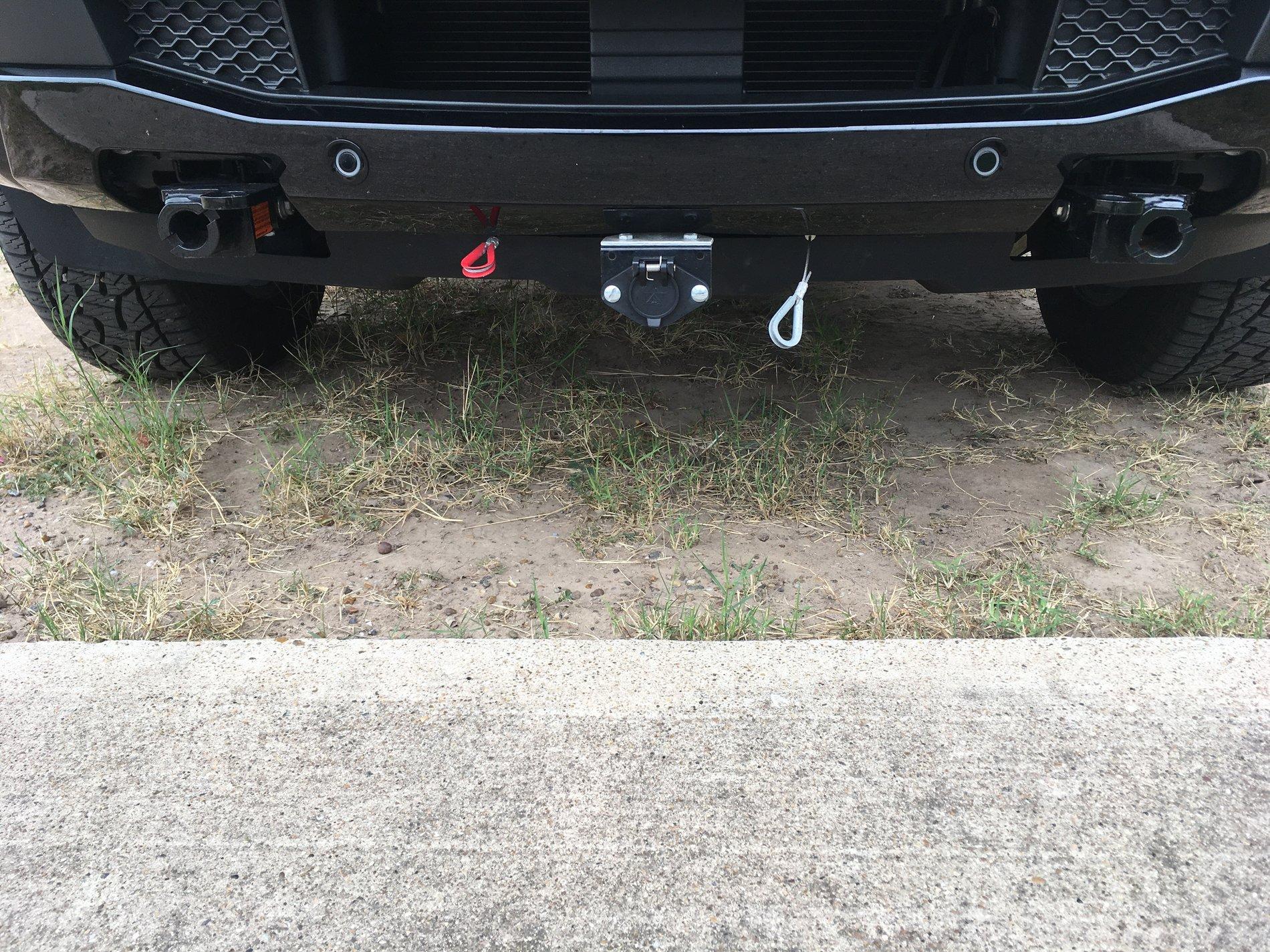

Here is my ReadyBrake with Blue Ox baseplate. Haven't towed it yet. A pro shop did the install.

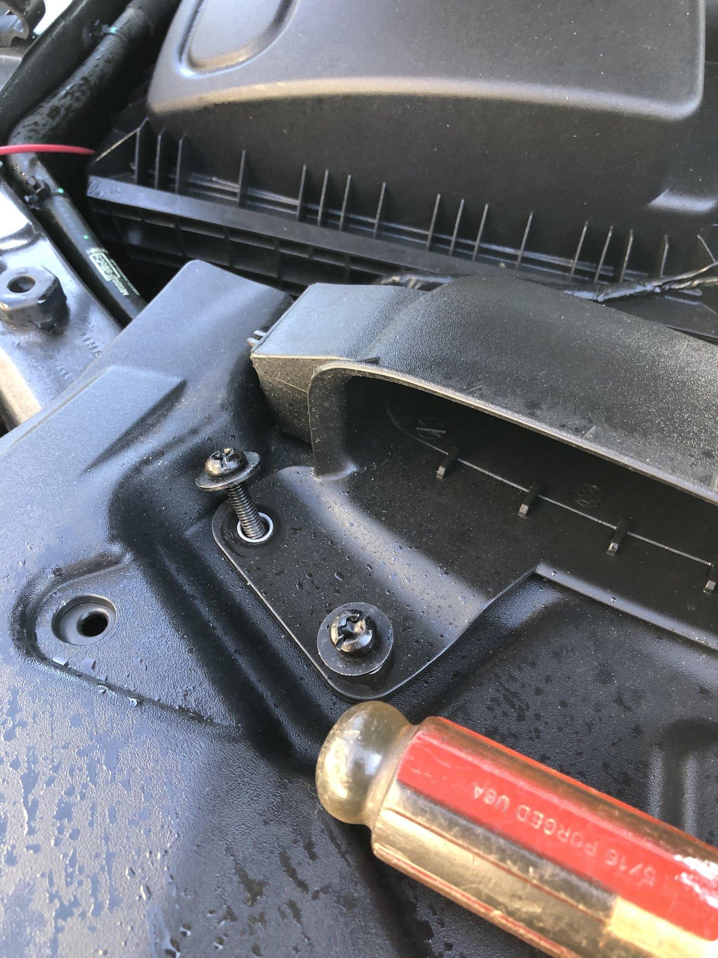

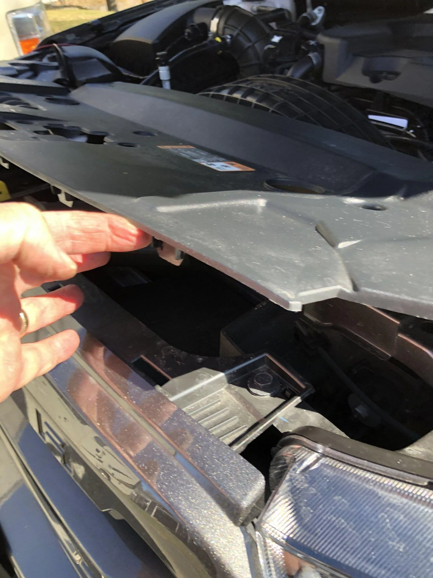

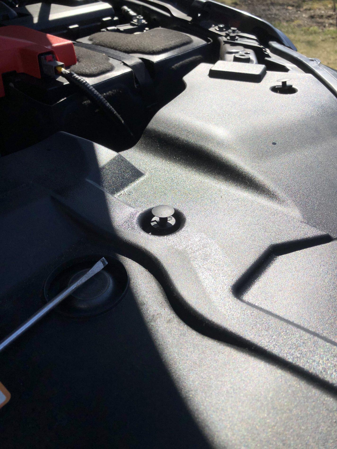

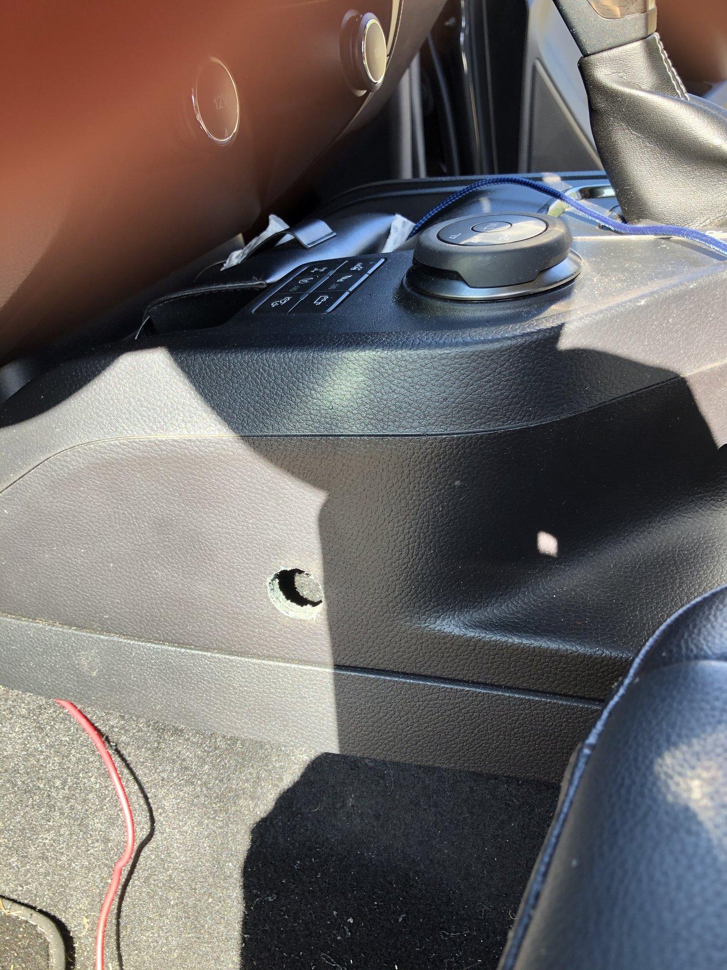

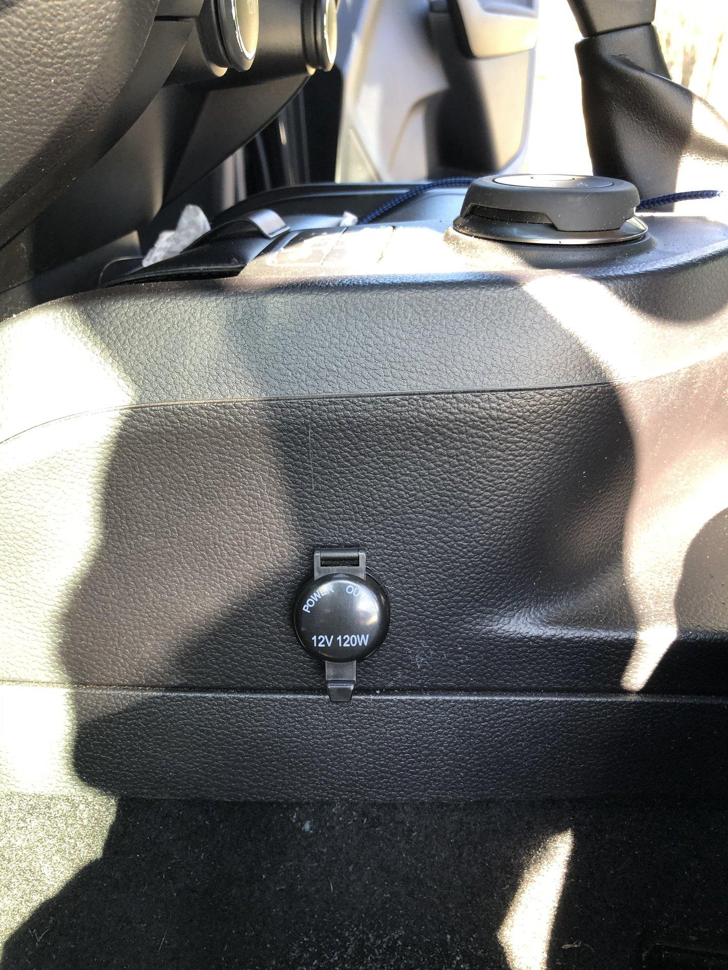

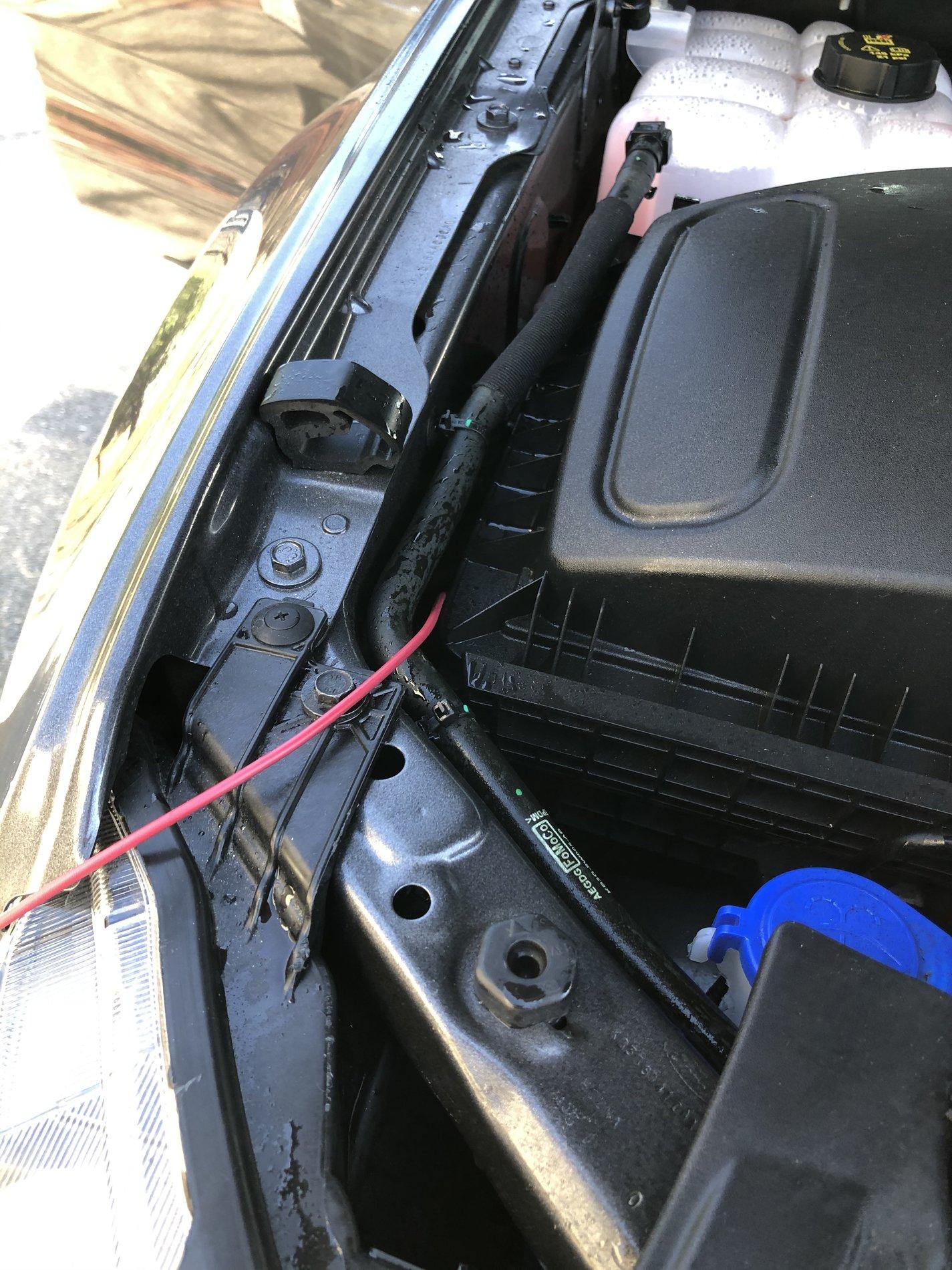

Hello Phil and all , I just finished my 12 volt power connection. After looking at all the threads, I decided to run a #14 gauge wire in from the passenger side and pass it under the console and drilled a 1 inch hole on side of console for 12 v power I’m using a 5 amp fuse at the battery as that is what Blue Ox suggested I use. I ran wire in front of Radiator and connected to battery. See the pictures included pretty easy job . next project will be BO base plates.

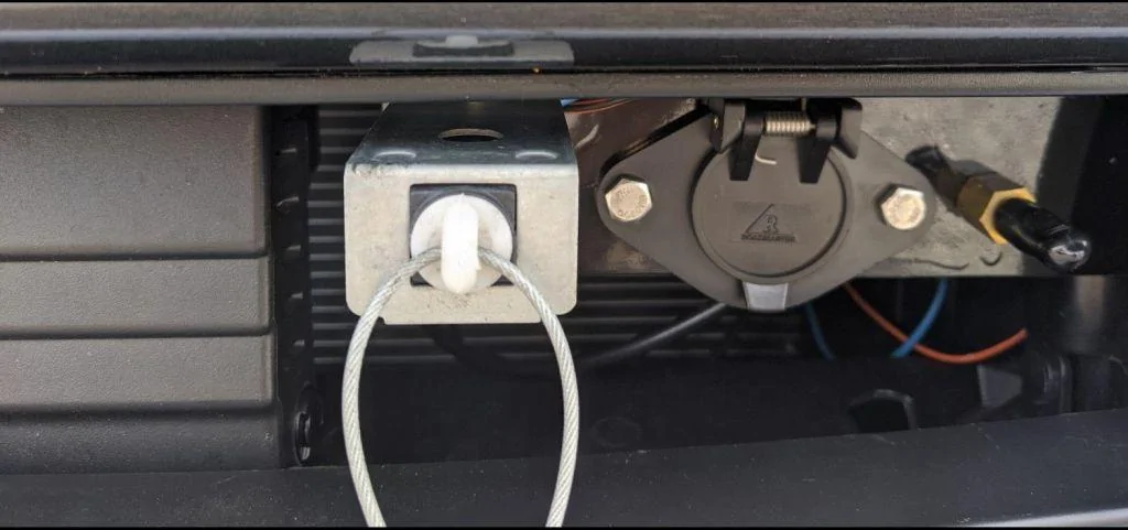

Finished installing the RVi towed battery charger so that completes my toad accessories.
Roadmaster base plate. Wireless lighting. Air Force One braking.
Good to go but no where to go. We were going to see family in Florida after two weeks in New Orleans but it looks like that may not happen. Have to see how everything goes with the virus.
Some pics of my install.

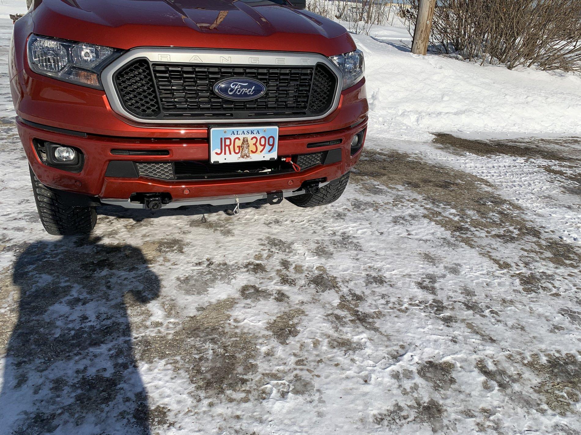

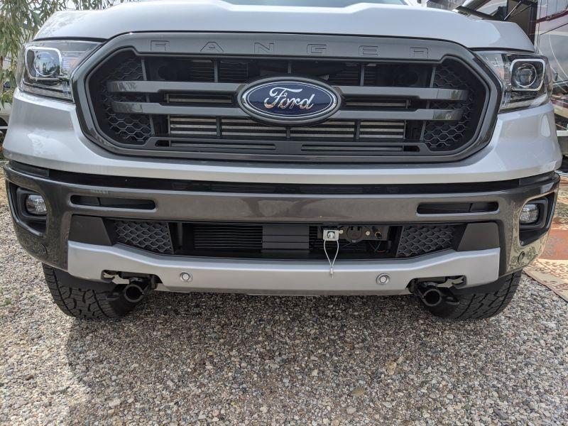

Installed blue ox base plates, ready brute brake cable and break away safety cable, diode wiring kit. Need to finish up with the wiring plug and LED light bar.
The OCD in me would relabel that from 120W to 60W. :)

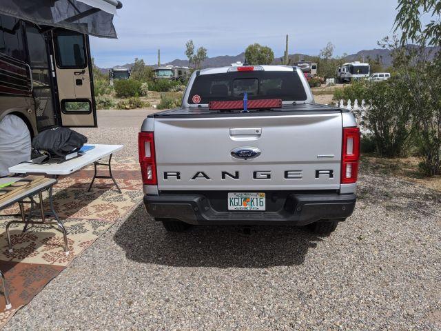

took my ranger for a test ride behind the motor home and all worked great !
blue ox base plate and ready brake . home made wiring like a trailer connection front to back and installed a set of new led 1157 style lights in the blank on the stock tail lights .
never felt like it was back there
