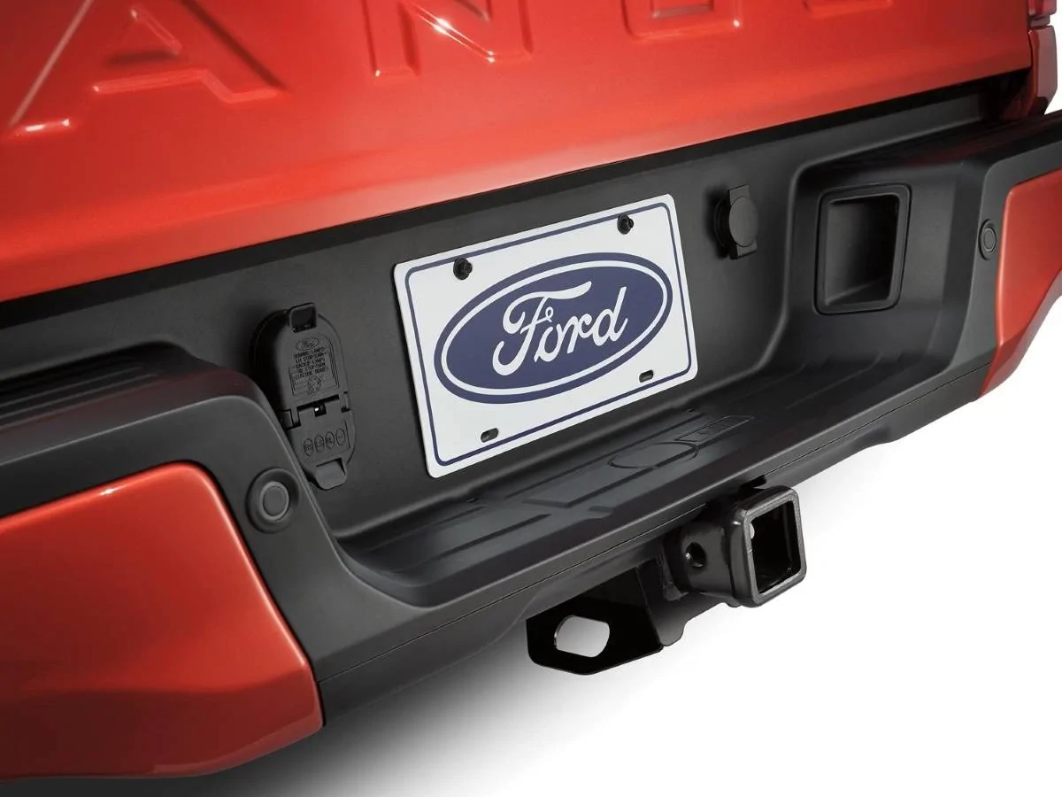

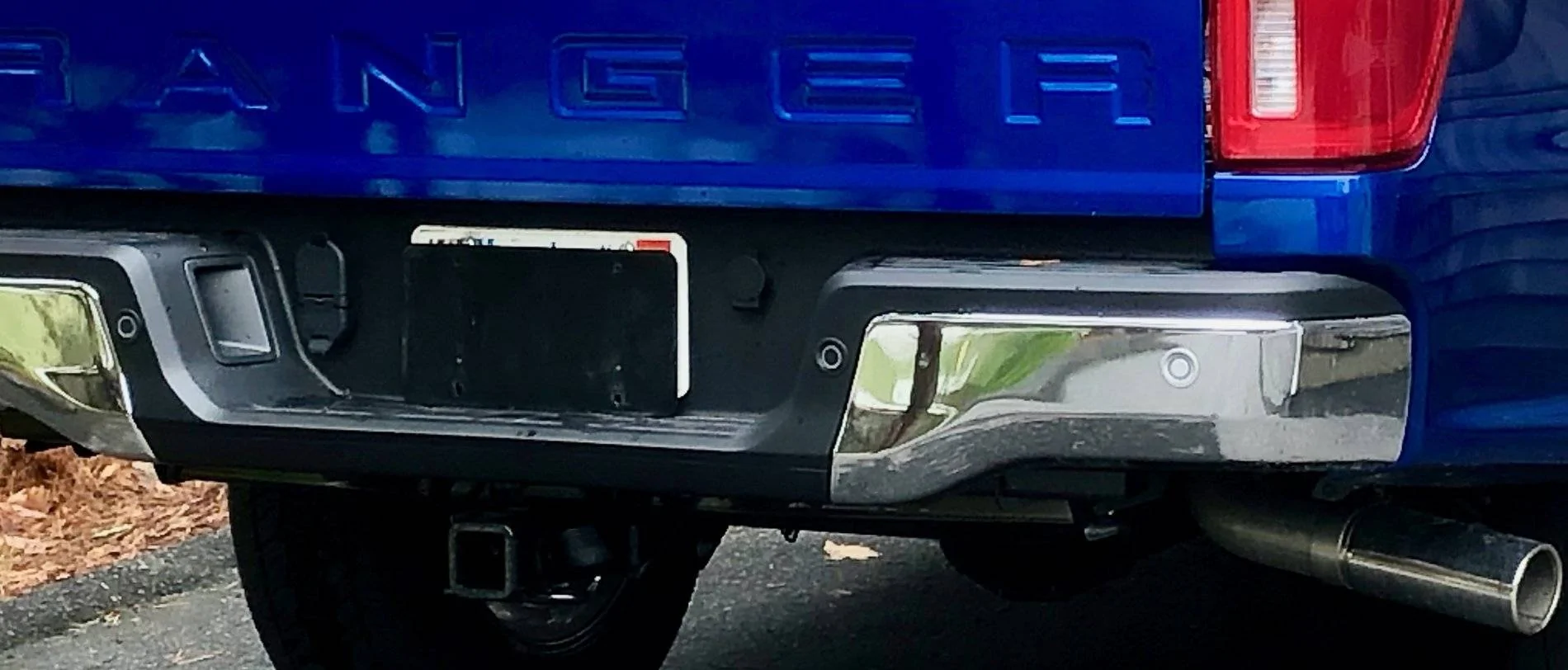

Hey ya’ll… first time truck driver here, been enjoying my rig for 4 months. I’m a rookie when it comes to towing and I bought my Ranger USED, so here is my question:
I have a hitch on my truck, but how do I know if I have a tow package or just a hitch?
Also, if I do have just a hitch with no package, how much can you tow? Small trailers with a 4wheeler or something?
Make fun of me, roast me a little… whatever, just tell me how I find out?
TIA
Even with the Tow package you will have to supply your own brake controller (wires are already there,. you just have to find and connect them). The Ford Tow package is a tidy setup. I would look into cost of a pro install of aftermarket hitch / harness. Uhaul will do it for about $300
If you go with an aftermarket hitch, a self-install only takes a few minutes and requires nothing more than a wrench and a couple clamps.
Also, IIRC UHaul uses Curt receivers, which are only rated to 6000 lbs. Draw-tite's offering for the Ranger gets you the full 7500 and is just as easy to install.
