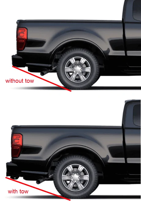

- Draftsman
Trying to understand this ... is this because of the added weight or because the hitch is closer to the ground? Or both?
I'm no expert, but I believe it is due to the tow package sticking out below/back of the bumper:

It takes away about 2 degrees. So yeah, not a big issue, well, for me anyway, and i would rather scrape the hitch than the bumper, provides a recovery point, and if its really that much of an issue. 2 c clamps and a 21mm socket help take of 4 bolts, remove the hitch, put the bolts back on so you dont lose the bumper

Your read my mind about how many degrees were lost with the towing hitch, thanks!
You can remove the hitch? I thought the factory tow package had the hitch welded onto the frame.
