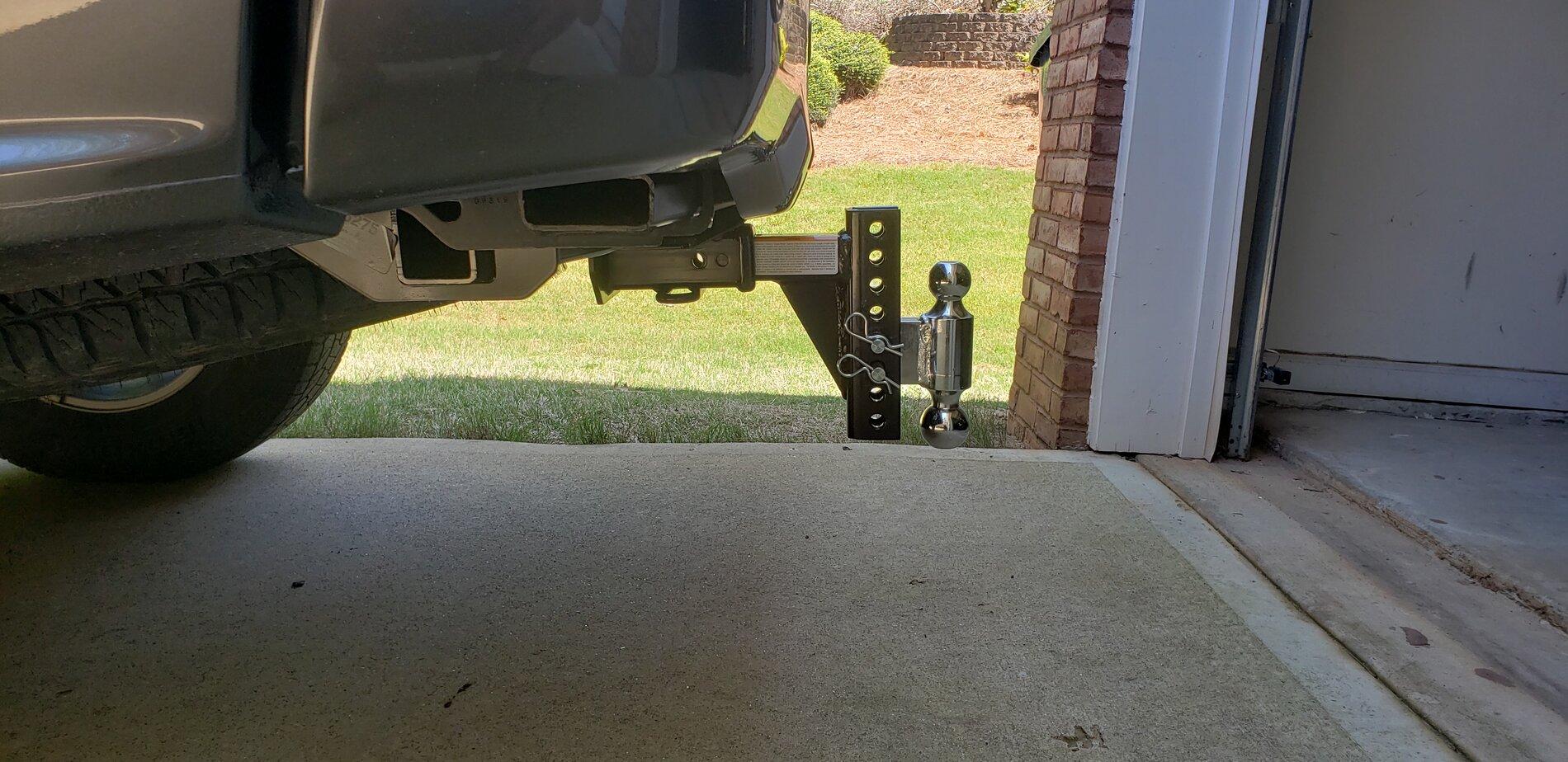

My FX4 did not have a tow package, but I added an aftermarket hitch that definitely sits a touch lower than the factory hitch that is a little more integrated into the rear of the truck. So I lost even more of that rear departure angle. I am lifted on the front, but currently stock in the rear other than Eibach shocks.
Going off road, I had absoultely no problems with the rear departure angle over some pretty good obstacles. I did drive off a shelf at one point and bottomed out either the hitch or spare tire on that ledge. But it was an easy little bump without any damage or anything.
I say get the tow package or an aftermarket tow setup and I think you'll be happy and encounter very little issue.

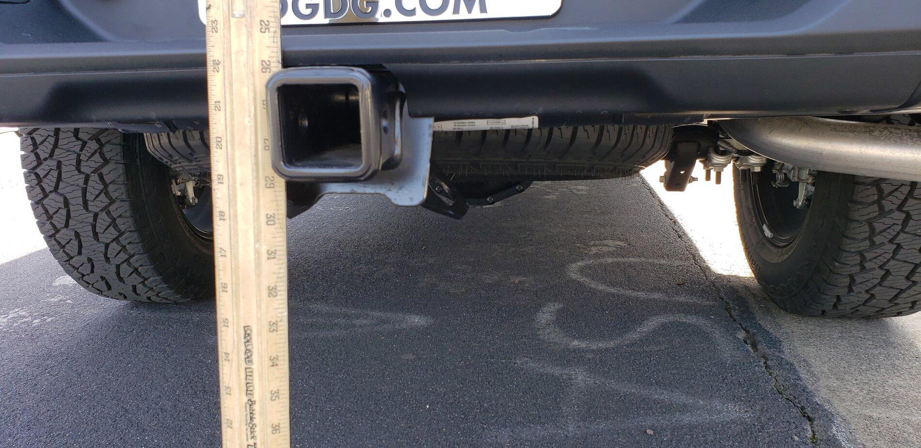

It takes away about 2 degrees. So yeah, not a big issue, well, for me anyway, and i would rather scrape the hitch than the bumper, provides a recovery point, and if its really that much of an issue. 2 c clamps and a 21mm socket help take of 4 bolts, remove the hitch, put the bolts back on so you dont lose the bumper
Not sure this is feasible with the factory hitch option. From info on a few other threads, I don't think you can pull the OEM hitch without also losing the rear bumper

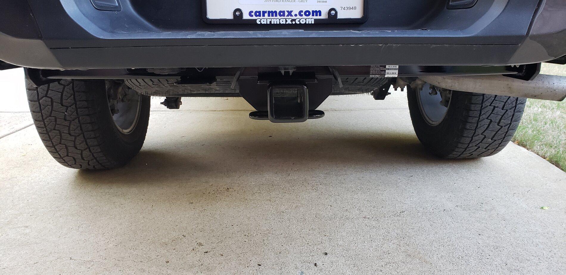

Here is a pic that might be helpful....this is on 265/70 R17
It looks like you would hit the muffler first before hitting the hitch receiver so based on this I think that it should have any effect on Ford's departure angle calculation since I bet they calculated the angle assuming you don't want to flatten your muffler.
