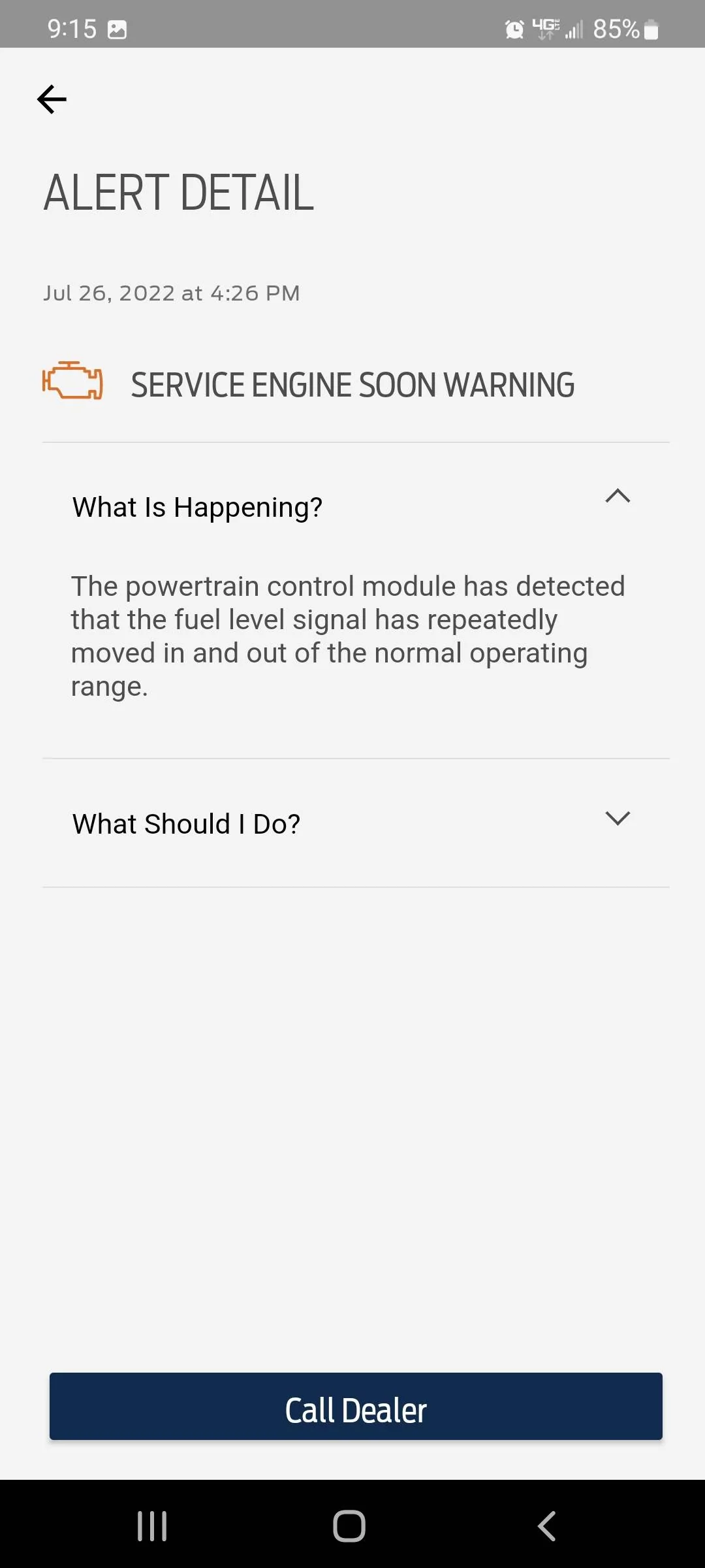

I guess I overfill the gas tank

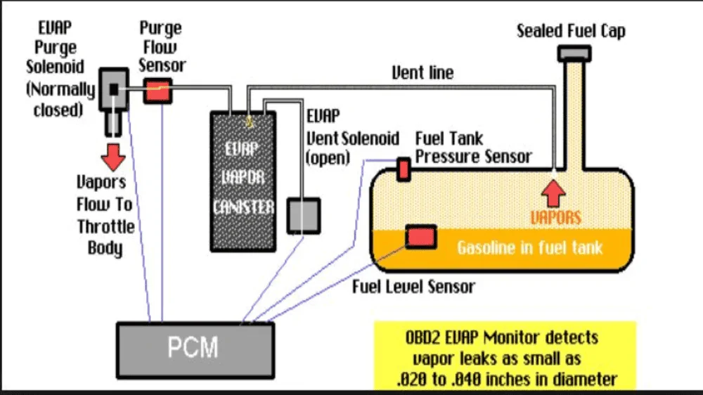

Basically capless tank over filling can cause the evap purge value to fail. Hard starts and Rough Idling after filling up.
These codes are from Mustang and F-150 Ecoboost: P1450 CEL and P144C CEL. Not sure what they are for Ranger.

The only thing I see is the idiot light on the dash. Dealer can look at it Aug 8th. Idles and runs just fine

Mine is doing the same thing. Every time I fill the tank, the engine light comes on and gives me the same message on FordPass. Let me know what they tell you at the stealership.
I took mine in to have them check it and the light went off before I got there. They said they didn't see the problem. So, I'll fill the tank just before I go next time.
Same here. The light went off. Still going to my appointment. I'll let you know what they say
