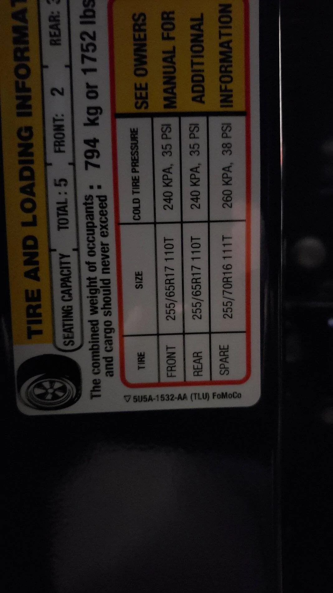

Well this is what my sticker says
2020 xlt 4x2
I still have everything stock.
Sorry the photo is so dark. Went to the garage to take pic right now
Interesting that your SuperCrew has the same size tires as my Supercab but yours specs 35 psi and mine specs 30 psi.

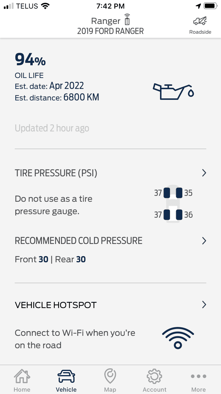

Do not use a tire guage? Never seen that before.
SymChris
Apr 25, 2020
253
470
Mississauga, ON, Canada
2019 Ranger Lariat FX4 / 2017 Escape SE FWD
I haven’t used (or seen) my tire gauge in over 15 years :)
Visual checks, and doing tire change-overs (all-season to snows) every 6 months has worked for me. While I’m guessing the sensors may be off a psi or two, they seem to be close enough for routine monitoring while driving.
