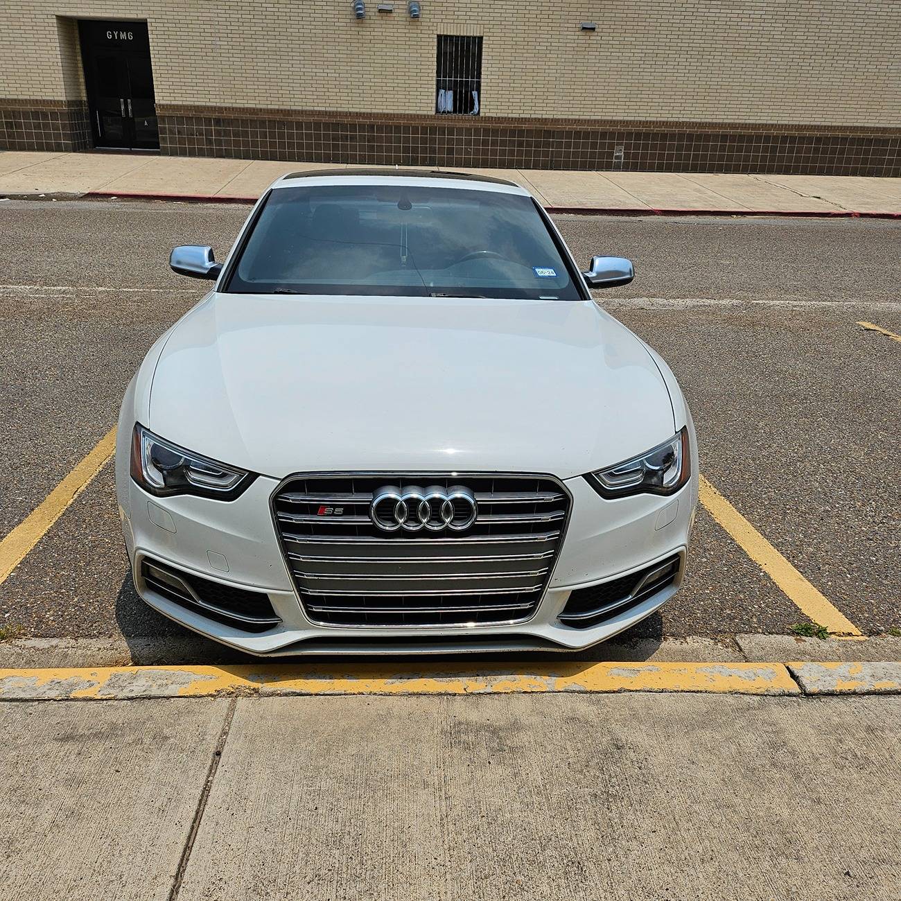

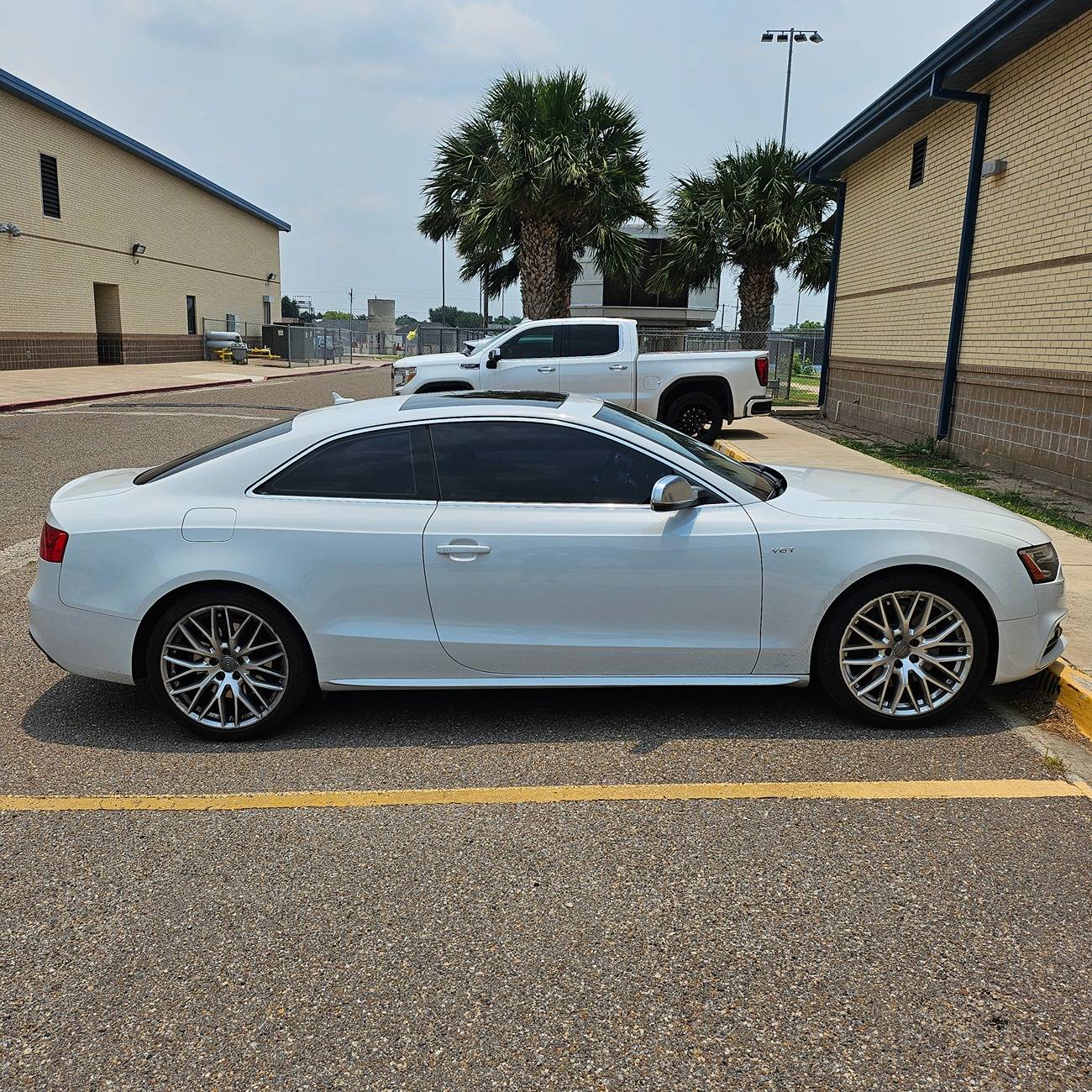

Tru... I can get to 90 mph in a hurry but it drives like a truck. I prefer the Audi for long distance high speed runs. I'm content to limit my Ranger to 70-75 mph. It drinks too much to go fast all the time.
