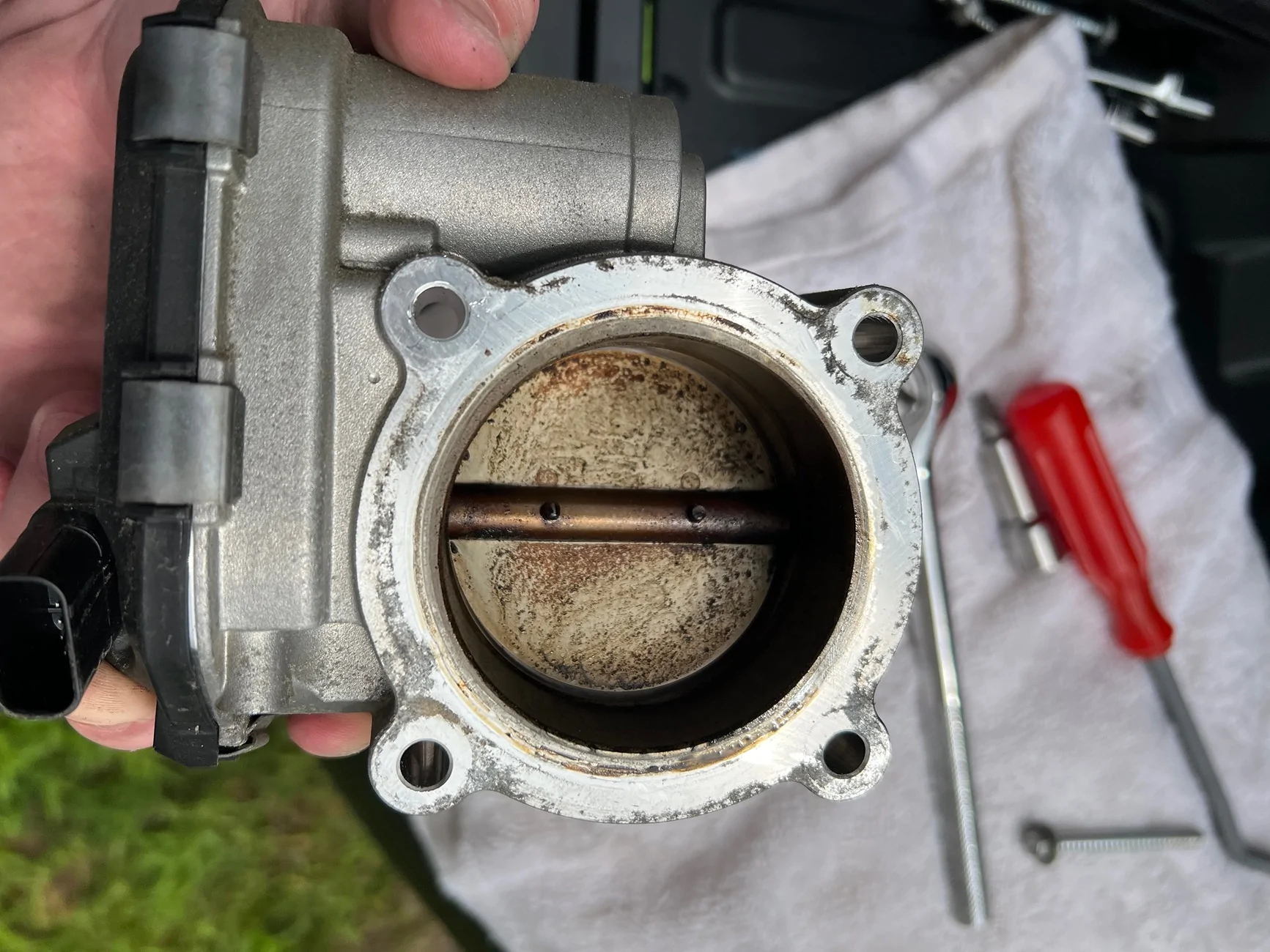

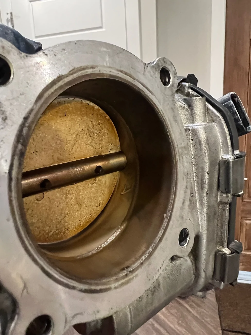

looks like some oil in the TB pics do you have a catch can?
Agree with you and I noted that around the gasket as well. I also noted it while cleaning the MAP a couple of days ago. Catch can is definitely on the list now

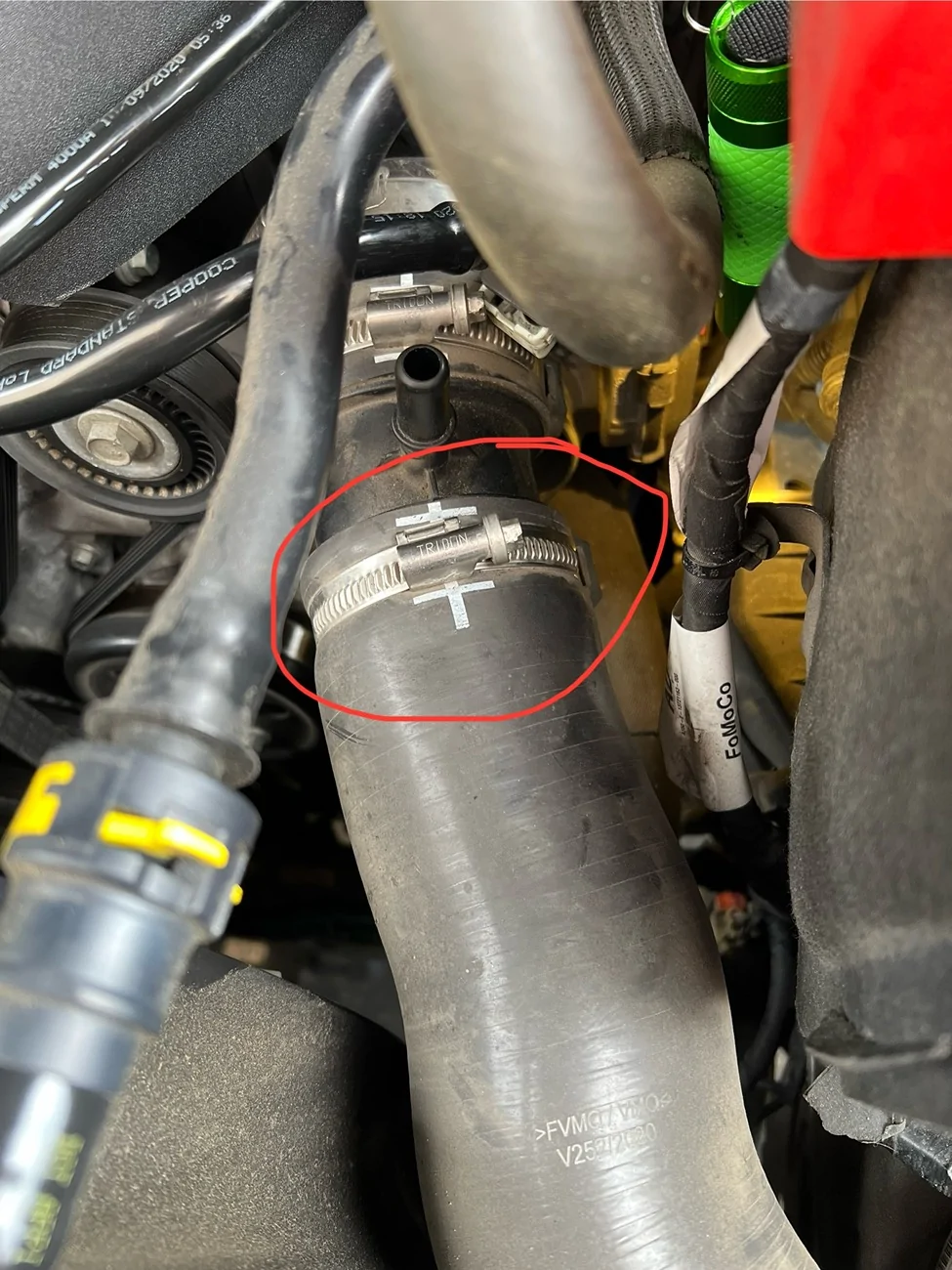

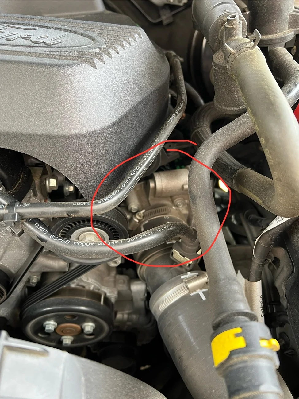

Yes that's exactly right—no need to remove the intercooler hose at all, just loosen the clamp and pull it away from the body, then it's free to nudge upwards and downwards depending on which 8mm bolts you are trying to remove.
Yes that clip felt like a beast until I finally spotted the secondary tab. It is very tiny. Would definitely recommend a headlamp while working in this area of the engine bay in general.

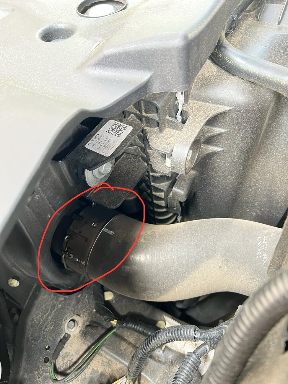

Man I’m trying to get to the bottom of the throttle body and there’s like no room to work in here with a ratchet. Should I remove the part of the intercooler circled in red for more room?
I just want to get the hose out of the way so i have room to work
Agreed, there's no room for a ratchet if you simply loosen the clamp for the intercooler hose and nudge it up or down, that's why I had to use a screwdriver with 8mm attachment. It was honestly pretty easy doing it that way. If you really want to use a ratchet and get the hose out of the way, I would more aggressively bend the hose out of the way rather than loosen it from that connector as you suggest

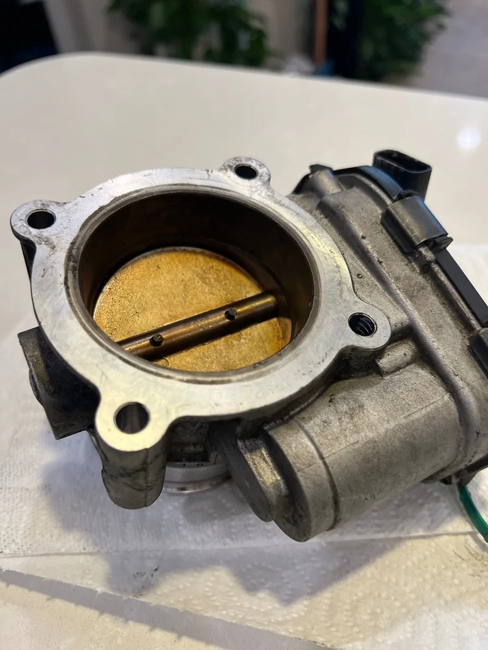

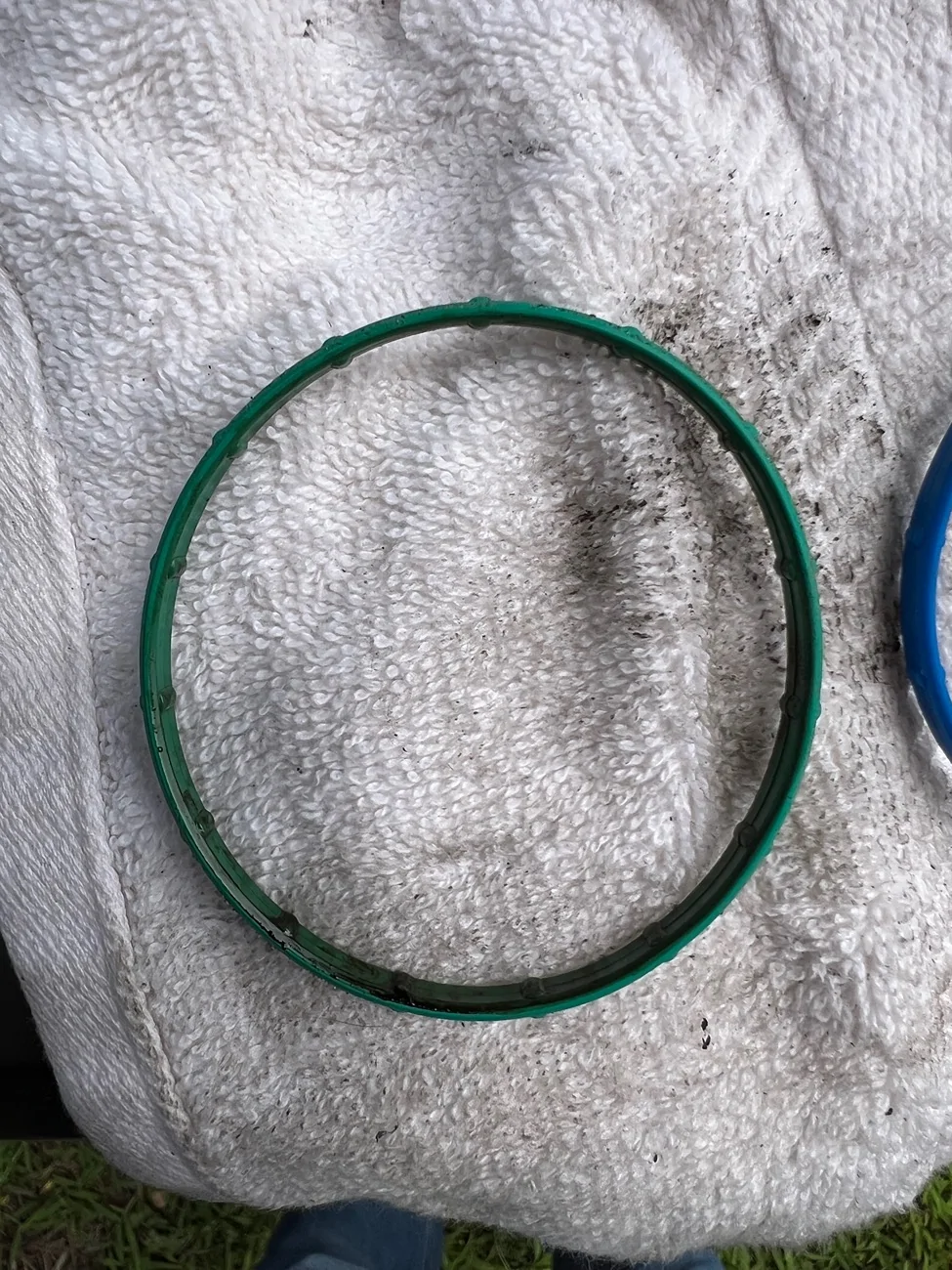

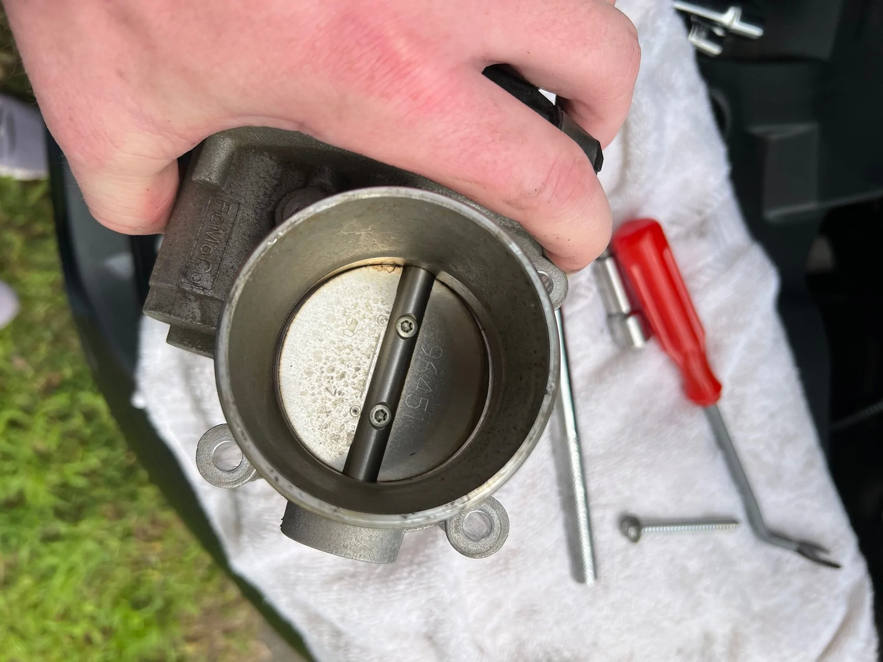

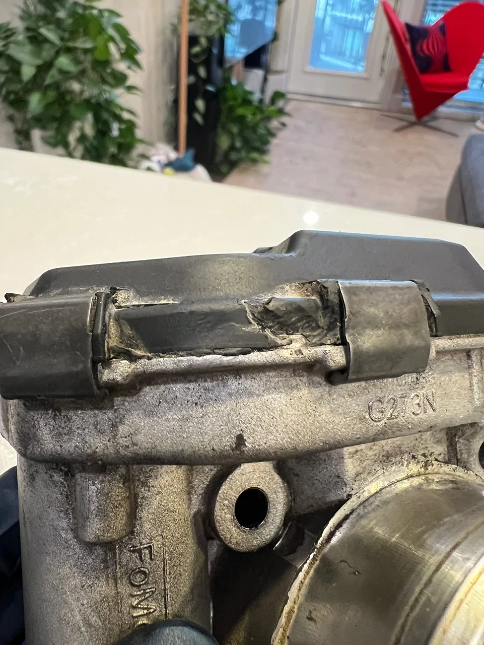

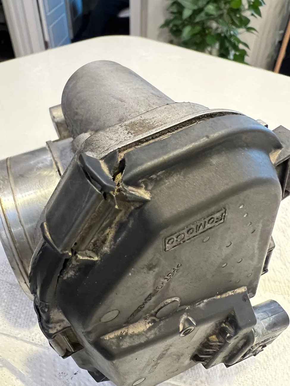

Ok I finally finished that was a PITA lol. Mainly due to such little room to work, i got some fun little scratches all over my arm from the zip ties connected to some of the hoses. But I did end up removing the whole intercooler pipe because it opened up so much room. Only tricky thing is i couldn’t fit my torque wrench so i just tightened stuff down pretty good but idk if the bolts are “torqued to spec”.
I have it turned on and idling for the next 10 mins for it to relearn then i’ll take it on a drive.
Here is my TB and old gasket:

Other than making yourself feel better what did it accomplish?
I did this mostly out of curiosity given that my truck is over 100k miles and ive never cleaned a throttle body before. I want to learn how to work on my own cars so I figure this is a good opportunity to learn something new and maybe improve shifting and mpgs. It was quite dirty as you can tell and draining the pcm in the battery from what I gather is helpful just like every once in a while its a good idea to power cycle your computer or phone.
Just curious.
Well done -- yeah it's a tight space for sure.
And you mean to tell me you didn't just go through that whole process just for clicks and views and pats on the back? Folks can be unnecessarily rude sometimes

Here's my digital high-five for getting your hands dirty and learning hands-on. With every job - more confidence!
Thanks man, I'm not very mechanically inclined so its been quite the learning process so far but its nice to have you guys on the forum for advice or I wouldn't have done half of these things so far!
