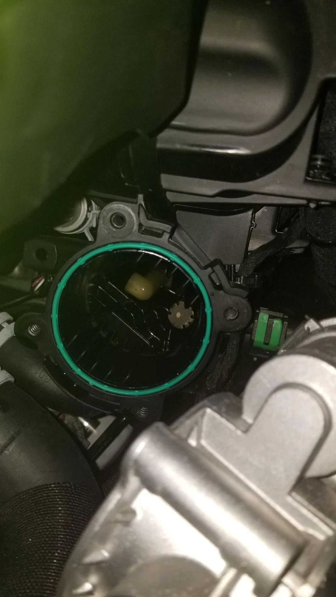

So, in my investigation of the throttle body and intake this is what I found. I already knew it's the same TB as the one on my 2.7 Fusion. The stock TB is maybe 58-59 mm. Both intakes are 64.45 mm. But the 2.3 is a nightmare inside.
Regard throttle body boring, can you explain what you mean by the 2.3 being a nightmare inside?
Also, can you please tell me how this can improve throttle response and increase gas mileage?
Is the throttle body that much of a restriction on this turbo motor?

The inside of the intake has all kinds of vanes and fins. Not just a nice smooth inside. That's the nightmare.
Thank you Ray, now I understand what I was looking at in your photo.
