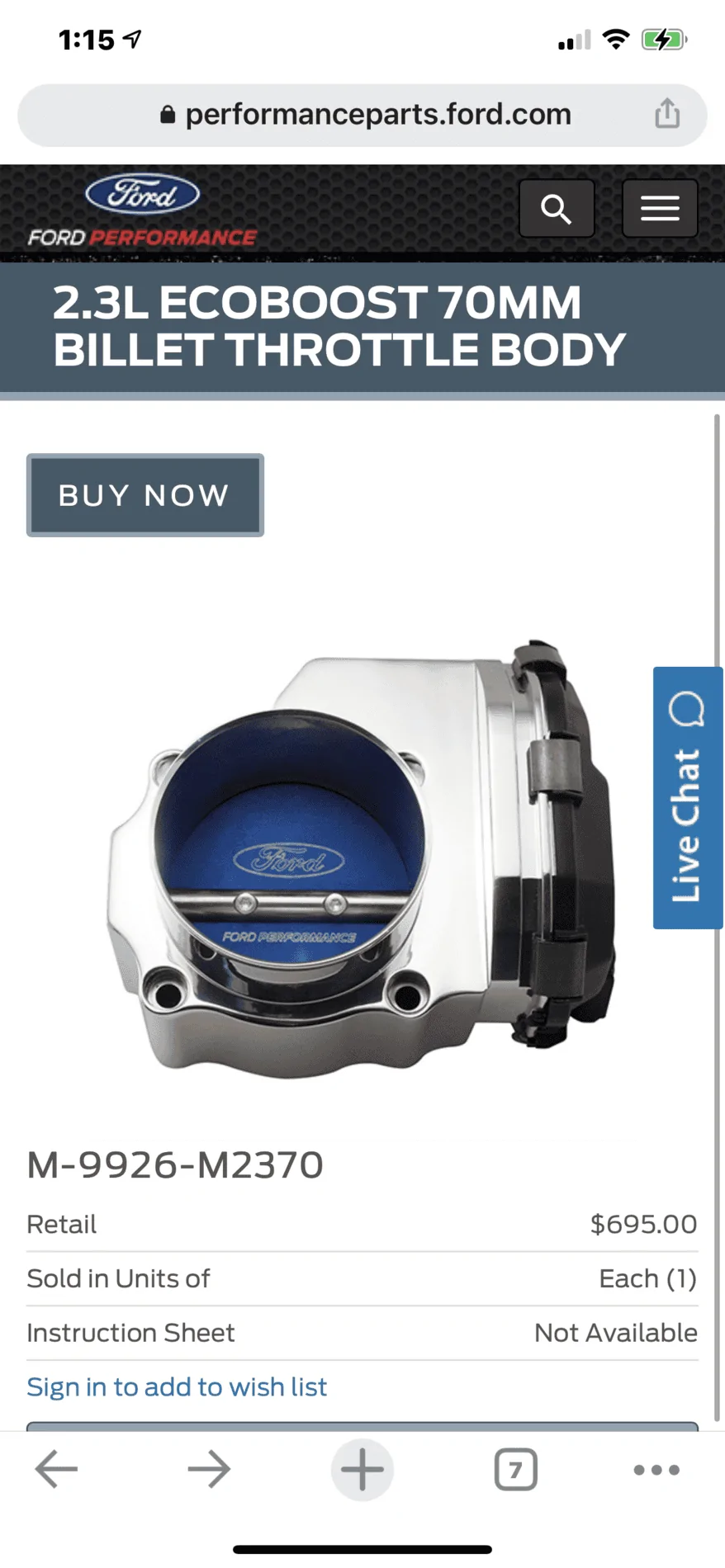

Hey guys would this throttle body for a mustang 2.3 fit on a Ford ranger? Bbk has 65mm that fits a ranger but I’d rather go with Ford performance. Any thoughts?

As interesting as it is the real question is does the encoder in the motor/sensor correlate the same for the Ranger? If it doesnt then there could be a problem. If it does then it could be a nice benefit.

As I mentioned in your FB post anything bigger than 65 mm will create a lip for the air to slam into. No need for bigger than that. If you look at my build thread you can see I measured and what I did.

I’ll have my intake mani off next week and see if there anyways to go bigger.

It's plastic and no room to open it any unless you want to deal with a sucked in o ring gasket.

There’s always room for customization.
