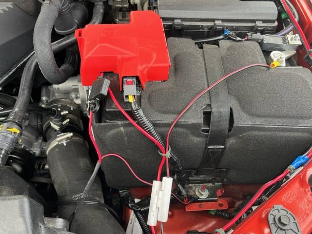

I finally got around to picking up a charger based on recommendations here. I want to hardwire the ring terminals and not use the clips. What solutions are some of you using for an external QD port?
They come with regular SAE connectors, but I am going to buy a flush mount pass through version. Trying to think of best spot to put it.
Somewhere on the bumper? Maybe one of the side fender vents? (I always back into my garage so it would be on that side where my plug in is). Something else?
another variation of a Boomer install
RED to B+ and BLK to GND
and yes I checked that GND connection with a milliohm meter and it passes MIL 1310 grounding requirements
other leads are for VHF HAM radio

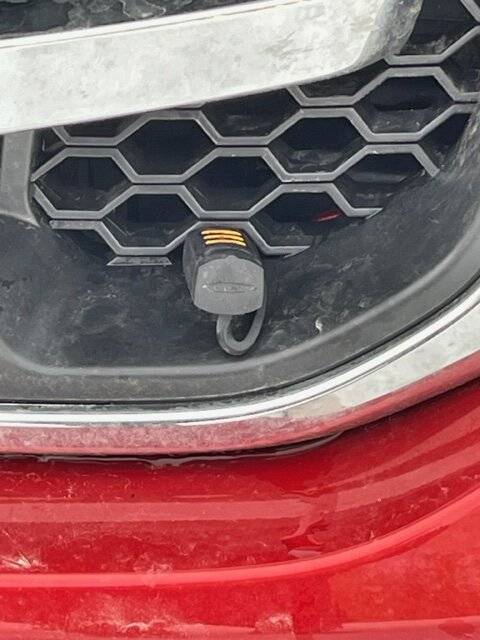

I always just let it stick out a little by the cowl
Find somewhere where the wipers wont hit it but relatively protected from elements
Just enough sticking out to plug in
Did this on my wife’s Bronco Sport
