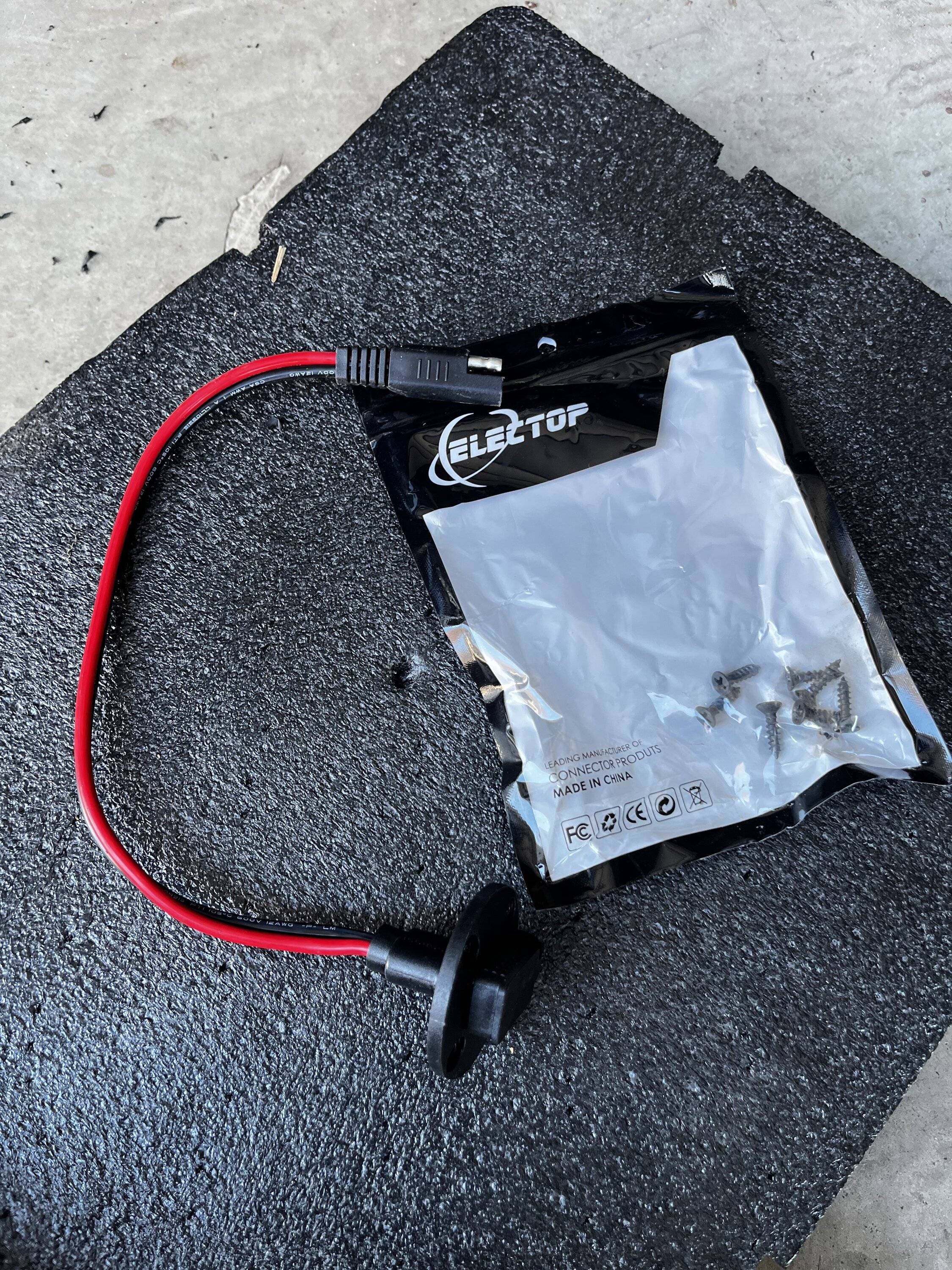

I finally got around to picking up a charger based on recommendations here. I want to hardwire the ring terminals and not use the clips. What solutions are some of you using for an external QD port?
They come with regular SAE connectors, but I am going to buy a flush mount pass through version. Trying to think of best spot to put it.
Somewhere on the bumper? Maybe one of the side fender vents? (I always back into my garage so it would be on that side where my plug in is). Something else?

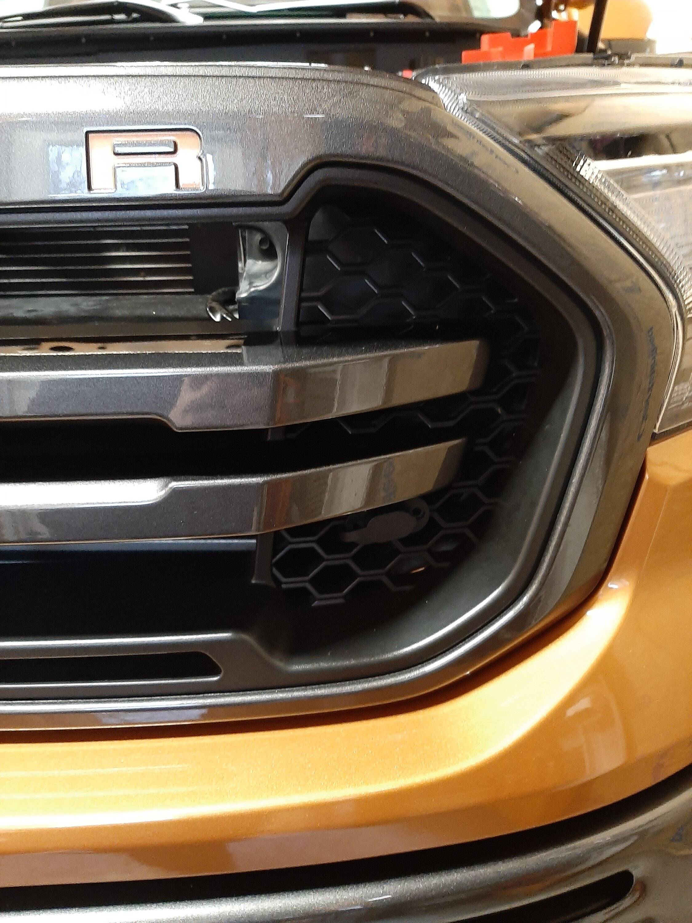

Here's where I mounted the pigtail on mine. It is just pressure fit in one the holes of the honey comb of the grill. I have the tender hung on a hook on the wall next to the truck.

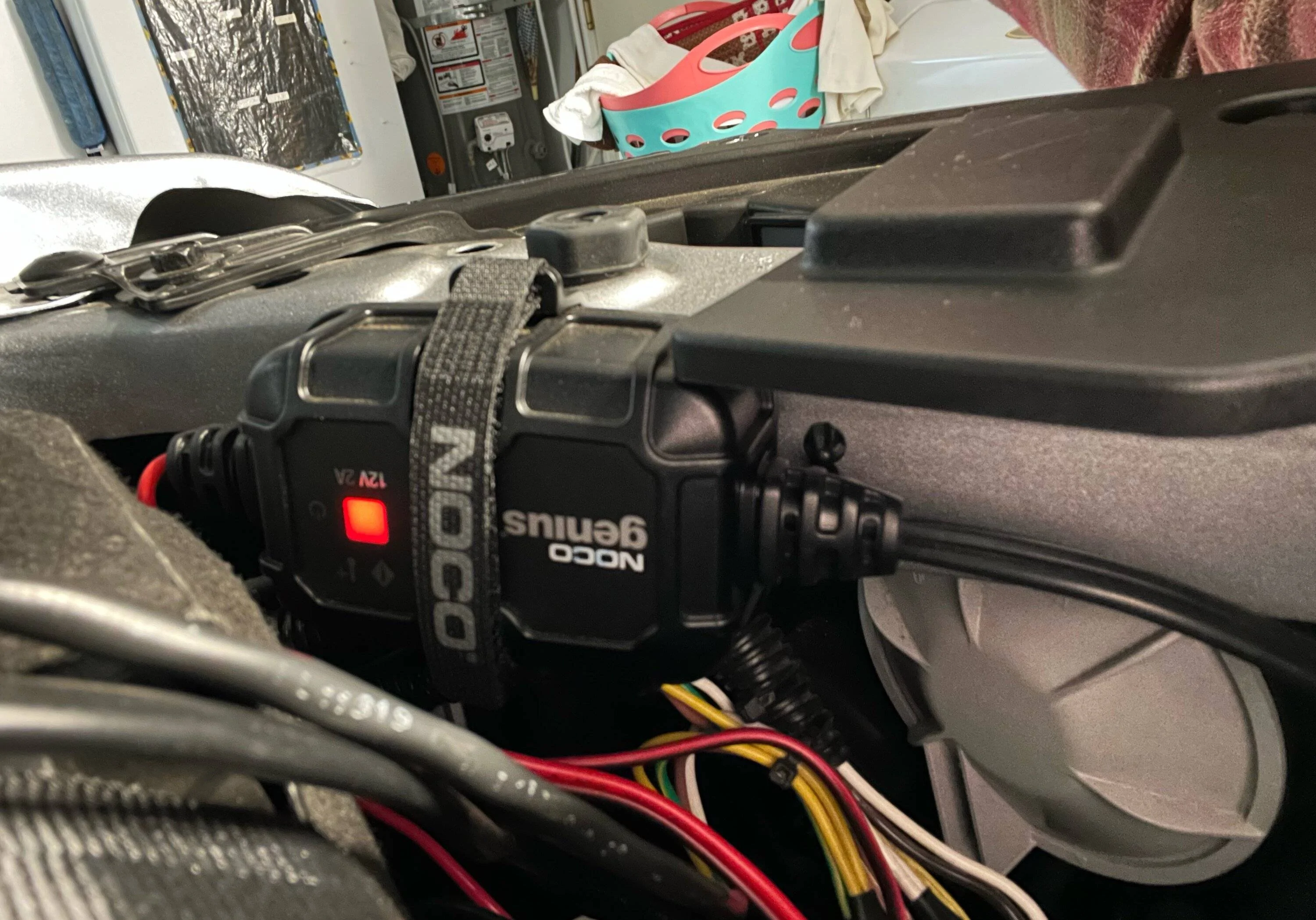

I installed a NOCO 2A charger in the engine compartment with the plug in the grill, don't want just a 12v line where I need to have the charger with me, only need power. I even plug it in to my RV when camped long term. Connected to +12 and the top of the -12 at the BMS so it sees the charge.

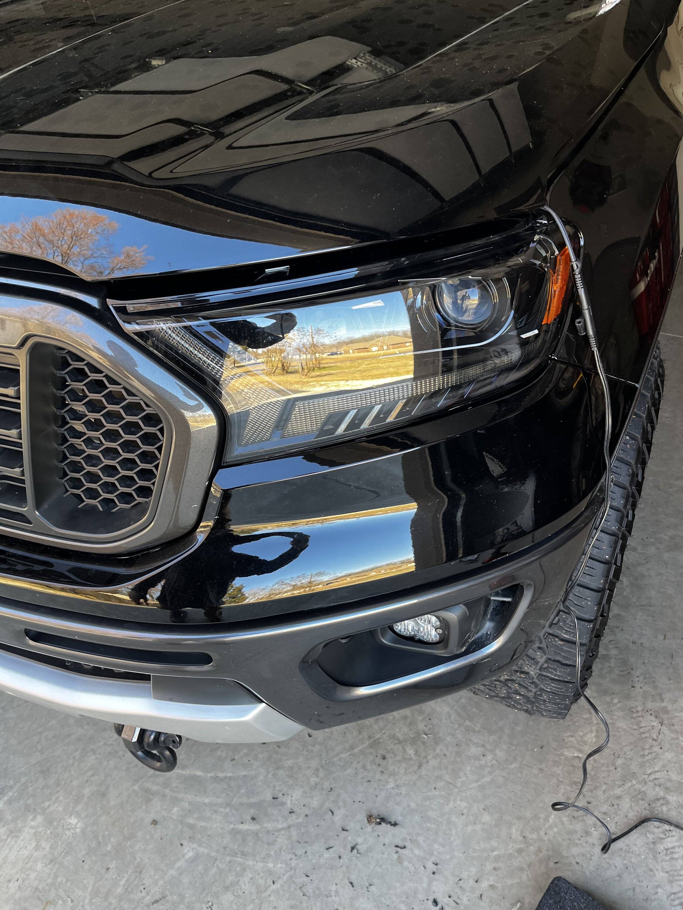

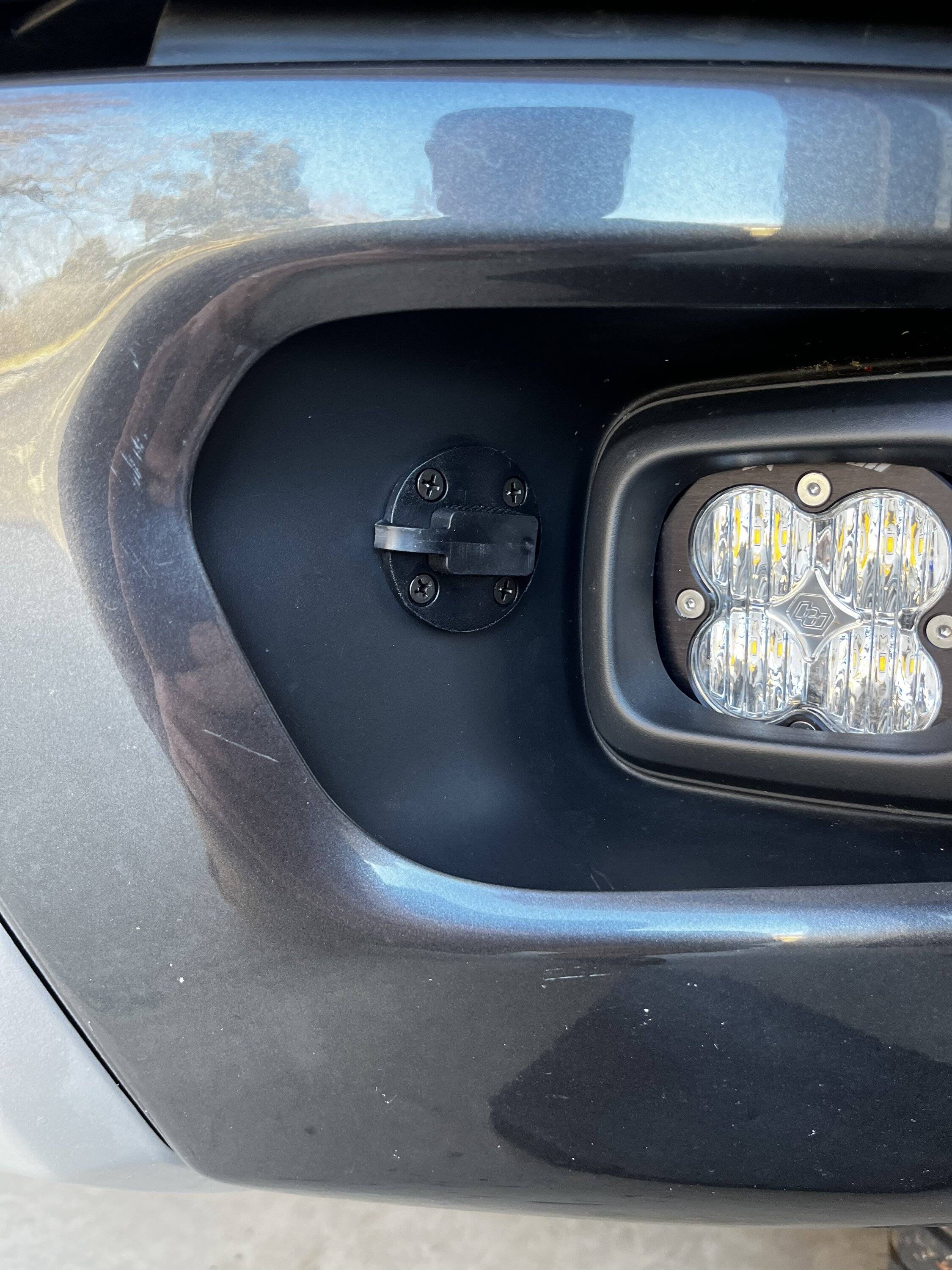

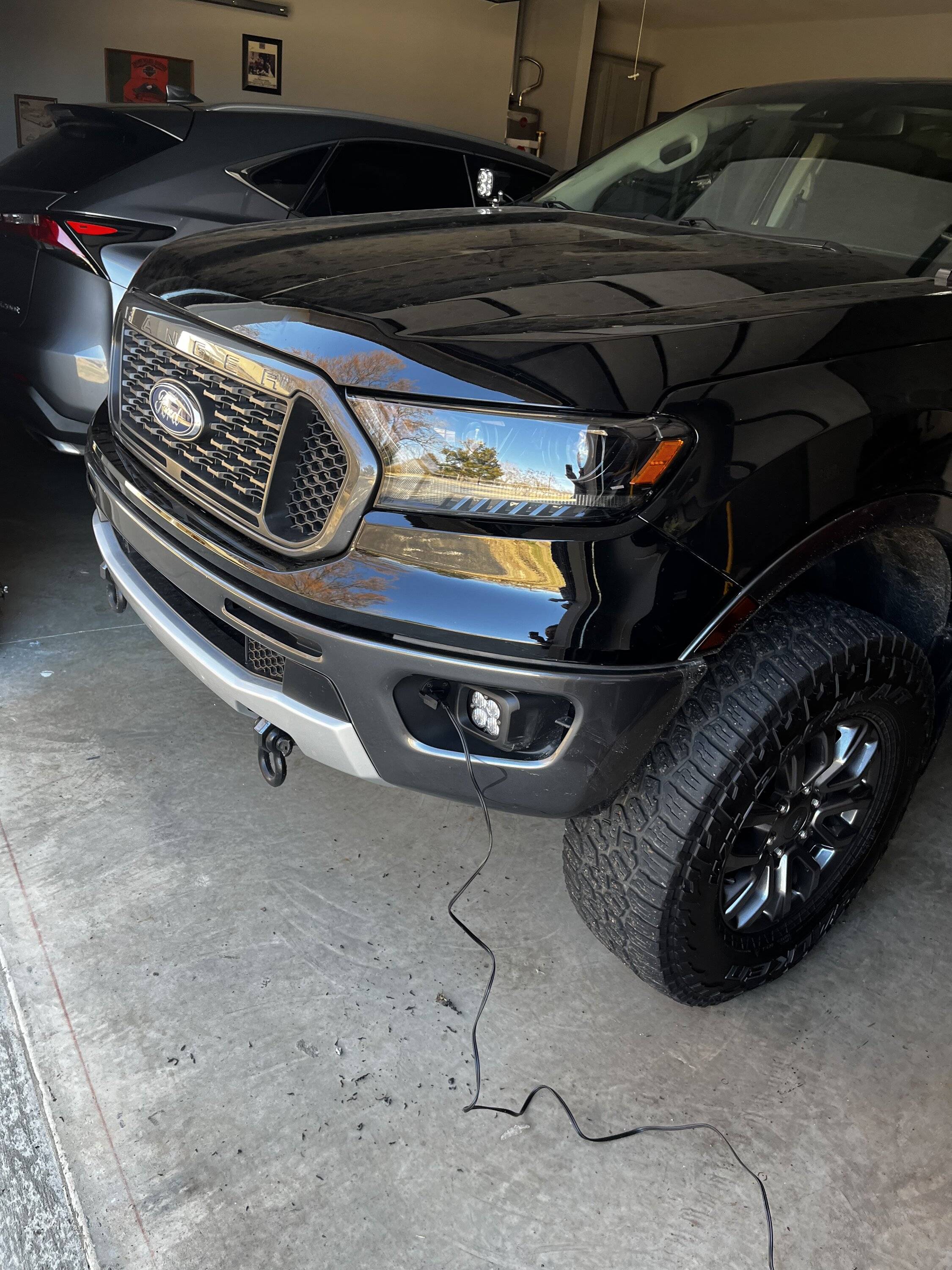

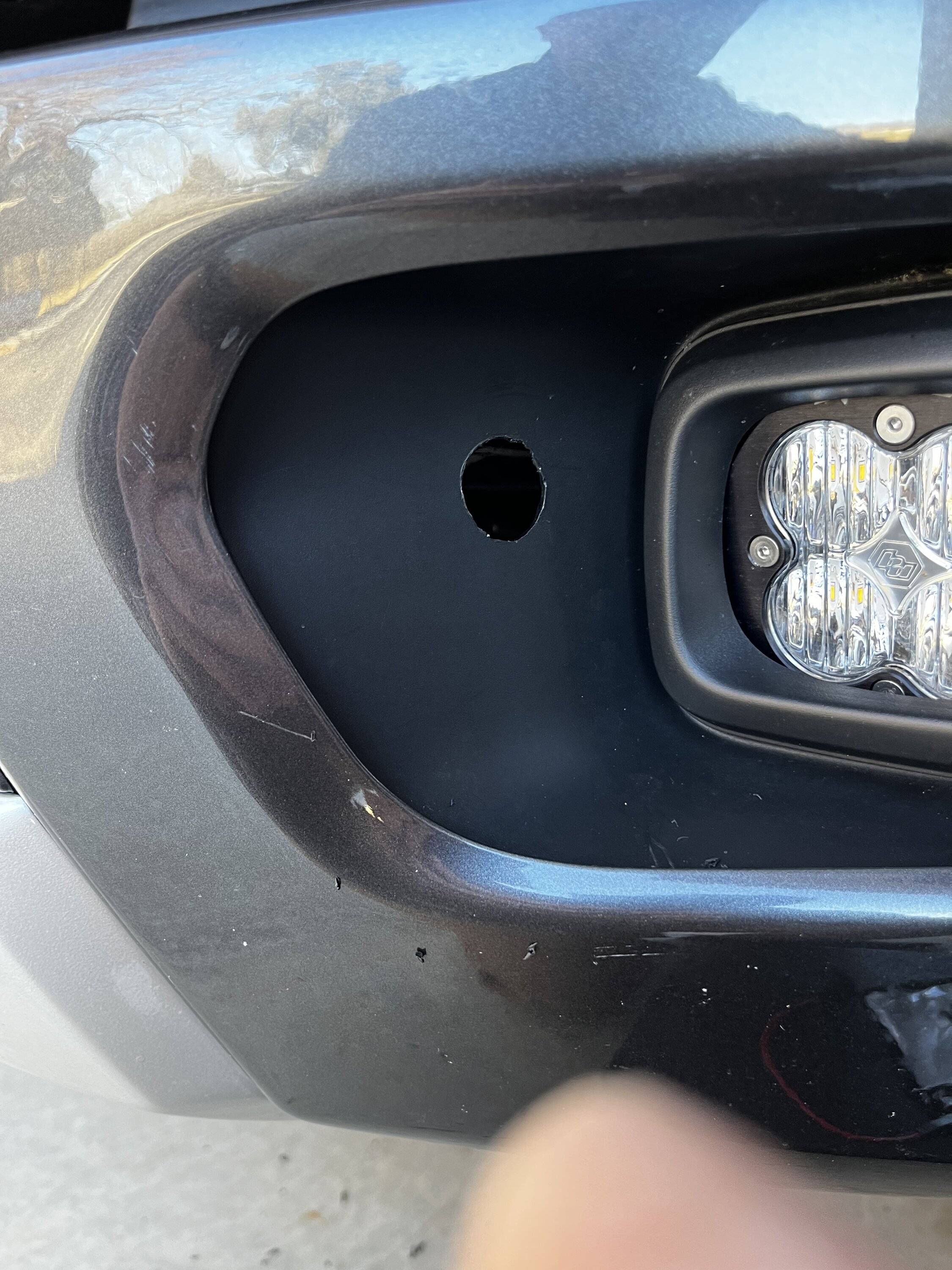

Well, here’s what I ended up doing. Doesn’t look the best but it’s actually kinda hard to notice especially if you’re almost legally blind and standing 20-30 ATTACH=full]171147[/ATTACH]
feet away and it’s raining and you’re not looking right at it ?

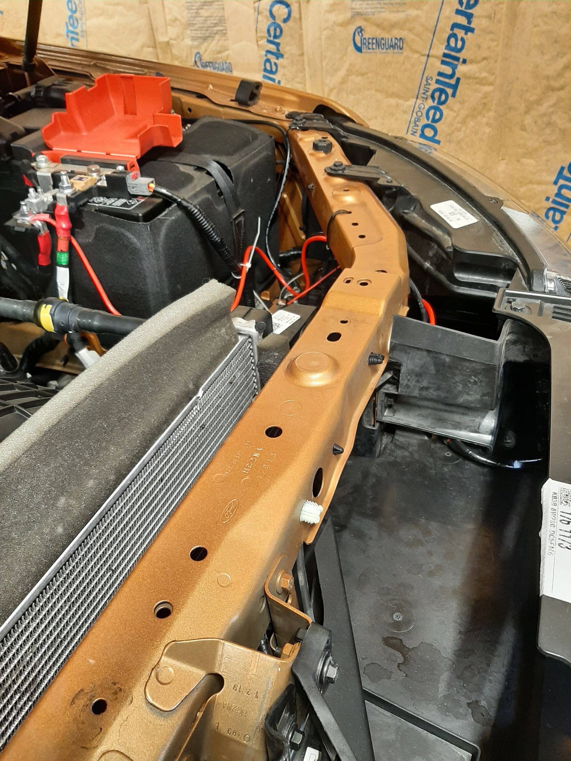

I guess I just took the "cheapie" way out.....Hard wired the short battery connector and it sits in front of the battery.
When I hook it up, have to raise the hood...hood stays up so I know, hood up, battery maintainer needs to be unplugged !!!

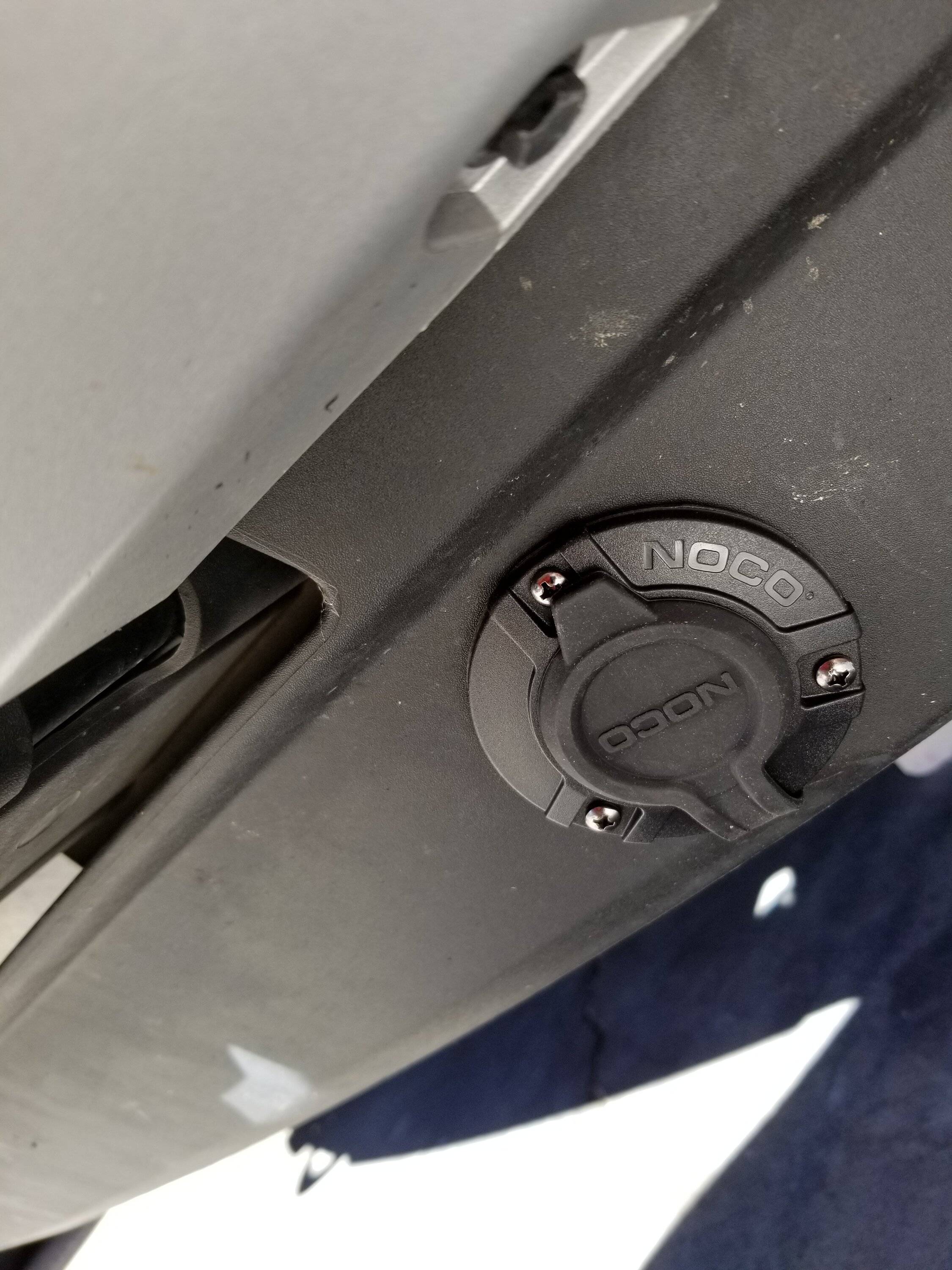

had some time to mess around with the finishing work on mine. I decided on this placement for my plug. Uses an off the shelf Hopkins trailer wiring bracket. Only had to drill 1 extra hole to fit the NOCO outlet. But in the end learned that the NOCO I bought has too short of a cord considering how wonky it is to feed that through. So out it comes to replace it with a longer wire. But I like the location for it.
