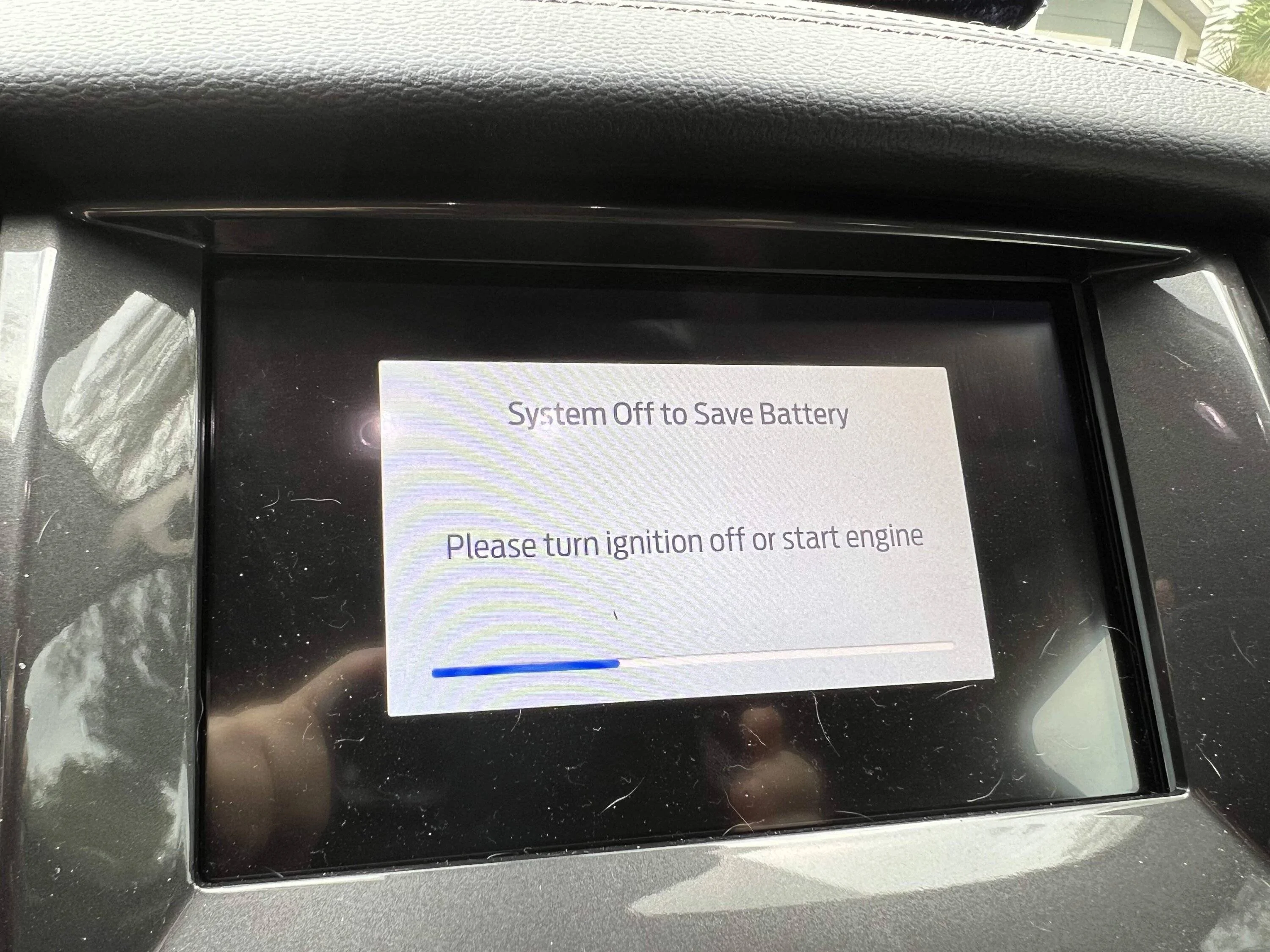

This comes up on my screen...

Not sure why this shows up when I first enter the vehicle.
Not every time but it's happening too often and I have no idea why.
Get a $20 trickle charger, problem solved. Battery will last much longer.

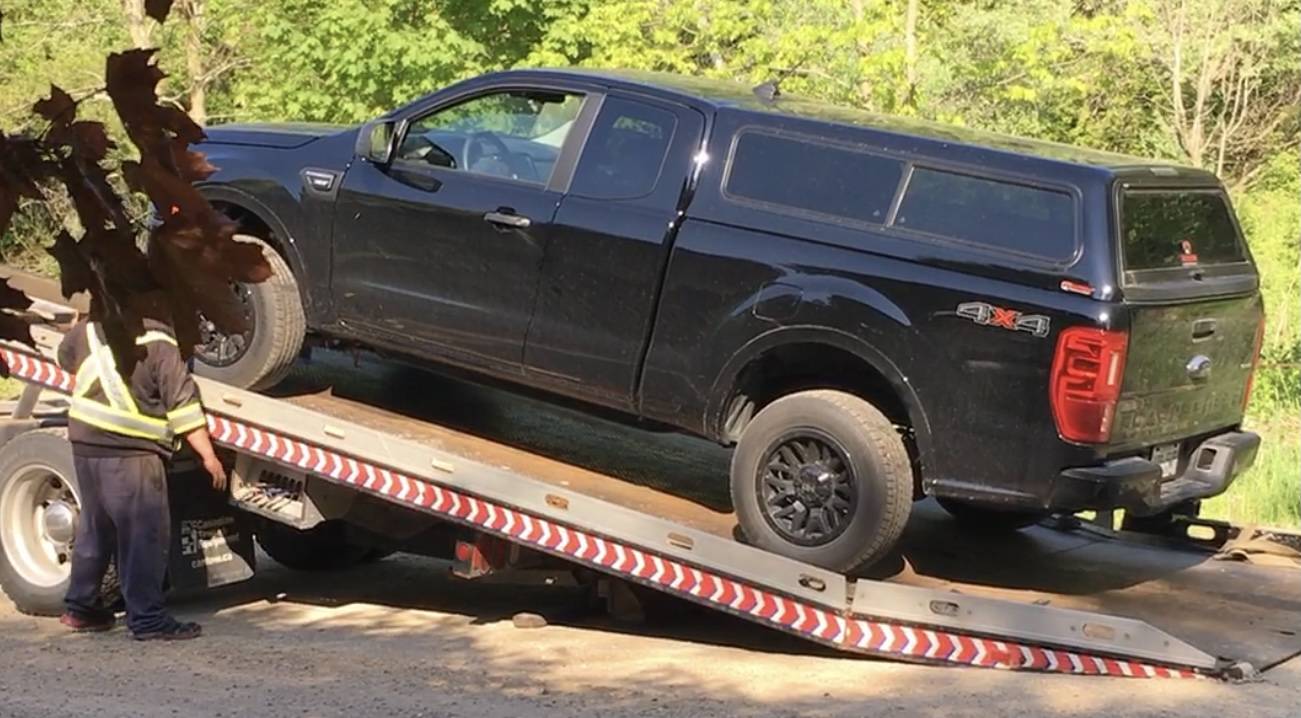

Yeah, it’s a bit of a story - was out of town at the cottage in my hometown - ready to head home on a Sunday night - no juice - called roadside assistance for a boost and figured I’d be on my way - he was having a bit of a time getting his booster pack hooked up, then it finally started but would immediately die after removing the battery booster. The roadside guy had to leave the battery booster attached to it to get it in reverse and back it out the driveway to his truck so he could load it up and take to the local Ford dealer. Turns out he torched that big 225A breaker/fuse on the battery. :(
He did the right thing and admitted to it being his mistake and the dealer had a new one by Tuesday, Ford warrantied the bad battery after testing it. In the end, I was back on the road and the tow operator likely made zero $ on that call - that fuse costs abround $250 CAD.
Small town - great service. It may have helped that the owner of the towing company is my aunt’s brother. :D
Not sure there is any real evidence to support that.
And I went 42 months without ever having to plug it in. Worth it to me to replace the battery every 42 months instead of plugging my truck in like a hybrid every night.
I think everyone pointing to a bad battery is correct. I had same warning message on mine. It was a bad battery. My dealer replaced it FOC. No problems since.
My truck was sitting for weeks without moving. Still is and I keep a smart charger hooked up to her.
