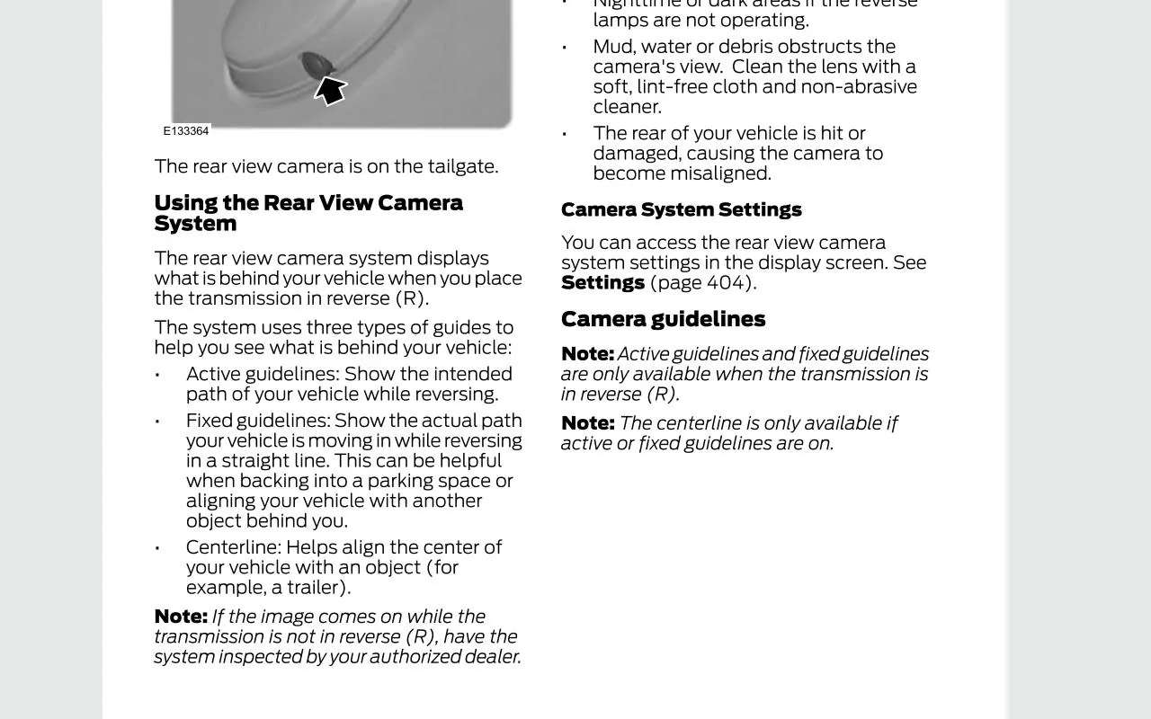

This started on the weekend. In the manual it says the camera should only come on when shifter is in reverse and if it's coming on when not in reverse to have it checked out. One weird thing though is when it is on in drive there is a "cancel" button in the top left corner and if you hit it the camera will turn off.

So if you put your truck in D without first putting it in R and backing up your camera comes on? That's what mine is doing. Here is the section from the manual that indicates something is wrong.
No I don't think that's right. I thought you were going from R to D. There's a section in the settings where you can add a delay (5 sec) so your camera stays on in D but you have to have been in R first.

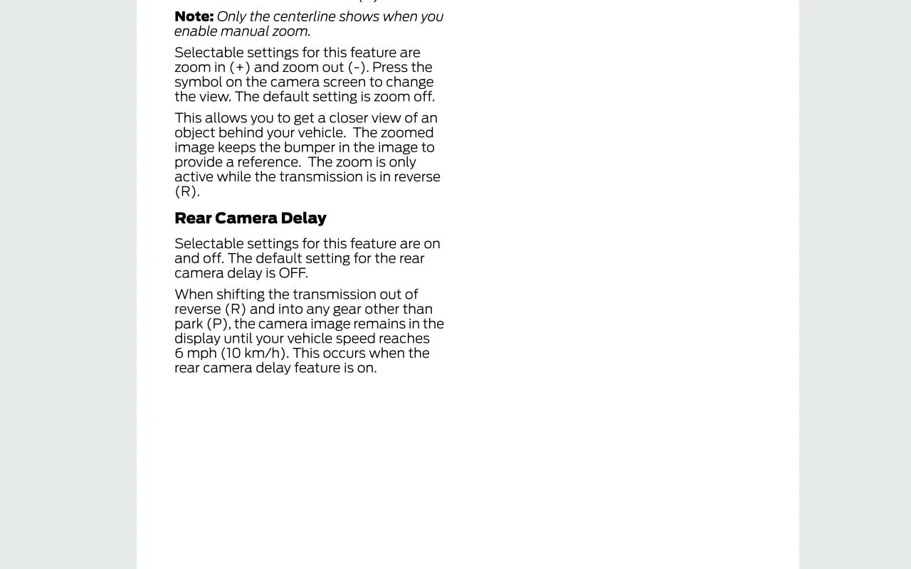

So I played with this today and it is the rear camera delay that is causing it. I had turned that setting on just a couple weeks ago but I almost never start out going forward, I'm always backing up. Last weekend circumstances had me starting out going forward several times. Anyway, if you have the RCD setting on and shift into drive the camera image will come on and there is a cancel button in the upper left corner where the zoom controls are when in reverse, if you press the cancel button the image will go away, if you don't press the cancel button the image will go away at 6 mph.

Late tot he game...I was about to post the section about Rear Camera Delay to see if that was what it was...I am glad you have it figured out!

There is a option in the Display settings that will allow you to enable or disable the Delay on the rear camera. The delay is so you can see what you ran over when as you drive away! lol! The Manual is very helpful!
