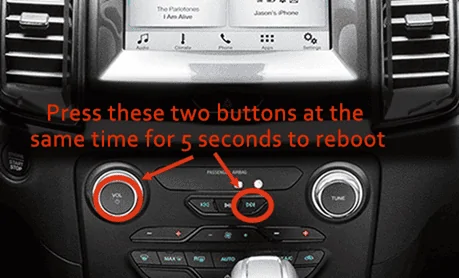

My screen locked up today randomly, & is still stuck on a map. After several restarts, it still is stuck. Any ideas?
Pull the fuse under the dash. Many videos on line show the location. Mine would not come up at all after an update but pulling the fuse removed power and allowed it to reboot.
