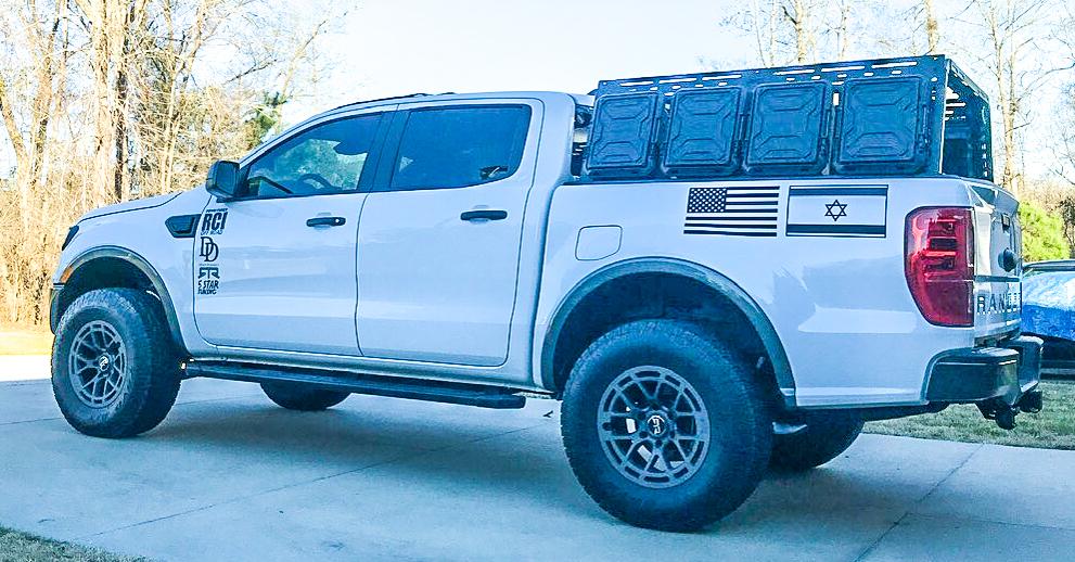

Took the liberty to put a touch on your photo, as there is some really great detail on the finish of your Ranger project. Looking good.

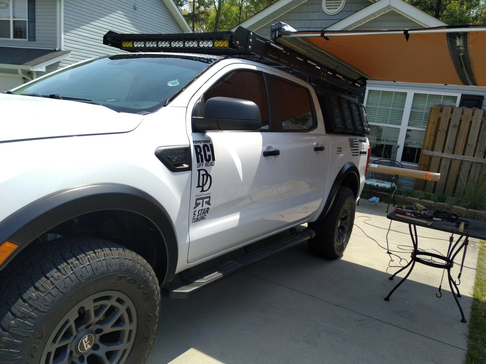

See if I can grab some progress picks sometime today. Yesterday afternoon and into the evening I got the rack tore down to its primary frame with just the grating platform. I took this opportunity to remove old wiring clips (3M backed zip tie squares) and install them under the frame uniformly. Before I kind of just stuck them where I could get access to because of the rack being already installed. I also plugged some old, now un-used, holes in the frame with ultra black gasket maker.
Ideally I would use some JB weld stick putty if these holes were going to be visible (then sand/repaint), but all of these holes will be hidden once re-installed so that seemed like a waste of time.
The very front frame support beam was removed and moved back about 8-10" and reinstalled. The front rack light bar installed like a glove in the support bars original location with the provided brackets. Once the side skirting is reinstalled it will completely hide the adjustment hex screws, but still be accessible by said hex tool. I just lucked out this idea fell into place like a boss with very little work (drill new mounting holes, plug old ones with gasket maker).
The unistrut floor framing was set aside as that component is being replaced by a new RCI panel system. I will probably re-purpose the unistrut pieces for my bed slide out system I will eventually build.

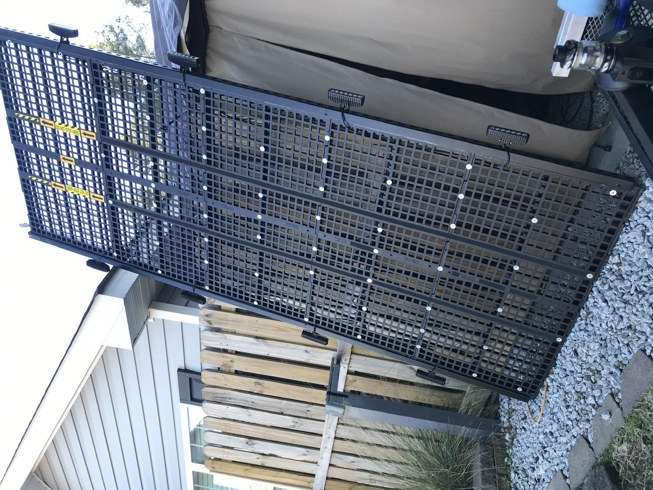

Spent all day sanding getting it ready for paint tomorrow (weather should be perfect). My sprayer came in, so other than toying with dilution to get proper flow the coatings go on tomorrow. Then the part I hate, watching paint dry until I can assemble it. Will give me some down time to work on the new wiring harness for the perimeter lighting I guess.
