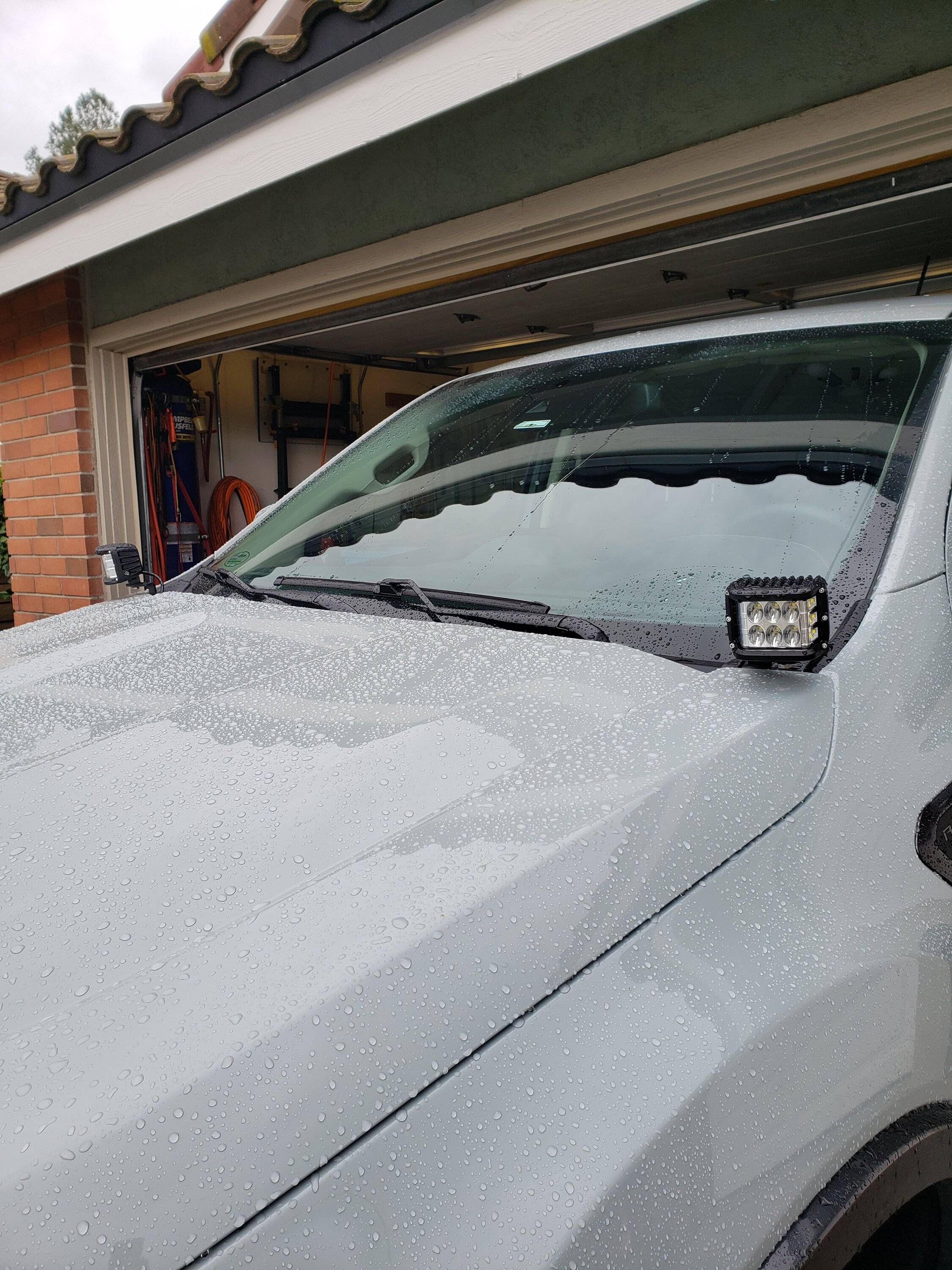

Rainy day today in SoCal, so I decided to get a couple of lighting projects done. Cali Raised ditch lights with their low profile mounts. Product quality seems to be good. Let's just say I am impressed for the cheap price. Hopefully, they will last. Installation was straight forward and there is no chance of interference with the windshield wipers. The lights come with a complete harness that has a fuse, relay, and activation switch and is long enough to get the job done. Didn't use any of that stuff. Instead I direct wired them into the 6th aux switch of the tremor package. 54 watts total.

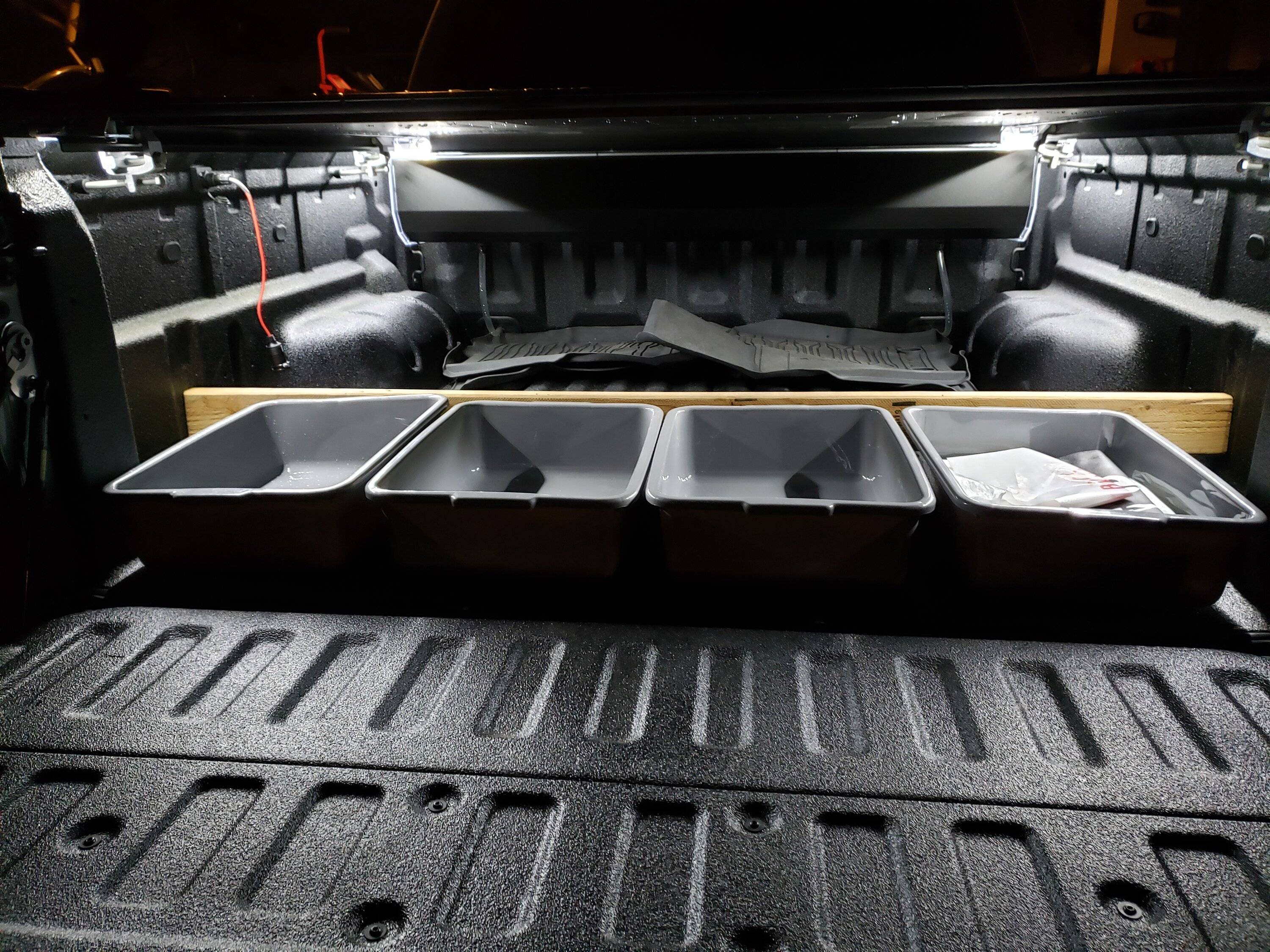

Project number 2 was lighting in the bed. I want to give a big thanks to everybody on the site that has shared their bed lighting projects. All of the different styles and installations helped me narrow down what was going to be a good fit for me. I wound up getting the split harness Wolf Haus bed plug as the power source because I intended to get one for a 12V cooler/fridge anyway. Bought the 60" LED strip lights and a 15MM switch as other on the site have. Totally, happy with the results. No drilling required and plenty of light. This project took far longer and there was a lot of in and out of the bed and/or crawling underneath the truck to route and dress the wires. The light kit did come with a complete harness also and the leads on the strip lights were long enough to reach the other side of the bed from underneath. That made life easier to get everything spliced together on the drivers side. Didn't need any additional wire. Just heat shrink and looming.
