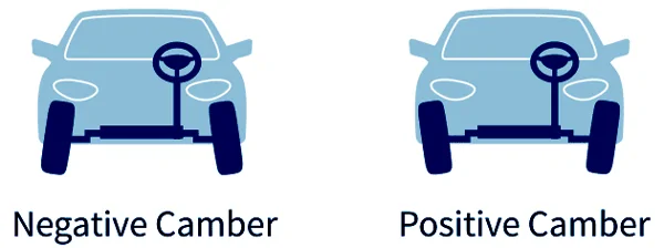

Front wheels look like they have a positive camber.
Regards
Doc
Hi Doc,
I thought the same thing, but hesitated to mention it as I was not sure due to no real reference point. Guessing it was not aligned or done poorly?

Hi Doc,
Ranger vehicle Engineering
yes, I think it needs to be realigned but you’d think with spacers the camber would be more negative..but can’t tell much from the picture..

Am alignment is on the list, but since I don't drive it very often I will get to it as soon as scheduling permits. I also need to address the left lean stanky leg the Ranger has. No idea if it currently has the "manufacturer" fix yet or not of a shim.
