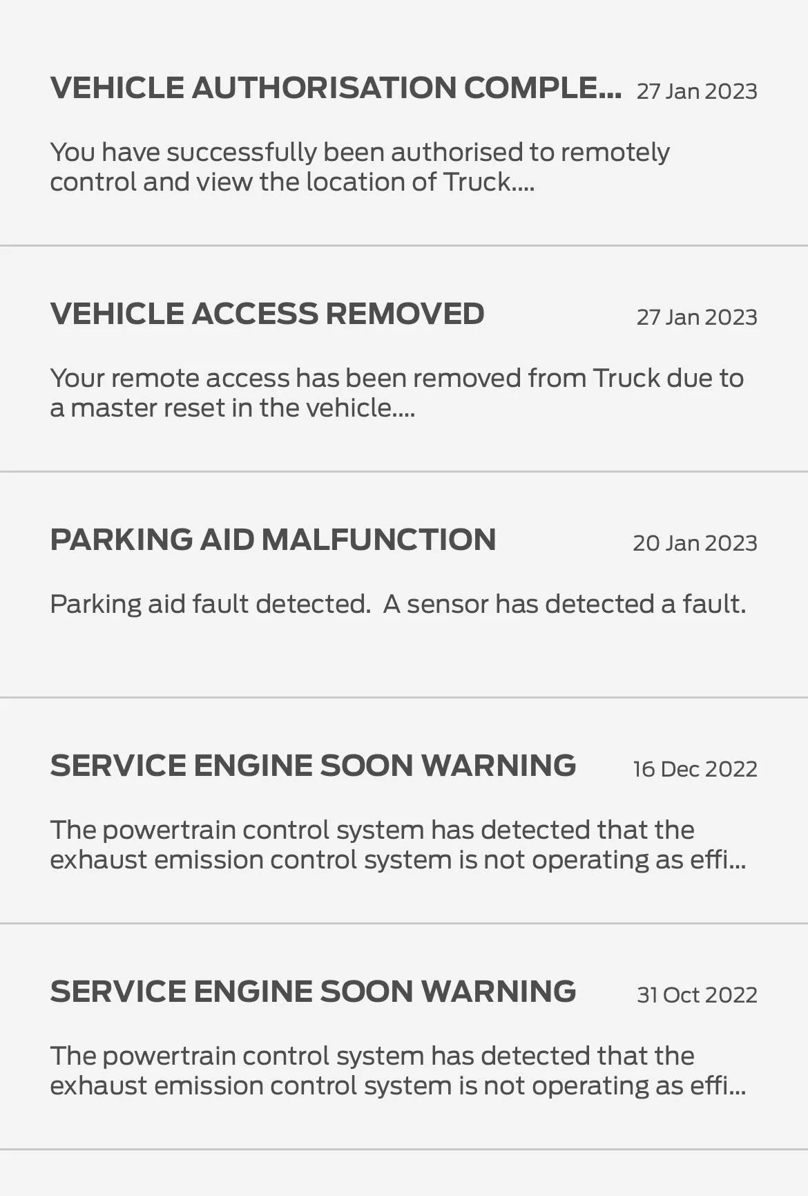

Sorry to read not good news. If you have CC on this truck it’s meant to work there.
In general you can drive if the light is yellow. Worked for me first time. Second time was hell… Same messages, totally different reasons.
For me it took battery disconnecting to get notifications to app. Still wasn’t saying much.
After last incident I started to track what my truck is doing time to time. This Ranger really takes care that I learn everything, is it my free will or not ?
