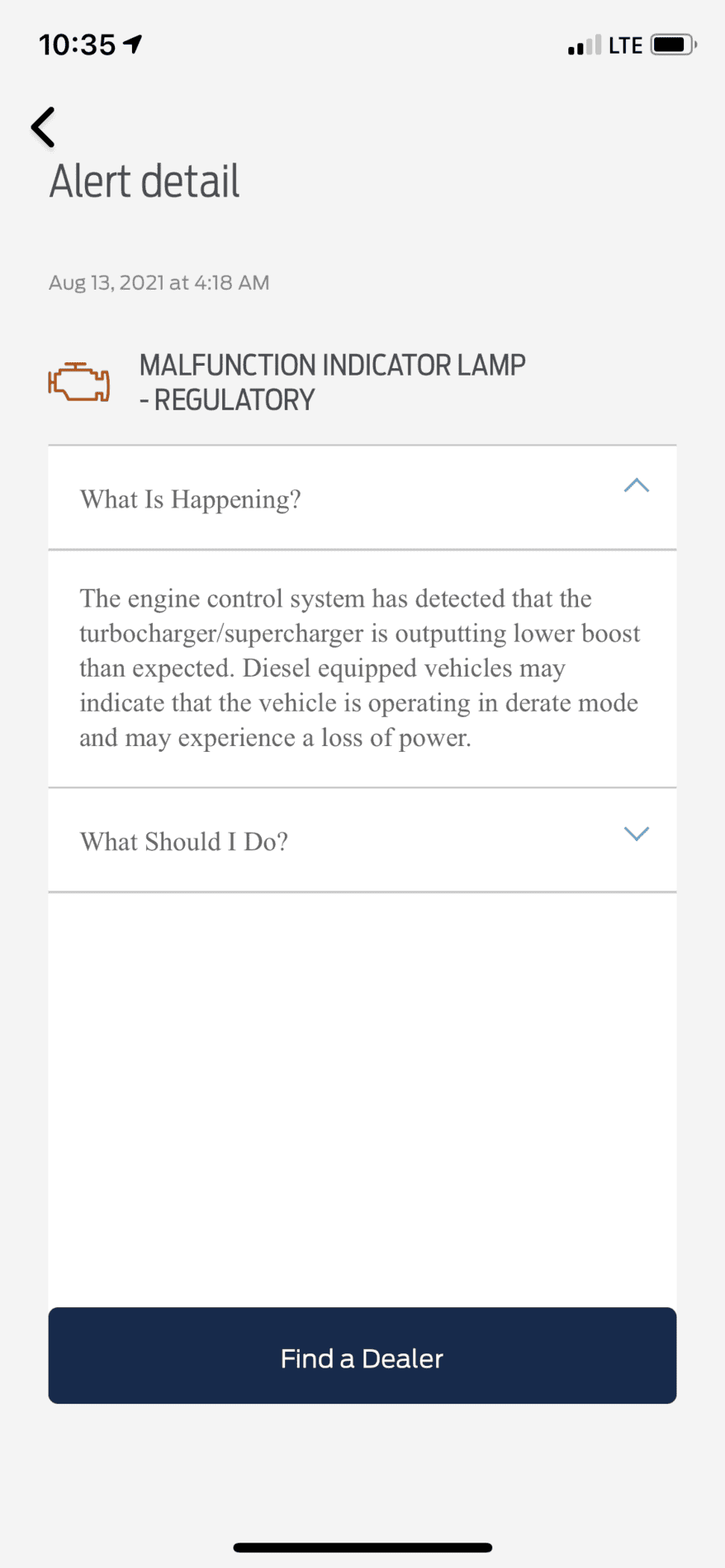

So I drove out to the Oregon coast today to start a week-long vacation with my family. Between Portland and the coast (Cannon Beach) there is quite a climb to get up and over a small mountain range. On the climb up, the wrench icon popped up on my dash, with the "Check Manual" message. Of course, I didn't bring any tools or my code scanner with me, and I'm hundreds of miles from home. Yay.
I pulled over and shut off the truck. Checked for any dripping coolant/oil or other obvious issues, and found nothing... the engine sounds normal, but has no boost (limp mode). After starting up the truck again the check engine light came on, and the gear wrench remained. I was not in a safe place to stay parked (anyone who knows this little drive knows what I mean about these roads, they are narrow, cutting through a dense forest, with almost no shoulder. I elected to continue on to the coast. We arrived in cannon beach a few minutes ago. After getting checked into our hotel (took maybe 10 minutes) the gear wrench icon has disappeared, but the check engine light is still on. However, it does seem to drive normally (boost is back, normal power levels, etc)

I had a similar problem in Wyoming towing. The code sort of implied that the boost pressure took too long to build. Luckily I have a tuner that can scan and read codes. I pulled to a stop and reset the code and went on my way.
Were you using cruise control? Just wondering. Mine has done this several times and ONLY with cruise control on.
And yes you are perfectly fine to drive it to the dealership. It is a limp mode, it'll get you to a dealer. They will probably just clear the code and tell you to bring it back if it does it again. You might also be able to get it to a parts store (Autozone, Advance, etc) and have them do it. Some wont clear codes anymore..."liability."
Your code saying "lower boost than expected" could be something as small as 0.5psi in a tiny time frame. It seems to me that these trucks have a BIT of a hair trigger when it comes to completely killing the live-giving boost.

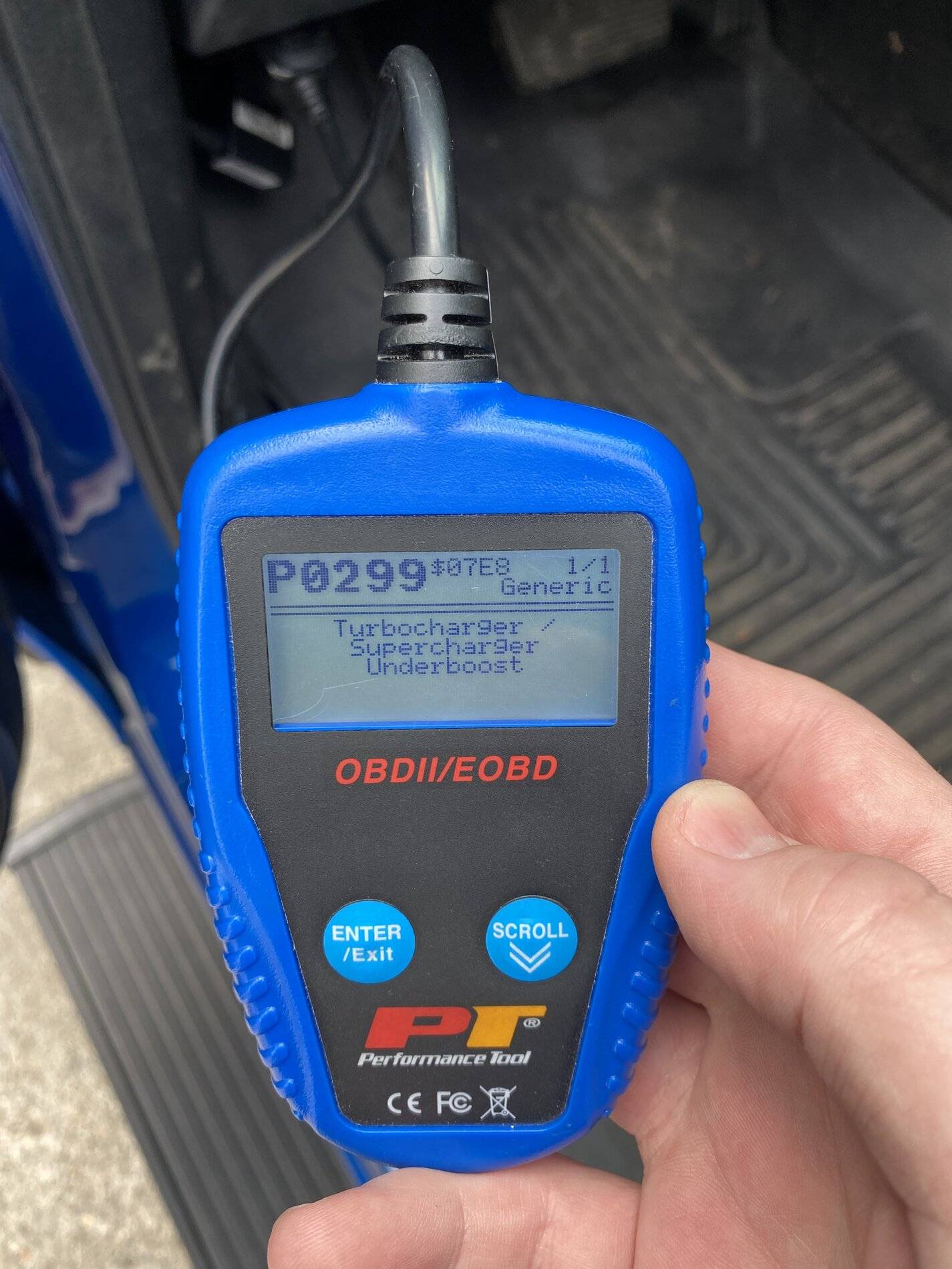

Stopped by an O’Reillys today, borrowed their scanner. Read the code (pictured) and then reset it. Has not come back yet. Truck is running perfectly. If it acts up again, off to the dealer it goes.

I love that little scan tool. Had mine a few years now and is a life saver. I think i paid like $30 for it at Oriellys. Even after you clear codes, some stay in the vehicle as history code. So all may not be lost by clearing them. I’d still take it to dealer. You check your air filter lately? Check the basics… caught a blue jay in my old trucks grill. Thought it had just fell out of grill after I hit it. Nope. Was in my intake tube. Just wondering… I know sounds silly. ??‍♂
