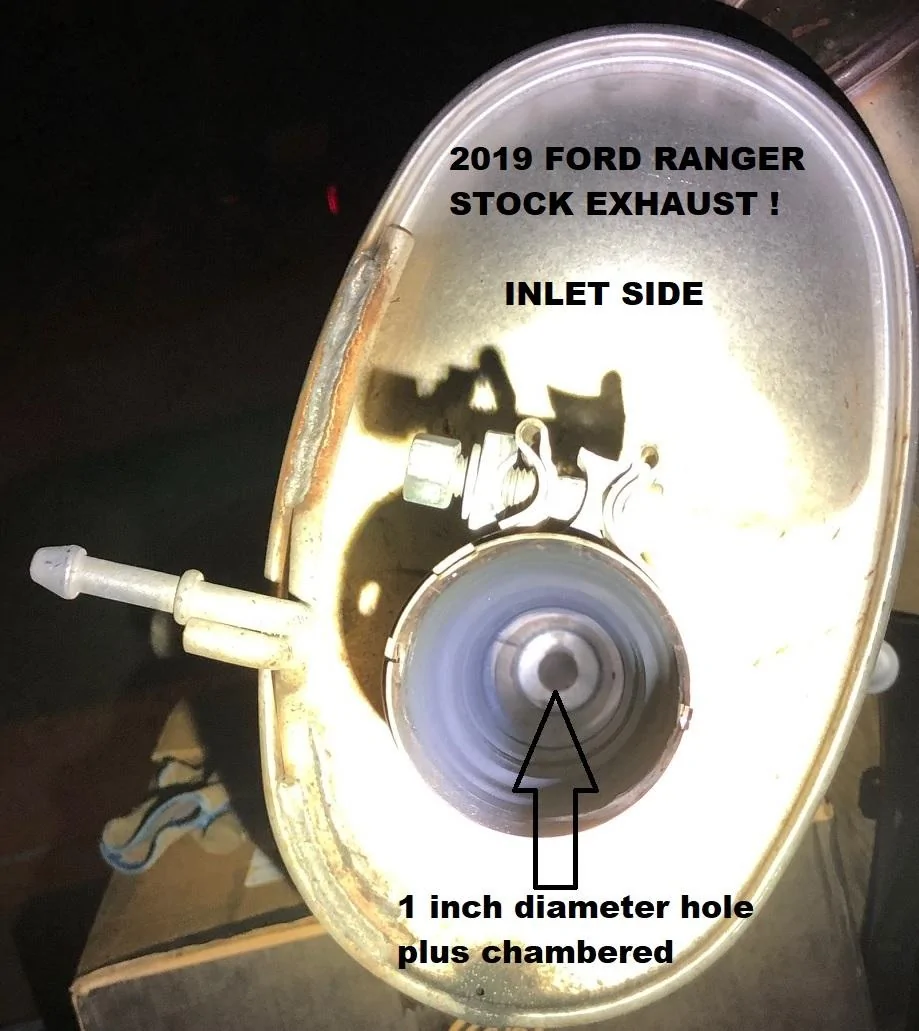

Took the restrictor plate off, thought I'd give the Red Dragon a little more juice, but lets keep that on the downlow, she's not exactly street-legal.
I removed the 1" restrictor on the inlet side of the muffler today. I disconnected the exhaust pipe from the from the front of the muffler. Then I used a 4ft jack handle to pound on the 1" restrictor. The restrictor is held on with 3 tack welds on the back and I had planned to break 2 of the welds and bend the restrictor back while still attached to the pipe. Well that didn't work out and I knocked the sob off clean. I was concerned the restrictor would rattle in the bottom of the muffler, but where ever it ended up it is not rattling. Results? The exhaust note has changed slightly, the tone is slightly deeper. I wouldn't say its any louder or droney. My butt dyno on the other hand is telling me the truck is pulling harder in the higher rpms, over 4k. The engine revs a little easier too. Even if its just placebo it took about 15 minutes and doesn't cause any issues ?

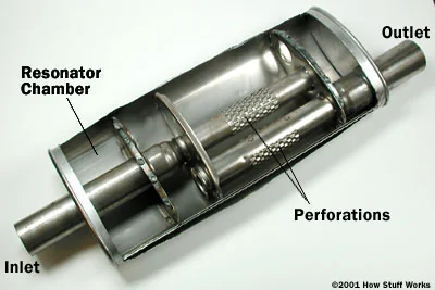

The muffler is not straight through. I would imagine it looks something like this. Maybe one day I'll cut it open.
That's what I thought. I wonder how much it impacts flow, or is it just a sort of end cap for a different chamber?
Yeah it would interesting to cut it open and see how it's plumbed once I order an actual catback down the road. Even in that image you can see that chamber at the end is connected to the flow stream.

Folks forget about all those perforations on the exhaust tubing directly ahead of the baffle. It's not a restrictor, it's a baffle.
Ford spends hundreds of thousands of dollars developing a free flowing exhaust system with a good non droning exhaust tone... then somebody comes along and uses a 4 ft jack handle to bash on it.
