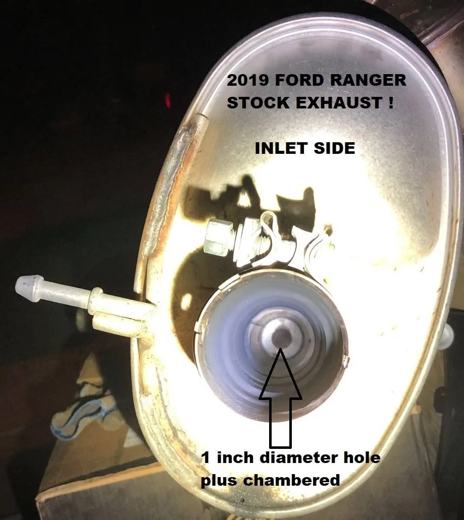

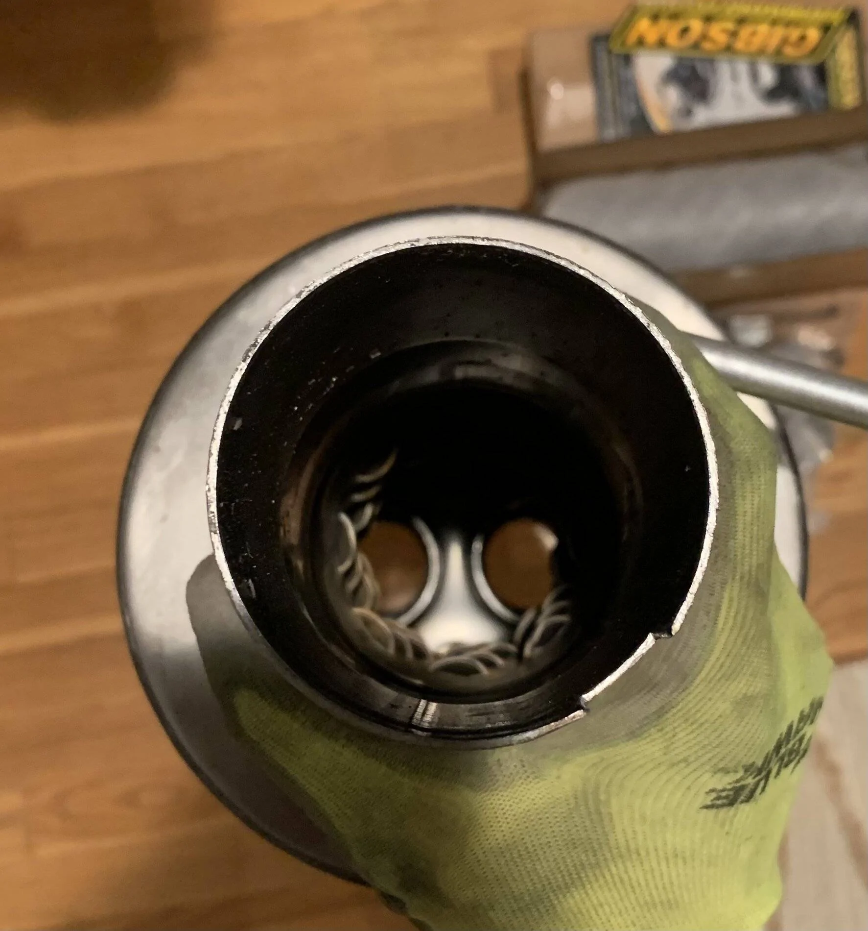

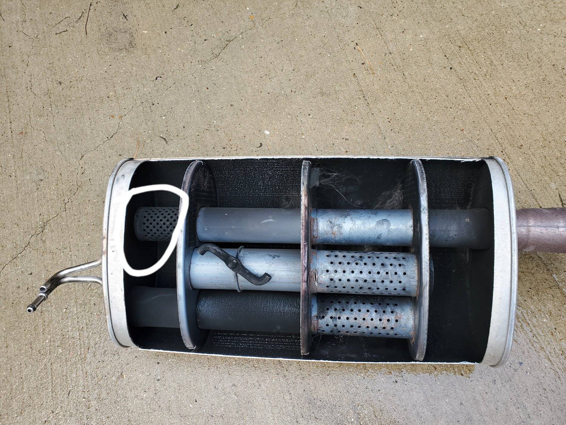

I finally cut open my stock muffler to see what was in there. I sketched in how the exhaust gas travels through the muffler. It was interesting, I previously knocked out the one inch restrictor at the end of the inlet pipe and I was not able to find it when I cut open the muffler!? My best guess would be that it exited the muffler, but i find it very unlikely that it traveled through the spring loaded valve in the midpipe. The valve is spring loaded in the closed position.. Looks pretty restricted in my opinon!

does removing the 1 inch restrictor help at all? I dont plan to do it but just really curious Id think its there for some reason like the one way valve to keep back pressure at a necessary minimum level maybe?
Turbos create their own back pressure. Thus a turbo operates most efficiently with zero restrictions in the exhaust path; be it a cat, muffler, small piping diameter, bends in the exhaust system, etc. That’s why spool (aka build up to boost) can happen so much faster when impediments to exhaust flow are removed.
Removing impediments is easy. Getting your exhaust to not sound like ass afterwards is the hard part lol.

...spring loaded valve in the midpipe. The valve is spring loaded in the closed position.. Looks pretty restricted in my opinon!
Where the hell is this???
Mid pipe would be between the downpipe and the muffler. I don't recall seeing that but I also wasn't looking for it when I tried my truck without a muffler (don't recommend).

Oops I meant the middle pipe in the muffler
