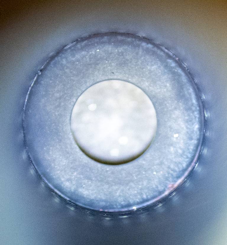

I finally cut open the OEM muffler!

Muffler Update: Dealer confirmed that it is indeed glass pack from the muffler and that they have seen it several times before. I asked about replacing it so it is OEM (just to see what they say) and they said nope. This is a CPO with an additional Premium Care extended warranty..... and prepaid maintenance program. I made my case about it only having, 40,200 miles and zero rust, and was met with another big nope. I love my ranger but am not impressed. May cancel my new Bronco order and reach out to corporate. Not because but needs fixed, but because they refuse to back a product. @Ford shame lol.
