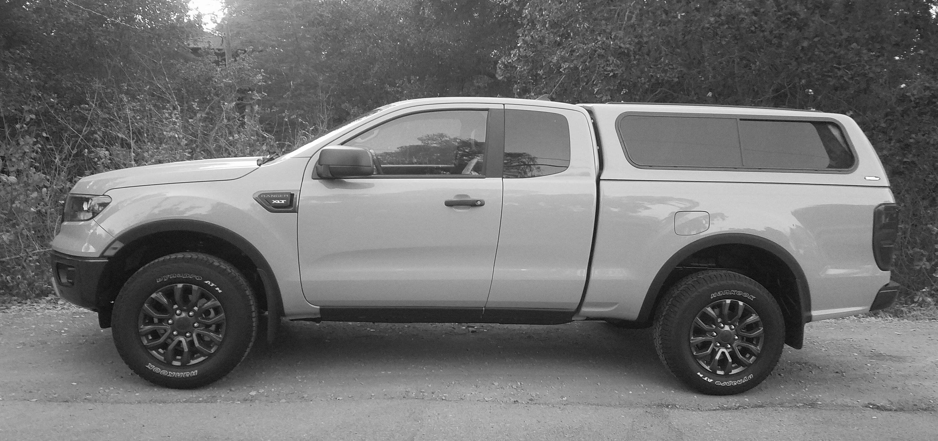

I would still like to see a picture of the truck with the topper
Yep, here it is :) Sorry for the delay -- I didn't have time to upload one before now.
1pt21gw
Nov 25, 2020
635
2,072
West Coast
'20 IS XLT SC / '22 OW BBB 2Dr
Ye' Ole Traveler
Ignore the Dash calculated algorithm, it is a guessing algorithm "based" on history, how you drive and what it thinks you will get. ~ it can be manipulated! Everyone here gets something different and we basically have the same truck.
Put your tire pressure or something else in the dash instead and watch that. Basically ignore the mpg. Hand calculate if you want to. Get good gasoline, it makes a difference!
Drive it spirited, vary your driving. Driving it the same way constantly is a downward spiral to low mpg. Freeway will get you better, just keep it under 2k rpm.
Doesn't matter what you do to it, lift, tires, etc. No mods or a bunch of mods, mileage loss is minimal. it's all about the motor and what it thinks it should do for you. Make it think and work for you. Try cruise control vs. feathering the gas pedal on a multi tank trip. - Spoiler cruise control is worse.
Just my .02 after 5 pages.
Nice lookin' truck btw.
