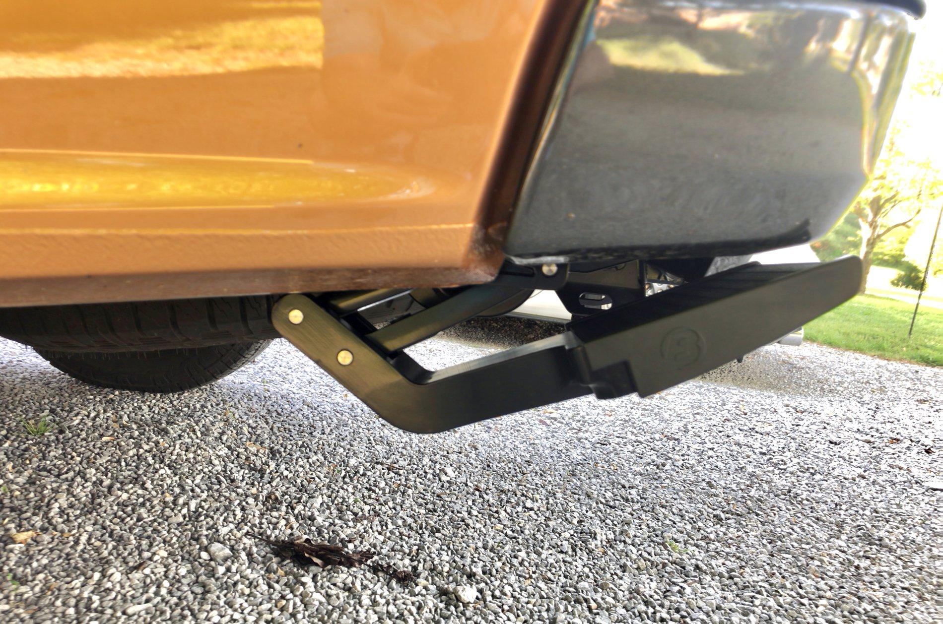

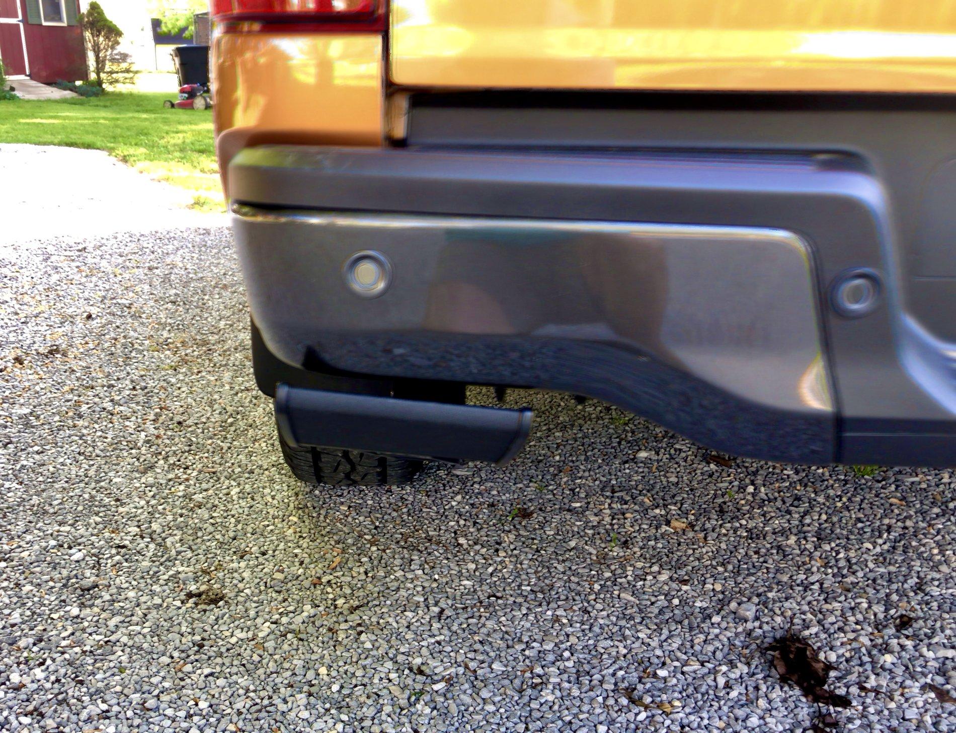

I did not use any.
Good because it is a lot of work to unbolt and add a shim.
Took a chance as I wanted it to fit tight. No shim works.
In relaxed position it is 8-10mm from bumper. If I lift it as much as possible I does not touch bumper and is about 2-3mm from it.
Wanted to make sure it would not bounce and hit bumper, chipping paint. Mine is adjusted all the way to right in picture. I lined it up with bumper. Can move to left 1-1.5" if one wants more step when tailgate down.

I did not use any.
Thanks a lot Sandman, that's what I was wondering about.
Looking at the instructions, I'd have to take it down and start all over again to add a shim!

I did not use any.
If it were mine, I'd feel a little better by adding a couple of those clear rubber bumpers to the bumper where it might contact. You can find them at any Lowes, Home Depot, etc.
Agree with suggestion.
But even if I lift the step with force it does not touch. But, protection never hurts.
