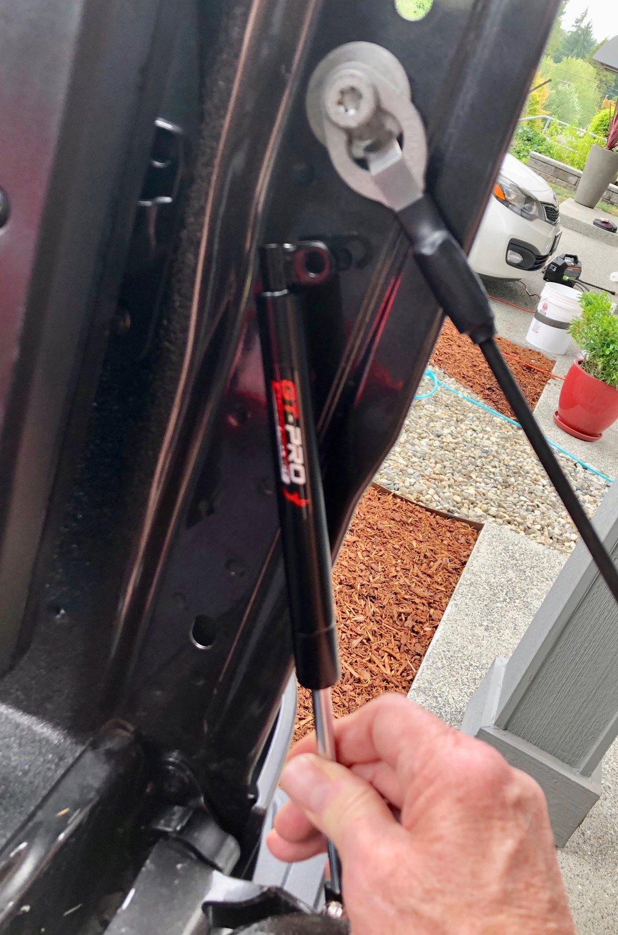

Got mine today and headed for the garage.
Same deal with the seller....already got the refund and no need to return.
So, if it's mine to keep......let's see what we can do.

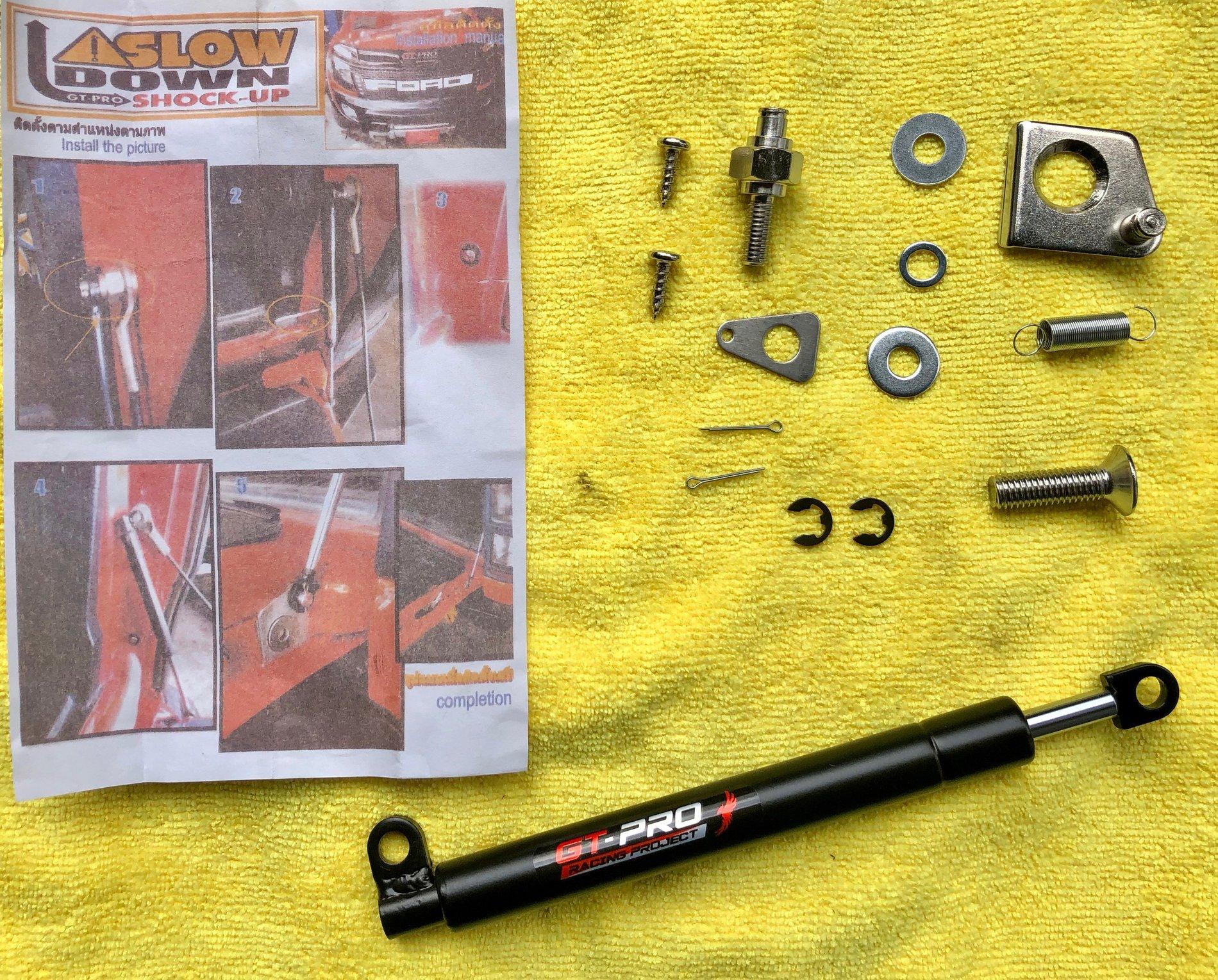

Lots of parts in the little bag.
As others have learned:

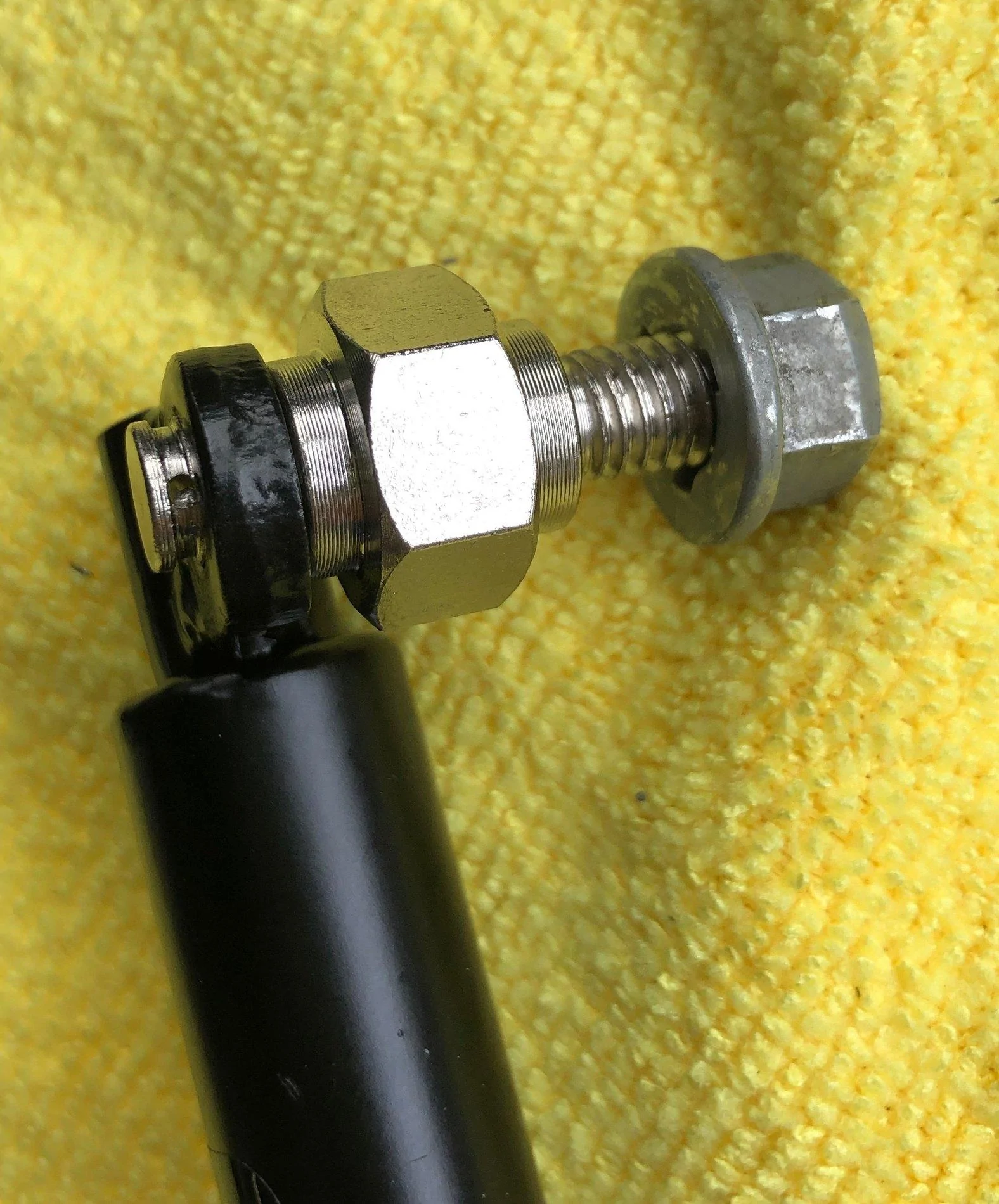

1) The top mounting bolt diameter is too small
2) The damper itself is too short
But: The lower bracket goes on (with a little filing) to make it lay flat

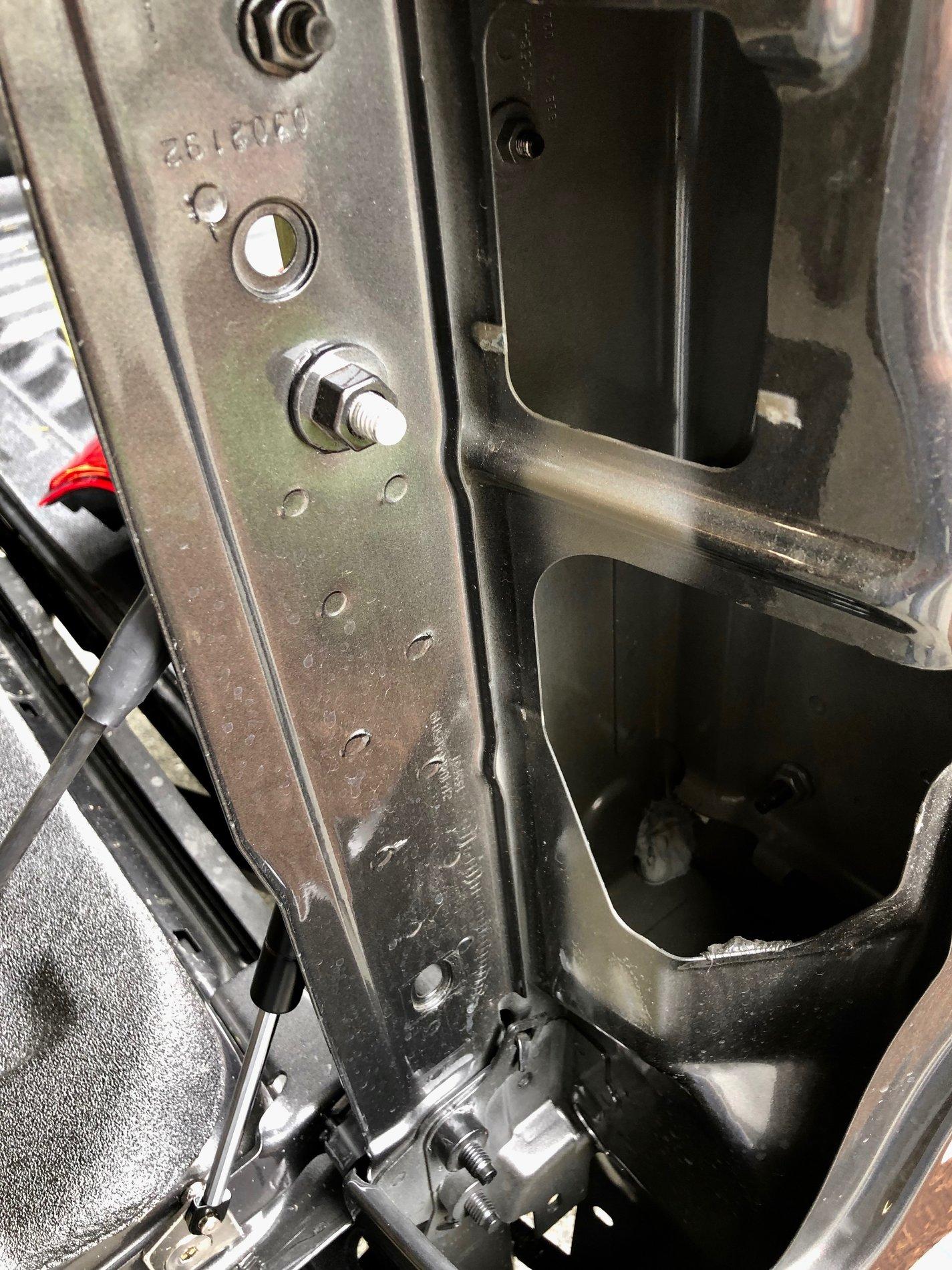

I test fit it a couple of times.....then carefully removed the tailight (I've seen other posts about how expensive these are!) to see how much room there is.
So........I haven't quite done it...yet....but it looks like I could drill one hole just below the tailgate cable mount...and it will work.
