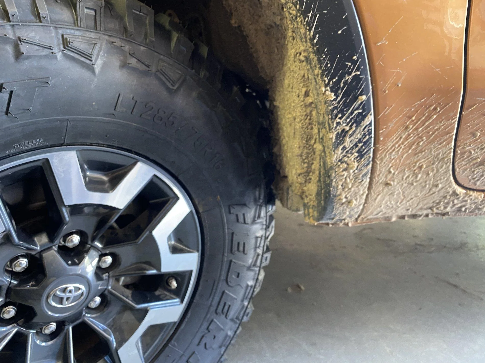

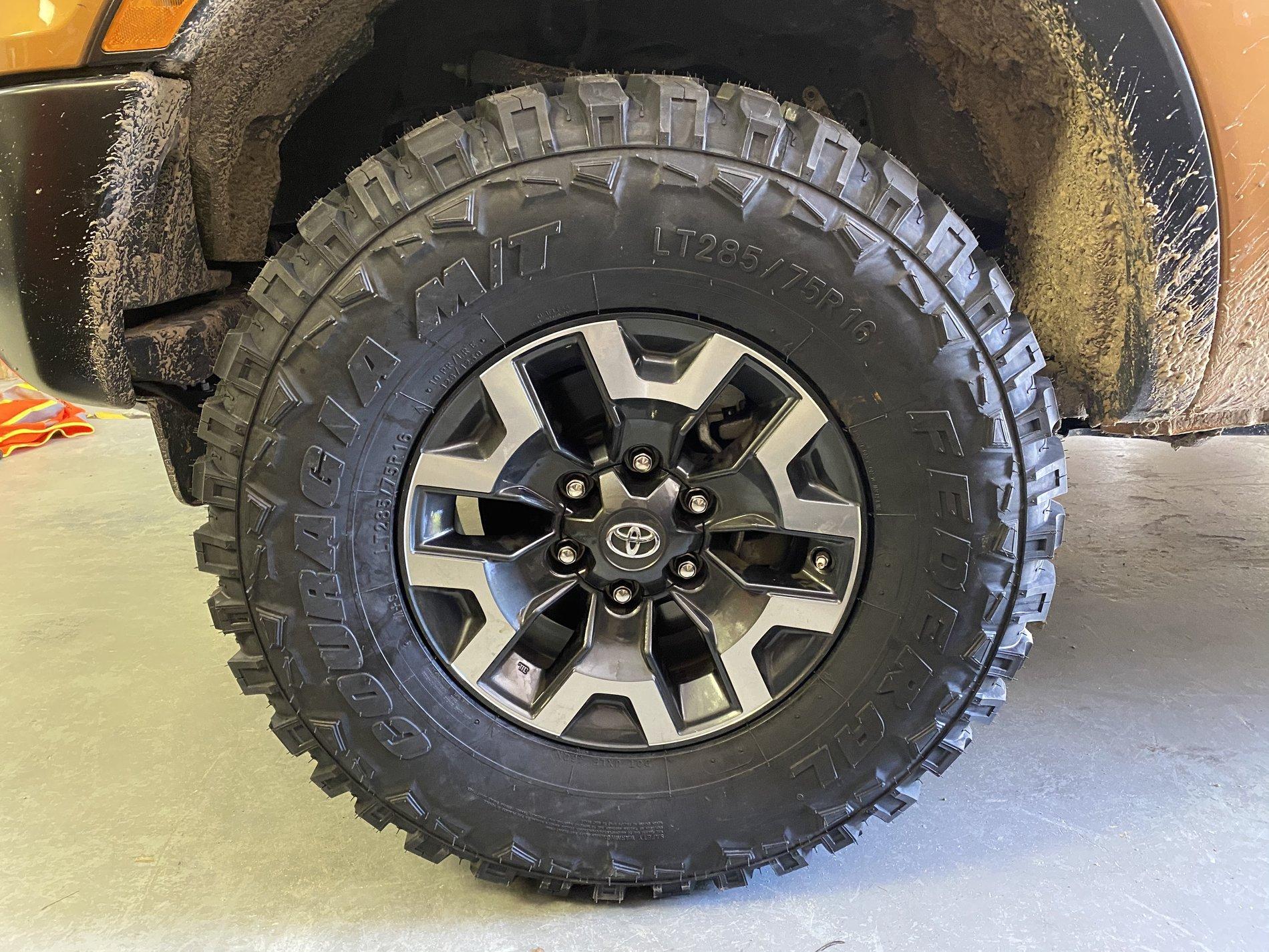

Hey I just wanted to let you guys know that the Tacoma TRD off-road rims fit on our trucks. I got pair of Federal Couargia MT LT285/75R16 to complement them. I haven’t officially mounted them since the lugnuts arnt the same. Once I get them all 4 mounted I’ll update the thread with more pictures!
The only thing I had to get to make it 100% fit are a pack of hub rings (106mm OD/93.1mm ID)

I’m not sure you’ll get an answer from the original poster - hasn’t been on here since March 2020.
It’s likely the bevel on the Ranger lug nuts are different than Toyota lug nuts and would not mate properly with those wheels, which could be a dangerous thing.
His showcase lists a 2-1/2” Rough Country levelling kit.

Needs the shank style lug nuts on Toyota rims to be safe.
