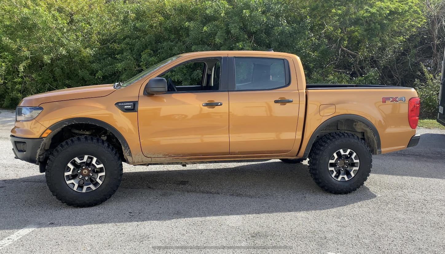

Hey I just wanted to let you guys know that the Tacoma TRD off-road rims fit on our trucks. I got pair of Federal Couargia MT LT285/75R16 to complement them. I haven’t officially mounted them since the lugnuts arnt the same. Once I get them all 4 mounted I’ll update the thread with more pictures!
The only thing I had to get to make it 100% fit are a pack of hub rings (106mm OD/93.1mm ID)
https://www.coyoteaccessories.com/wheel-accessories/hub-centric-rings/106-9310
if you guys have any questions please let me know!

In the meantime I'd pop those center caps off. You don't want your Ranger to become underpowered and have the tranny start surging and hunting for gears. lol

looks good! (besides the center cap). hopefully the lug nuts aren't too much of an issue, I know toyota has a pretty unique lug nut type for it's alloy wheel, hopefully you can get that type in the ford thread pitch? or is it the same thread?

Surprisingly enough they are actually the same thread

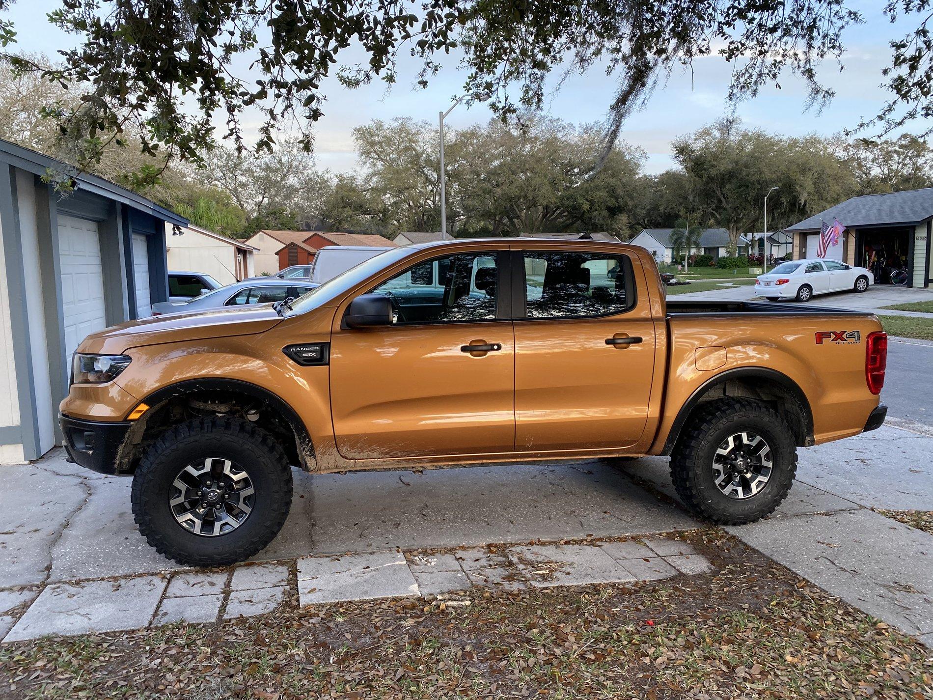

Update on the wheels, they’re all on after getting all the lugnuts but sadly the custom hubcaps aren’t in yet. All I had to trim were some aerodynamic mud flaps that were up front

those look really good !
also do you have any shots that show how the tires fit with the fenders?
Thanks man! Sadly I don’t, but I did plan on taking all of the photos in the world tomorrow so I’ll definitely get a photo of it!

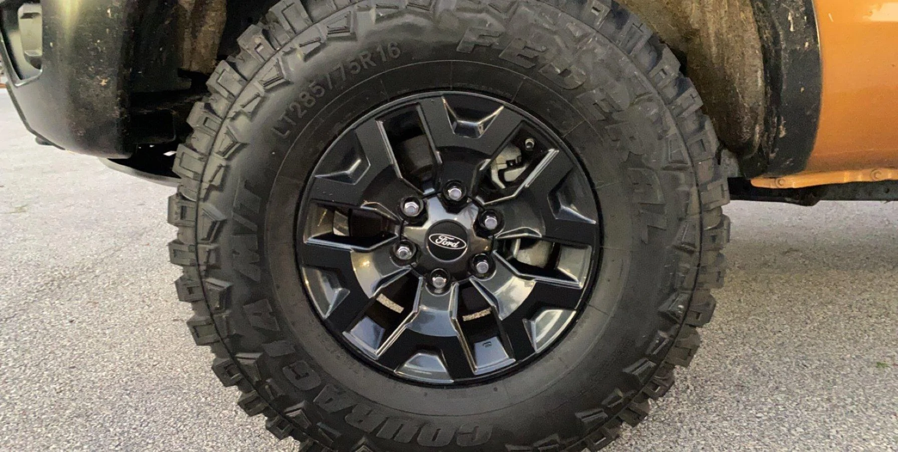

It was getting late but I did this real quick on only my driver side tire
Amazing how much better those look when painted/powdercoated!
