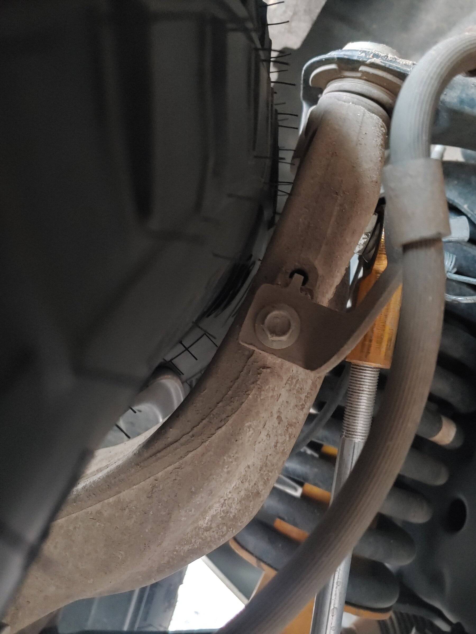

My dealer installed 1.5" spacer level in front and 285/70/17 Toyo AT2 prior to me coming along for purchase. Did not have to remove crash bars. Clearance was pretty paper thin on full turn lock either way, but it did clear.
People need to understand some 285's will fit, some will not, not all rubber marked as "285" is the same exact measurement.
