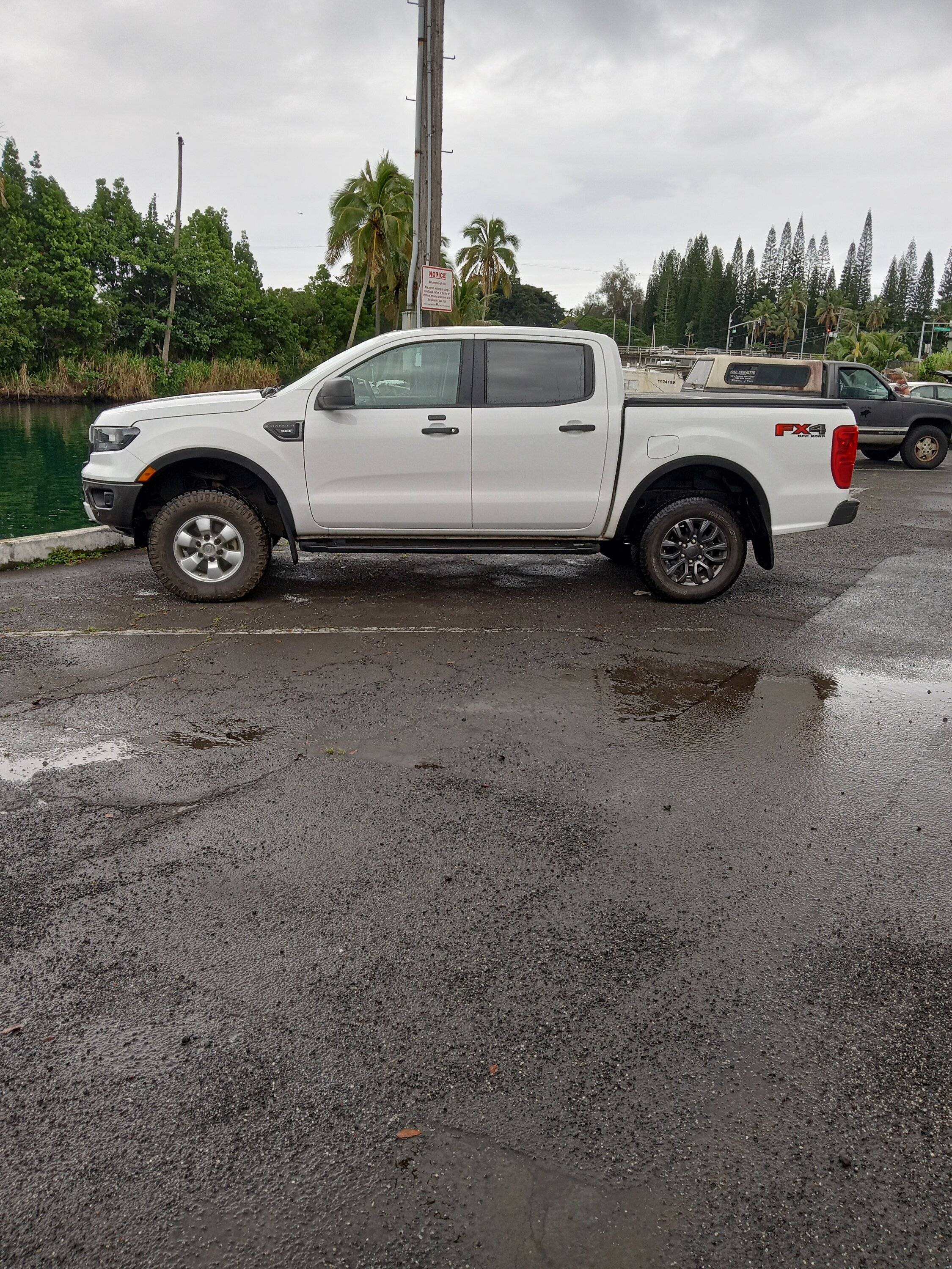

Does running two different brand wheels make it bi?
Mostly concerned about fitment on the front and wanted to see difference lol. My truck has a "its none of your damn business" attitude lol. love the 6112's and am debating between bilstein or eibach and definitely getting sumospring blues. This thread is about wheels though and I can say, you can get stock tacoma/4runner wheels all day out here in hawaii as everybody rips them off and spends big money on flashy wheels. Some for sale literally have 1000 miles on the stock wheel/tires and go for $500 for the set with tires. Financially it just makes sense to thrive off of someone elses lunacy!

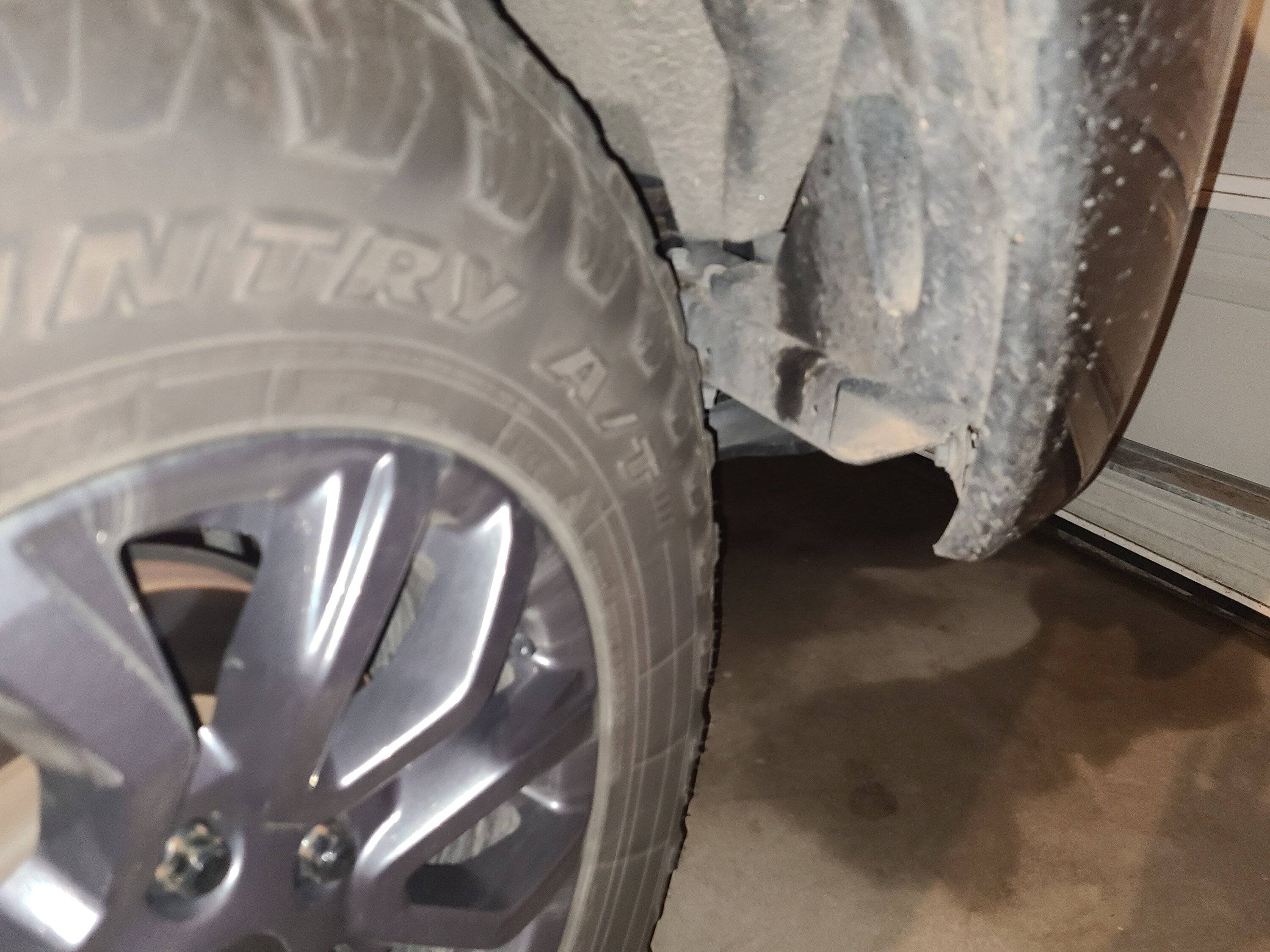

after the toyota symbol was removed the wheels look pretty sharp. i bet a lot of take offs are collecting dust we could snap up. i like my stock wheels fine. but i want to run a 255 80 17 without rubbing etc. so i thing i need different off set.
My 255/80 r17 Toyo AT3s fit on factory Magnetics with 2" of lift and crash bars still in.

It's dirty but here's a crashbar and a tire.
Not sure what you want a picture of.
thank you ! I was wondering how much room you had left with the taller thinner tire.
