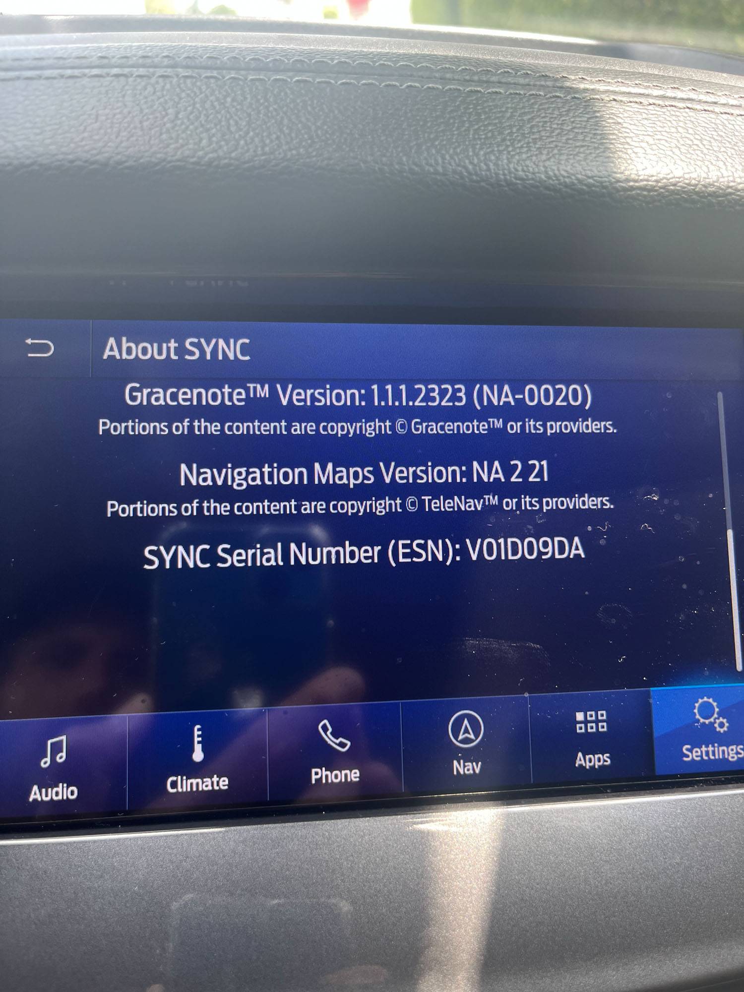

Curious to know what version is your Sync at with this replacement, or did nothing change there?
