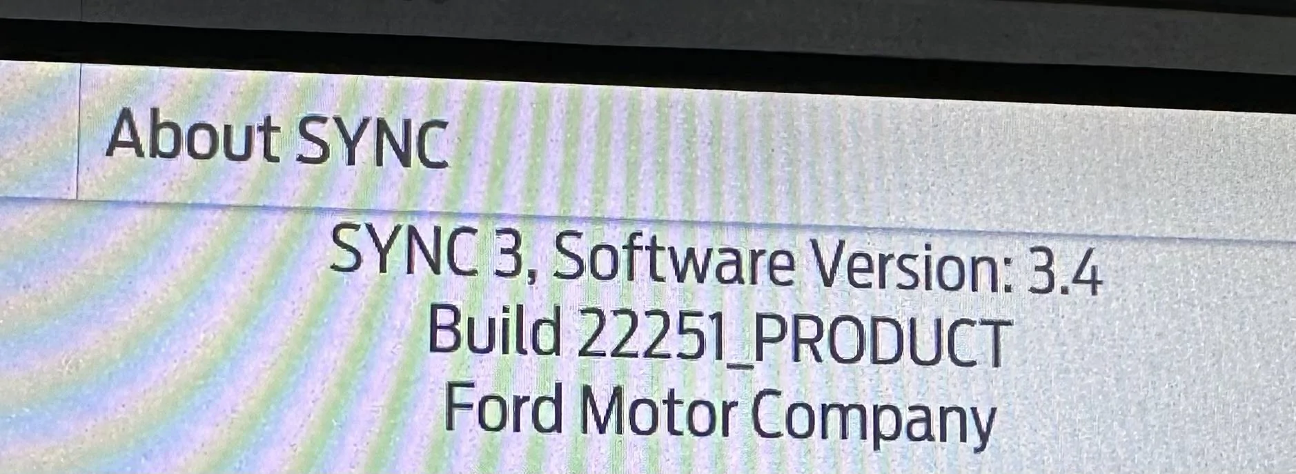

It sure looks like it’s actually version 22251 that is the problem here. Last I checked about a week ago there was no update yet, not sure if that’s changed.

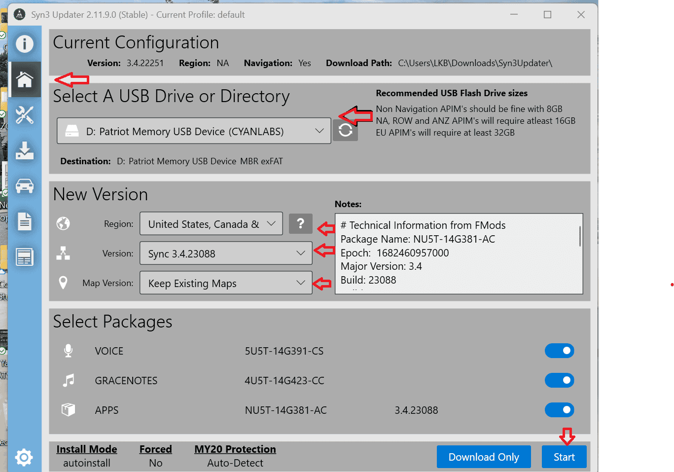

you can get a newer version using the Syn3updater from Cyanlabs, might be worth a try... It fixed my forpass update issue.
Just updated mine yesterday. I was having it jump to radio from my USB source occasional. I don't use XM so I have it removed from my source list.

What SYNC version did they install on it?
I am pretty damn confident this is the issue:
“This is not a hardware issue. The APIM is not defective. If you are paying for this, you are wasting your money. The issue is a software issue. Logs are being created and filling up the rwdata partition. When this happens, there is not sufficient space for the settings to reside.
New hardware will cause Sync 3.4 Build 22251 to work properly. But when the rwdata partition becomes full again, the same issue will be present”
