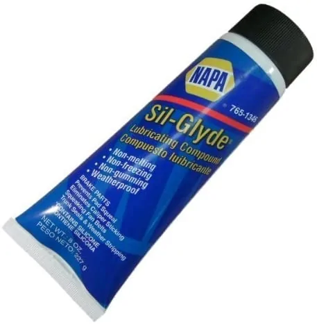

I voted no, but I did actually buy one and installed it, but took it back off once the weather got cold...that thing squealed like a stuck pig. People in the Lowes parking lot actually cringed. It's not going back on.
It's not the damper, it's the bushings in the tailgate hinge.
You can either spray something in there, or do what I did which was remove the tailgate (easy to do) and put some Silglyde silicone brake lube on them.
Problem solved.

be careful where you use it. It burns. So I’ve been told.
26,236
132,091
You're supposed to use Astro-Glide not Sil-Glyde...Put your glasses on.? ?

Nope, it's the damper...I removed it in the Lowes parking lot and the crying and moaning stopped.
It stopped because the hinge was no longer vibrating, causing the resonance in the hollow tailgate.
Mine was bellowing like a wounded ox.

First time it happened to me I was scared it was the damper. But a shot of silicone lube took care of it. It first happened right after it rained here (which is rare) and it must have turned the dust to mud in the bushing. It sounded like a creaky old barn door opening. lol
