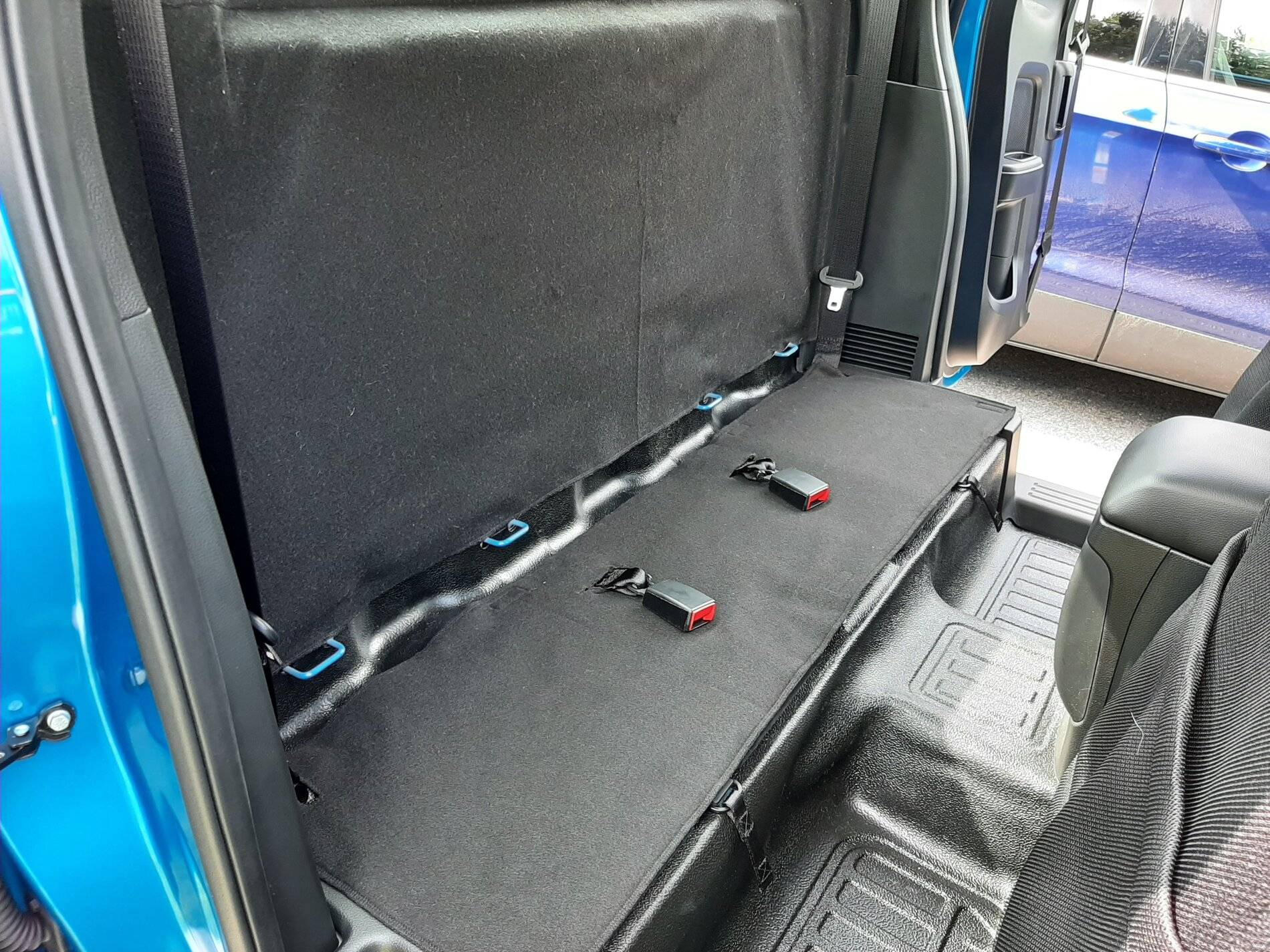

Finished my seat delete project this morning (with t
he wife stitching around the edges and openings for the seat belt buckles). I wanted the seat loops and seat belts exposed for securing items. Quadruple layers of felt fabric are layered under most of it for help with sound reduction. After years of being around Harley's with straight pipes, Mack truck with no mufflers, large construction equipment, being in bands and my first marriage of 20 years, I'm so used to noise it doesn't faze me anyway.

Nice rear seat delete! what kind of fabric is that?

Thanks. The fabric is felt from a fabric store, with velcro sewn into some areas of the edges.

All extended cabs are basically 2 seaters, but I do occasionally (very) need to tote another human so I leave mine in. But, how did you remove the rear seatbacks? I removed the bolt at the top, but I tugged and pulled and never could get them out. What's the trick?
If I recall correctly, facing the seat back, it’s a bit of a push down and a sharp pull towards you. My seats are stored at my cottage - I will be there Thursday and can take a picture of the back of the seat - I think it will help you reverse engineer what you need to do.
Yep, that's about what I did. I removed the top bolts and pulled the top of the seat toward me (I think there was a plastic clip holding it about 3/4 of the way up the backrest) and wiggled it back and forth with an upward motion. I used some abrasive language and in my mind it helped.
Yes! It’s a large v-shaped push clip that just needs a bit of verbal coaching.

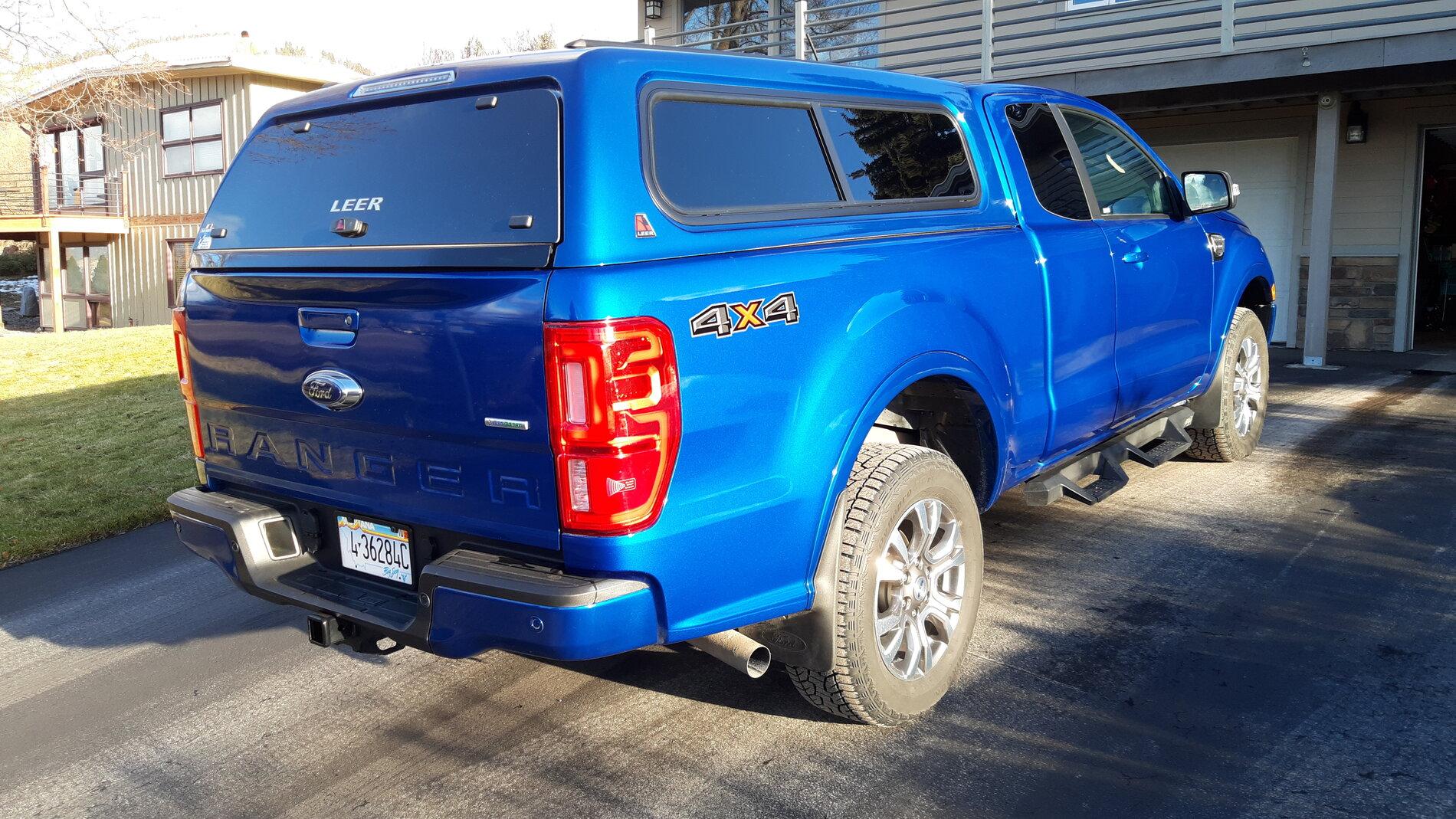

The only downside to a topper on a SuperCab is that the front of the bed is an extra foot further away from the tailgate, which means climbing in to retrieve stuff that is too far forward to reach by just leaning in. I suggest getting windows that open at least on one side to be able to scoot stuff forward without having to climb all the way in there.

Does your topper having sliding windows?

Yes, that one on the passenger side slides open and has a screen.
These are largely made-to-order, so you can choose what kinds of windows you want where. There are several options.
