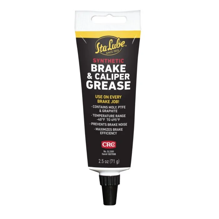

I'm curious if CRC brake grease would work better/longer for the slip joint. It has moly, ptfe, and graphite and is designed for sliding surfaces.
