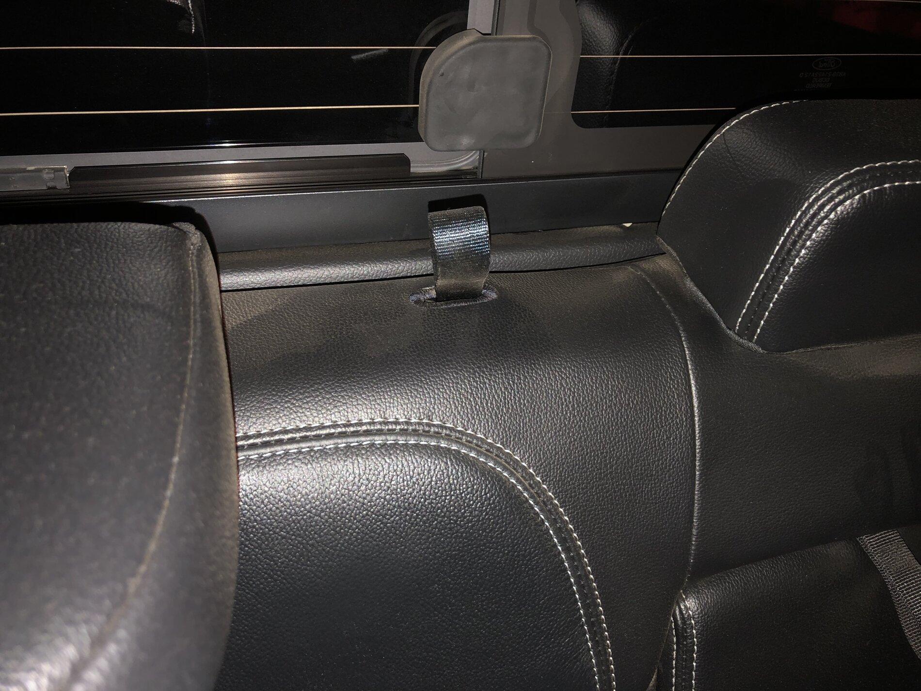

My back seat clunks, very irritating while wheelin' I can't get it to latch shut, didn't know there is a latch. I can't find it yet. I assumed that's the way it should be so I stuck a movers blanket behind it. Problem solved.
The latch (black loop) should be on top between the rear passengers and middle headrest.

Is the rear seat back (crew cab) latched securely?

Is the rear seatback locked back? Providing its a super crew
