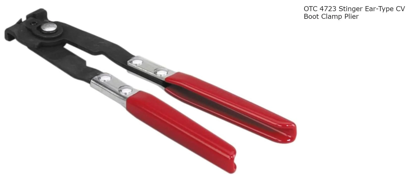

2. If I purchase that boot kit, do I need the special service tool to crimp the dogears on the clamp or is there another way to accomplish that?

2. I cannot speak to the clamping of the boot. I resort to tangential screw clamps on these cases (some folks call these hose clamps.)

I agree and I hope that you don't have to replace the boot at this early stage. I purchased the entire kit, but used the two ear clamps only.
