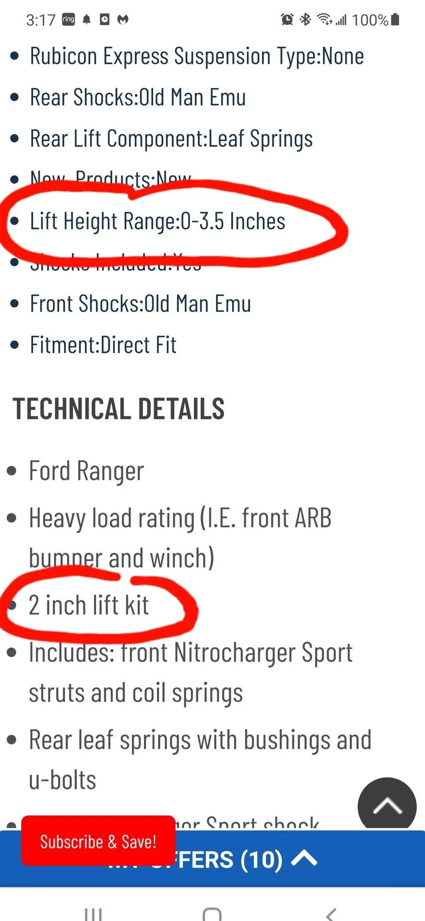

I know this thread is a bit older but looking at the old man EMU technical data, see attached. It say 2 inch lift kit but the lift height says 0 - 3.5 inch, can this kit actually will get you to 3.5 inch height?

From what I understand the coils are 0-3.5” but the leafs are static 2” at full lift on the coils you would probably be level instead of raked. You’ll also need some upper control arms if you expect to be in alignment and not wreck tires weekly.

Where you got this information I can tell you is incorrect sir. The front is lifted by 2.4 and the rear by 1.6.

Pretty sure the OME kit is not adjustable and that this...
is correct.

So the ad is incorrect? I know they do offer a set of adjustable coil overs that go 0-3.5. I have the fox kit and it’s 0-3” but factory it’s set at 2”.

The adjustment for the OME BP-51 is primarily compression and rebound. The preload adjustment is only for load carrying according to ARB

I got it from their website, I was just wondering if this a marketing gimmic to confuse people.

From what website? I can guarantee you it did not come from ARB's website
