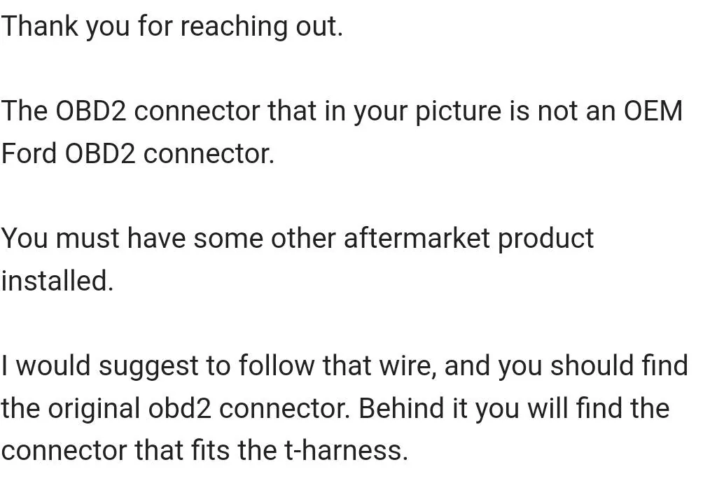

Tech support just replied and said this. Which is really weird.

It should be very obvious if the OEM connecter were tucked up there. I know it's a tight spot but shine a flashlight up there and you should be able to see it. If not the wires should be tied together (not factory) and untie them and see. Hopefully this is all it is and easy to fix.

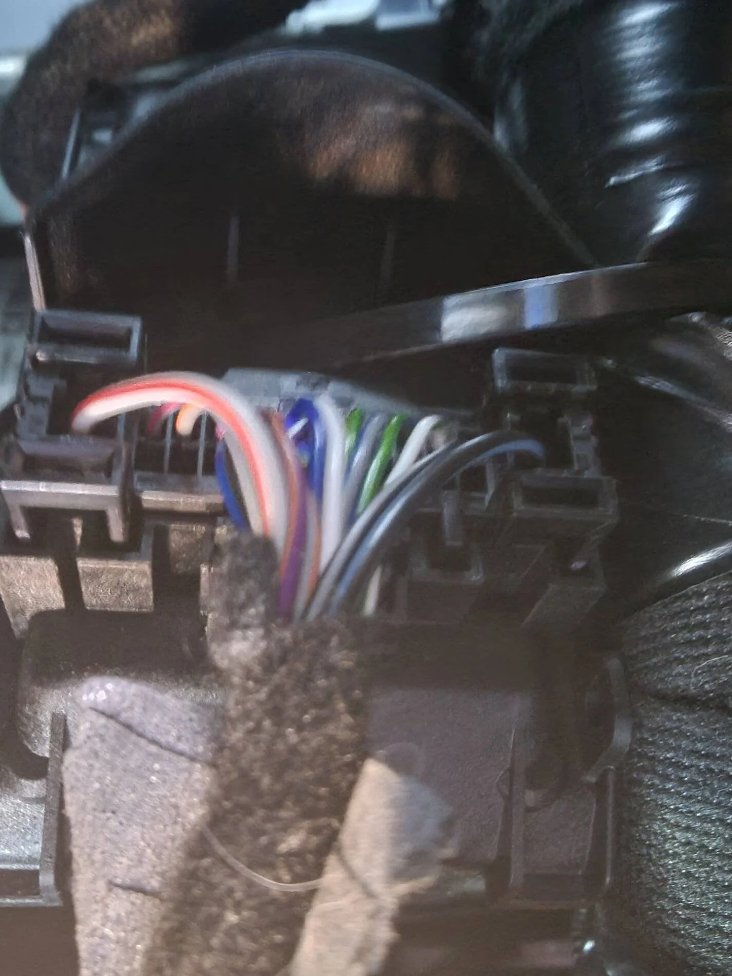

I took a picture does this look like what I need to disconnect?

Is that on the other end of the aftermarket ODB port? If so yes you should be able to disconnect it there then plug in your new harness.
Yes. Will do it tomorrow when I can see better

That was similar to the ODB power cable I was looking at for my dash cam. You unhooked the OEM one, connected it to the aftermarket one then plugged the aftermarket one back into the original spot. Having a tune and occasionally changing them I was afraid it might not work with my tunes ODB and would rather have the stock one sticking out. Hopefully this works out for you tomorrow. ?

It worked. It was tough getting the cable off. I had to get my neighbor to help. What kind of tune do you use? Might be in my future buy list.
