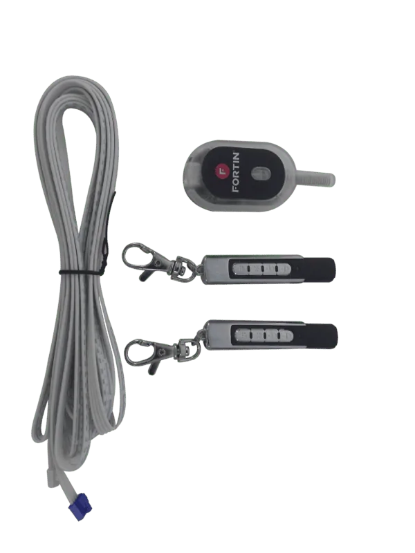

The app is slow for me too, so I added a Start-X to mine:
https://remotestartx.com/2021-ford-ranger-push-to-start-remote-starter/
$100 at Amazon: https://www.amazon.com/dp/B07F422Y98
My "install": https://www.ranger5g.com/forum/threads/what-did-you-do-to-your-ranger-today.3511/post-498818
It was very easy to install and has worked great for almost a year and a half.
BUT .... the range isn't very far, maybe 200 feet at the max and, for whatever reason, my unlock on the key fob doesn't work from as far as the lock does. That seems really odd to me.
But I use that Start-X pretty much daily. I'll use it through the bedroom window to start the Ranger (maybe 30 feet away) and then at the grocery store from 150 feet away. They make some form of extender for it, one that is like an antenna and one that uses an app (which seems silly, imo). I did a quick search and didn't see those extenders right away. I'll edit this if I find them ...|
Update: Extender for up to 1,000 feet but it means an additional fob: https://remotestartx.com/rfkh1/
Update #2: A confusing link with the remote phone app but then some diff RF ones too: https://remotestartx.com/product-category/rf-kit/
