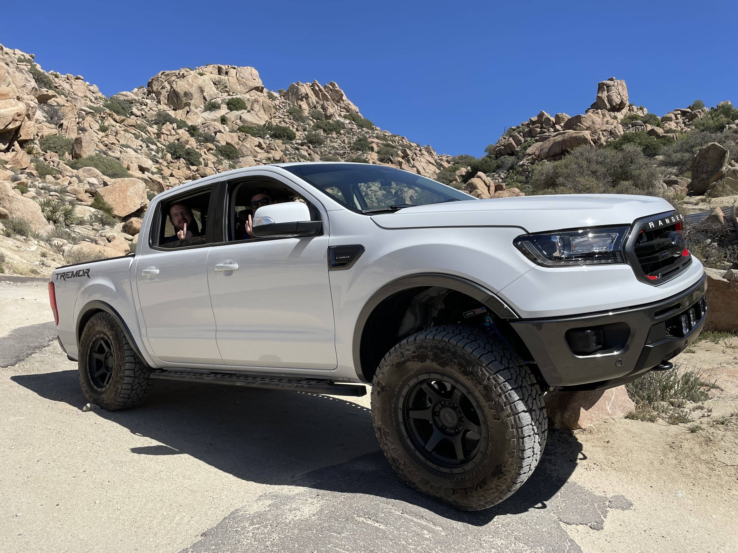

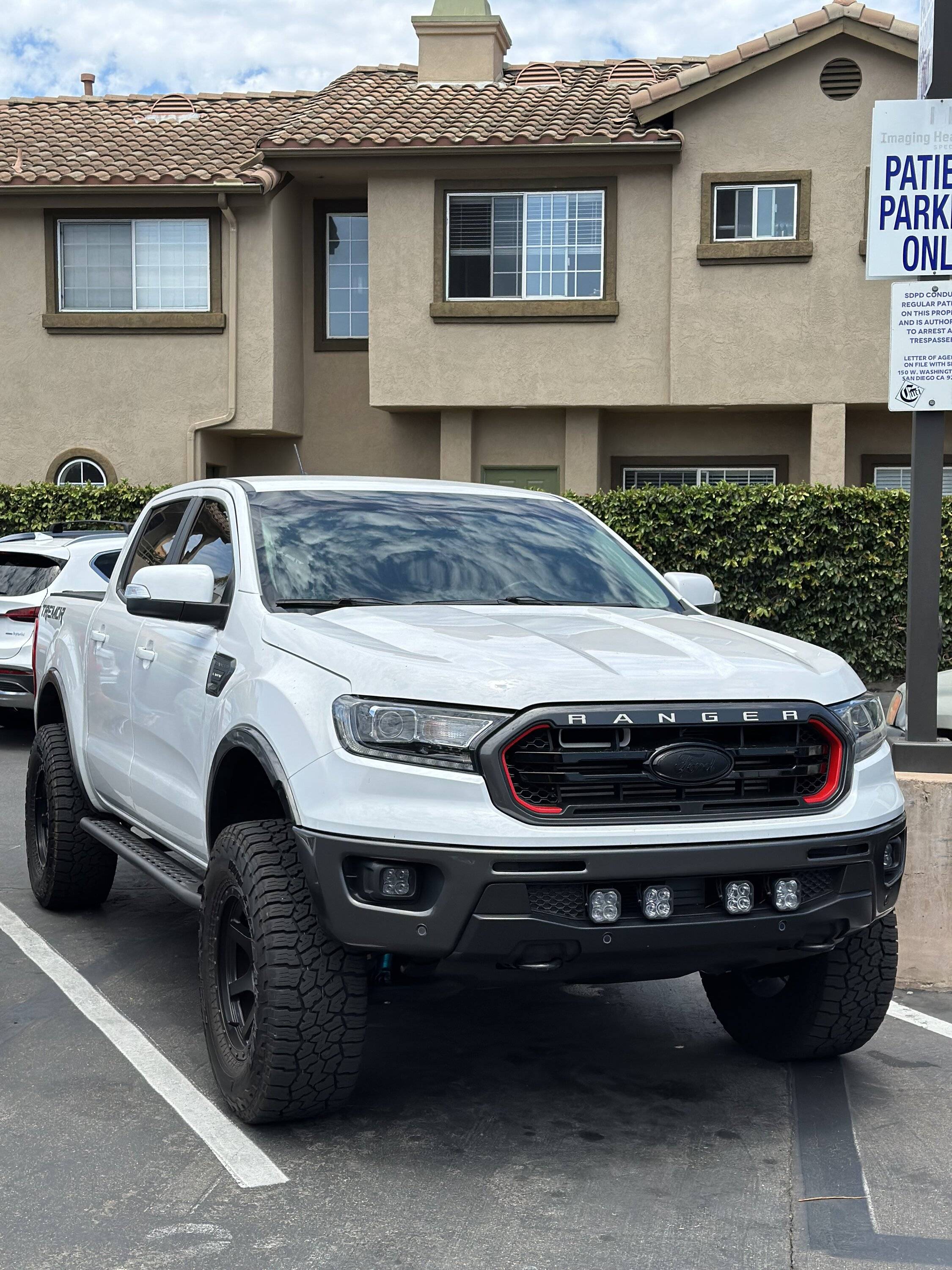

My Ranger has a S&B intake, TS BOV and a custom cat back dump exhaust. Besides that and the tune the rest of the truck is stock as far as performance mods. I also have about $10,000 in suspension, full APG midrunner kit, king shocks, uppers, tie rods, deavers and 33” falken Wildpeaks. Truck is very fast especially with the suspension and 33”s to be considered.

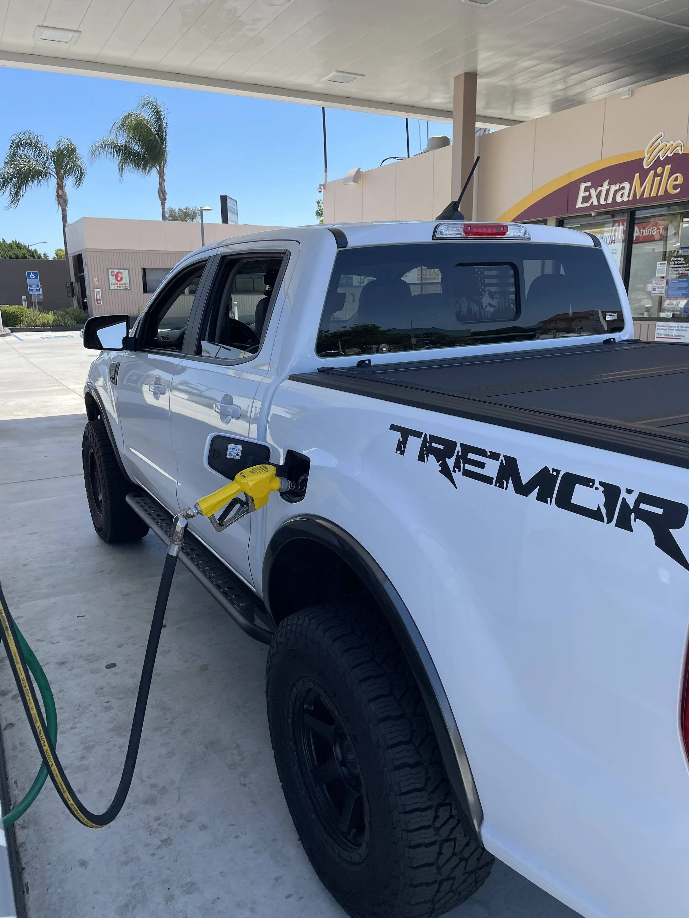

Yes, e50 is about 50/50 mix, e30 is about 4 gallons of e85 to 14 gallons of 91. Unfortunately for us we don’t get 93 here in San Diego which is a bummer but 91 still mixes fine.
As for not shipping to ca I simply had them send it to a friend of mine in Las Vegas and he mailed it to me.
Also yes, with any tune you need to get a tuner, something like an HPtuner works great for a lot of these guy making tunes for our trucks because they just email you a tune, you download it onto your computer and install it in the truck with the HPtuner. It’s quite simple and there’s a lot of very good videos on how to do it.
With our smog laws in CA new trucks don’t have to be smogged for 10 years so I was completely fine with tuning my truck. The transmissions we have are very reliable and handle power well. There’s some guys running 5g rangers with bigger turbos and upgraded fuel injectors on full e85 and putting down ridiculous power numbers on stock internals and stock trans like 550 tq and 470whp. That’s overkill for me. I’m sitting right around 440tq and 360whp and I’m plenty happy.

Sounds awesome! Thanks for all the great info! Any pics out there of your truck/build?

To be honest mileage is atrocious. E85 burns hotter and faster, so while it’s cheaper to use, it doesn’t get you far. I average right around 10-12 in the city (but to be fair I’m almost always gassing it, it’s hard not to when it’s so much fun) and 18 on longer trips if I’m driving about 70mph.
