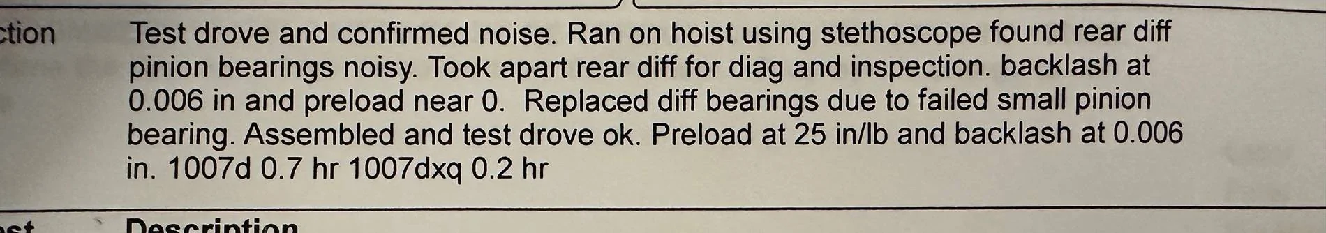

A few weeks ago, I noticed a couple odd things with my 2021 Lariat Tremor. Most notably was the moan/groan when I would go in reverse. I thought it was the brakes. Then last week on a warm calm day, driving with the windows down, I hear a metal grinding sound - not bad and almost like at wear tabs just quieter.
in this time, I also noticed the bump after coming to a stop occasionally. Now I’m thinking it could be the driveshaft. Although that doesn’t seem to affect the Tremor very much.
A quick visual inspection of the brakes shows that’s not likely the cause. We have a long road trip planned for next week. I need professional help. The truck went into the dealership this morning. I just got a message that the issues I’m reporting are due to “The rear diff. The bearings inside have failed and need to be replaced. We have ordered the part.” I’m covered under the drivetrain warranty. I’ll post the details once I know what was done.

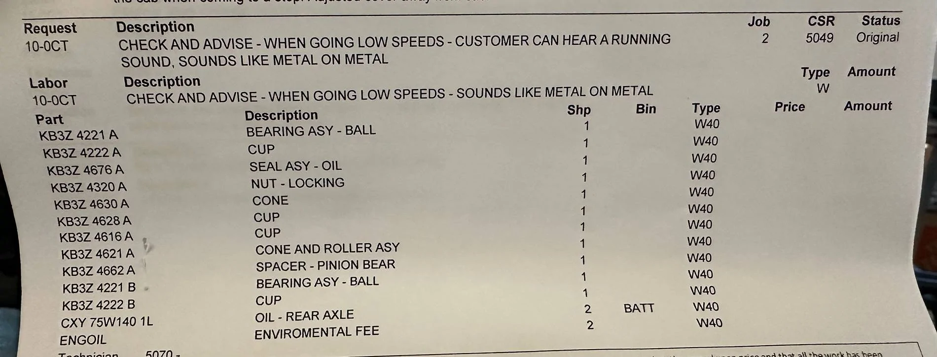

I just texted the advisor with a question regarding concerns with fluid contamination and what this repair will entail. He did confirm it is a full overhaul of the diff. The gear set is okay though.

What else is in the rear diff besides the gear set? We talking hardware that holds tension on the ring and pinion and what not that's being replaced?
If that went bad how's the gear set still okay? ?

Debris from a bearing failure could get into other bearings. The gear set is harder than any part of the bearing material. The advisor said they overhaul the diff. I’m expecting new bearings and seals, flush the diff and clean the gear set. Will see what the paperwork states.

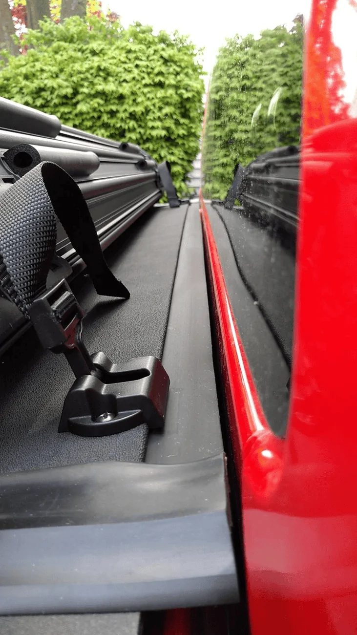

Picked up the truck today. They tacked on a charge to inspect for the clunk when coming to a stop. This lead them to adjust my tonneau cover. Charged $122.00 for this. I disputed this. The service advisor said his tech of 25 years knows what he is doing and he is certain the rubber flap at the front of my Bak Revolver X4S was contacting the cab and that was the noise I heard and felt. So, after some mild debate, he agreed to remove this charge.
I ran several errands. The rest of the noises are gone. Glad to have my own vehicle back.

Great tip on the Bak Revolver. On my scab, that frigging front of the tonneau is about a quarter of an inch from the cab. Sure seems like they could have made it with one less slat to make it fit more nicely, especially for its price.
Glad your noise is gone, it can be really disheartening ....
