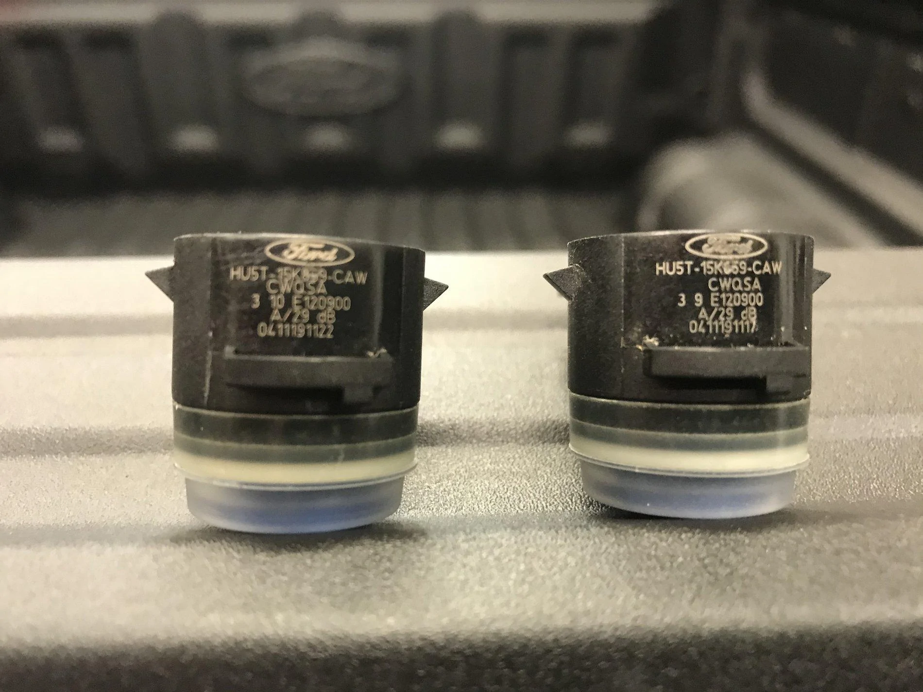

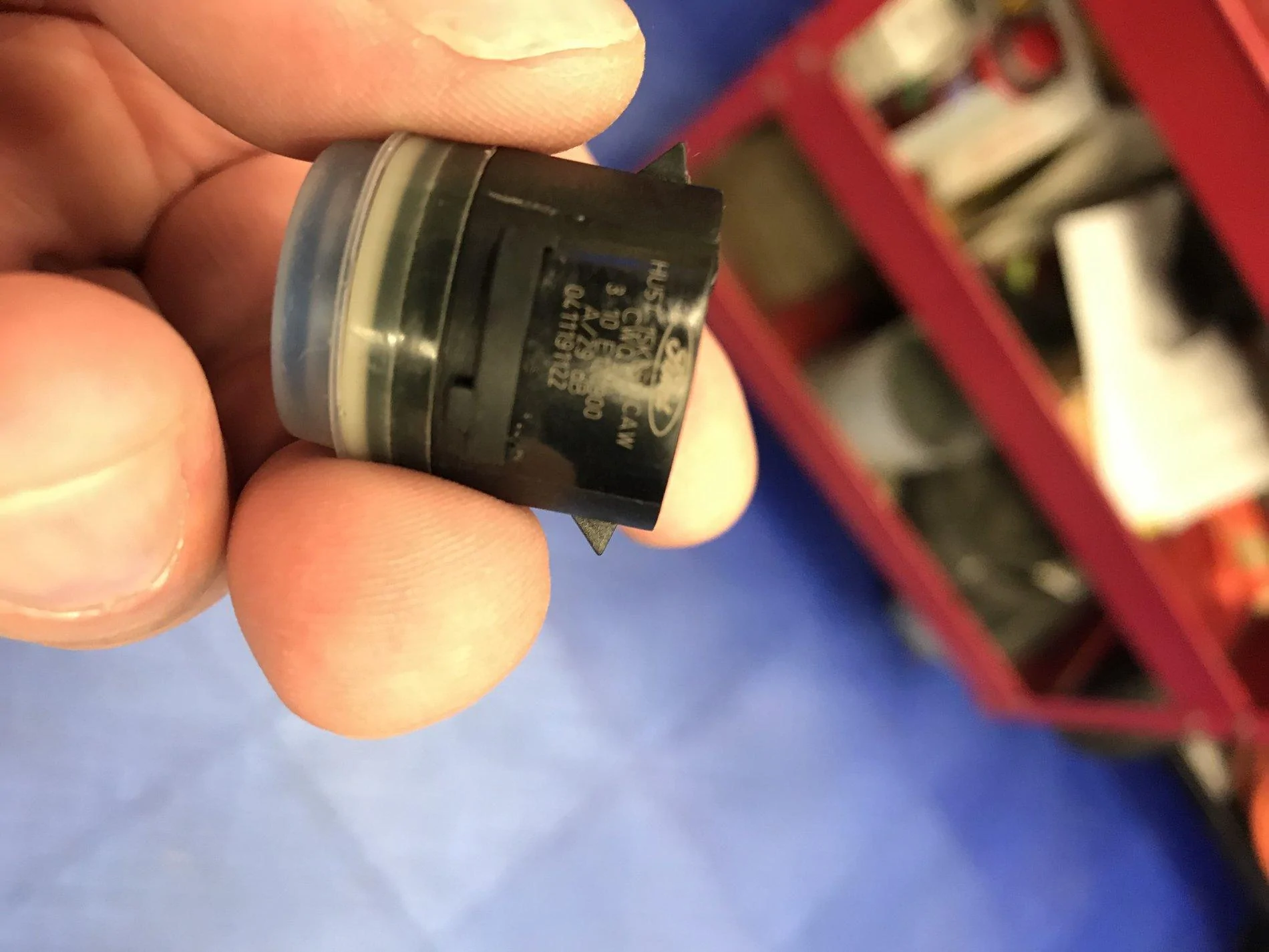

There is a seal so it could be. I had similar issue (far left rear) but it wasn’t weather. I took it out and cleaned a few times. Still did it intermittently usually when another sensor was close like even the front. Finally got it to go away when it took both far left and right (painted ones) and swapped. Hasn’t come back since for weeks.
