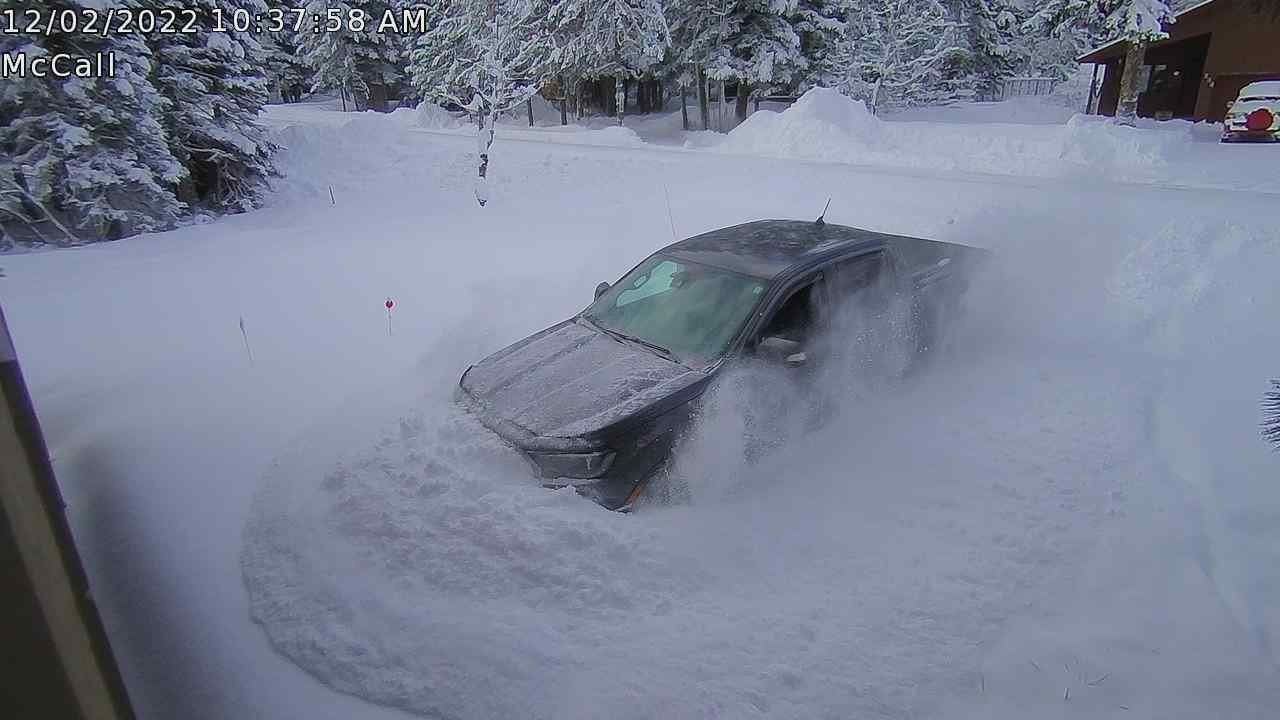

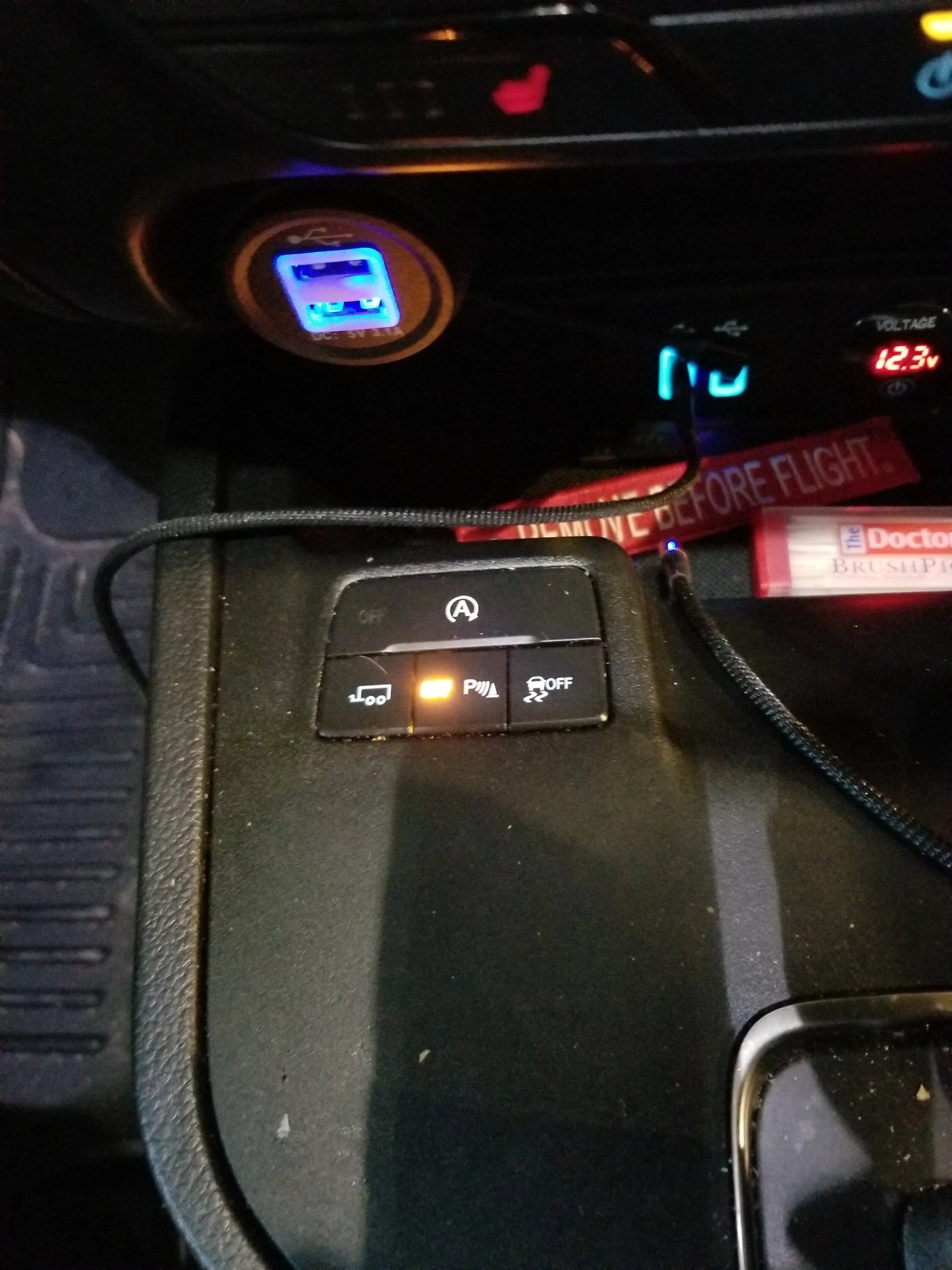

Push the parking sensor button to turn them off when they are not working properly due to weather.
Snow was jambed all the way to the radiator and in every open crevice following this snow push picture. Wiped off all the sensors and they returned to normal.

Yes I use that button every time I back into the garage. Once I know I will clear the door I shut it off because it mutes the audio on Sirius ?
